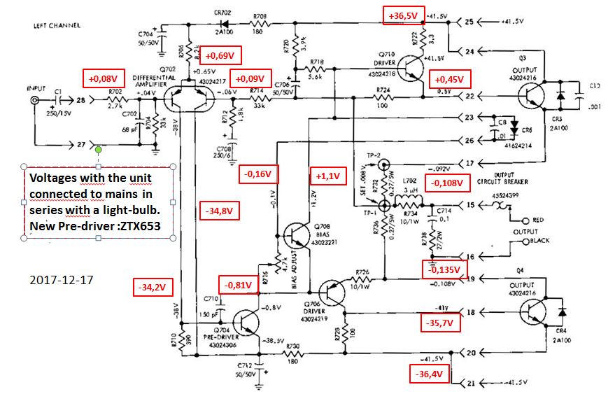

Hi and once again, thanks for this exclusive remote one-on-one help!
Now to the 10000$-question: What transistor should I go for? This is a very common question on the boards, I´m sure you know and there is a lot of different advice out there.
My first test was to replace the pre-driver (is that the VAS?) with a MJE15034G and it didn't work out. A lot of strange voltages in the wrong places:
VAS Collector: -39V
Bias Emitter +34,8V Base +39V Collector +40V
Diff amp Bases +7,2V +0,3V Emitters +0,87V
Driver Q706 Base +34,8V Emitter +33,6V Collector -35,6V
Driver Q710 Base +34,7V Emitter +39V Collector +35,7V
Output Q3 Emitter +39V
Output Q4 collector +39V

I would do the test with the other channel, since we did get some strange readings.
Everyone calls it a VAS these days, but yes what is called the pre-driver on that schematic.
The repair manual calls that out as an RCA 40408 which makes sense since the reference
design also uses that.
I have an RCA Transistor manual and the 40408 is a 90V, .7A, 1W, 100 MHz, 40-200(max) hfe.
It is a metal can device and so will take more power than a similar modern plastic type. I would
use a KSC2690 or KSC2690A, here are the specs:
120V, 1.5A, 1.2W, 155 MHz, 35-105(typ), I would put a screw through the mount hole
with a copper, aluminum or steel washer as a heatsink but just leave it in the air not
through the board.
These parts are hfe graded with R, O, Y designations, any will work fine. See the data
sheet for info:
http://www.mouser.com/ds/2/149/KSC2690A-889454.pdf
I have 60 of these and can send you some.
The Diodes Inc. ZTX653 in a plastic TO92 case is also interesting and probably one of the
best matches - I'd use a metal tab heatsink against the flat side of the case.
100V, 175 MHz, 1W, 2A, 100 hfe
Other options are:
KSC2383 in TO92L
2SC5171 in TO-220 good amount of metal no heat sink needed.
I ran through several parametric transistor selectors and there are not a lot to
choose from. Many options have gone to surface mount.
MJE15034G is a much higher current/power device and is just not right there.

New pre-driver in place and new measurements:
http://www.diyaudio.com/forums/attachment.php?attachmentid=651713&stc=1&d=1513545733
Bias was 8mV as desired but the offset on the output was -345 mv, a bit high?
One voltage seems a bit strange and that is one of the bases on the diff-amp. Could that part be bad also?
Is it a good idea to replace the diff-amp with two ZTX653´s?
regards//lasse
regards//lasse
