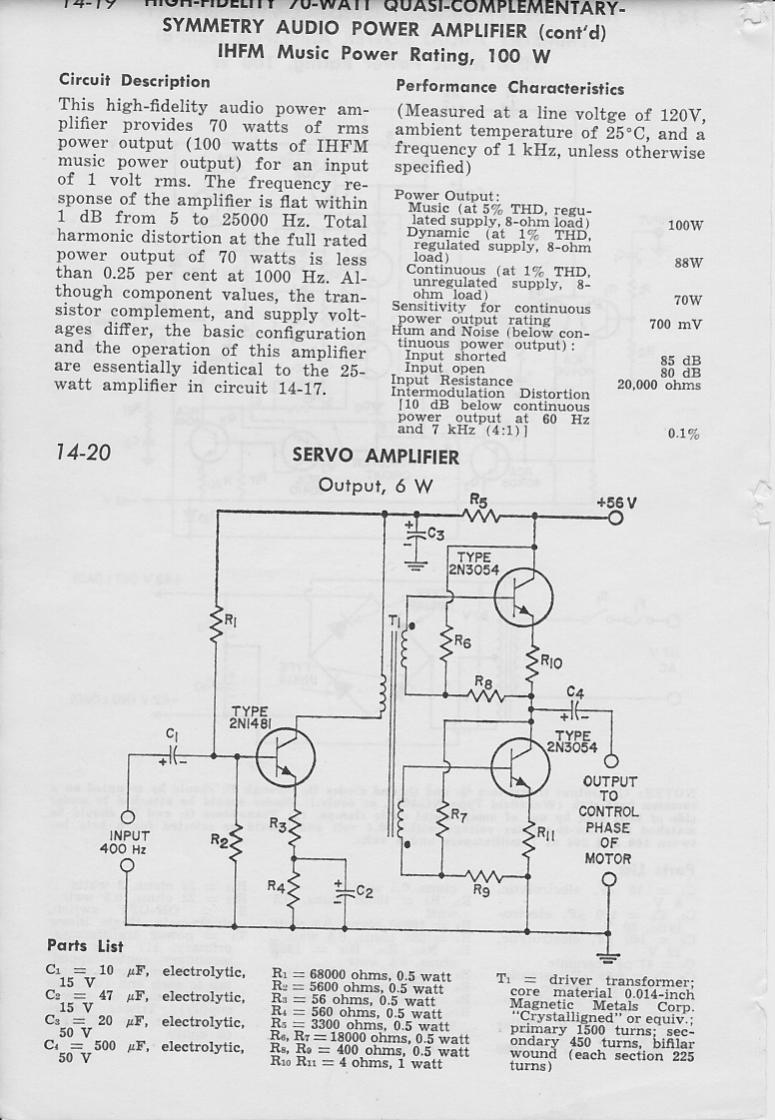

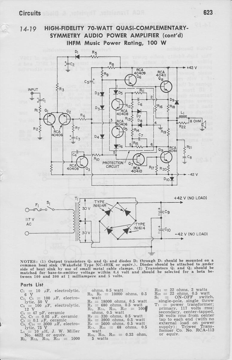

I don't really know the history that well. I have in front of me here the 1969
RCA "Transistor Thyristor & Diode Manual" from the technical Series SC-14.
It has a 70W reference design that is *very* similar to the HK Citation 12.
HK substituted most of the transistors and increased several of the caps in
the signal path to lower the LF cutoff. Both used output transistors in the
2N3055 family in that they were of single diffused planar construction as it
was called but neither used 2N3055 outputs - the RCA design used 40411,
and the HK used 40636 types.

Would you be able to e-mail me a copy of the schematic and component list for the 70W reference design from your 1969 RCA Transistor Thyristor & Diode Manual?
My e-mail address is "agedone_2004@yahoo.com"
I have been trying to get this schematic for a long time without success; thank you for any assistance you may be able to give
Mr Basel
Got it.....Thank you again

In response to post #21 - has anyone got an RCA advert from ~1964-1965?
The 2N3055 was advertised along with the 2N3054 and 2N3053 originally as a range of NPN power transistors. The ad ran for a few weeks in the electronics press.
Regarding transistor subs - the 40636 seems to be a 95V (Vcer) selected 2N3055, the 2N3055 can be used as a 40363 directly. The 40411 seems to be a type of transistor from the 2N3772 family, with 800kHz typical ft -but a poor 200 kHz min, probably, but that is not given in the data sheets.
I've indicated before that the latest (epi) 2N3055 transistors from e.g. ON semi or ST are very likely to be able to be used at over 80V and maybe up to 100V, but you should check, you cannot take this for granted. THe reason is that epi transistors don't appear to have the same Vcbo:Vceo differences that the original diffused 2N3055 had and the manufacturers MAY have to build a 100V Vceo epi transistor just to ensure that Vcbo is met, but they won't change the data sheet which says 60V Vceo.
I've certainly had off-the shelf ST and ON semi parts which work to over 80V Vceo and can be used in at least a 60W amp and MAY give 70W.
BD139-Bd140 can be used instead of 40409/40410. I'd recommend MJ15003/4 for a fully comp pair for 70W and if you need higher voltage drivers you should try the 2SC4793/2SA1837 which are high speed but can dissipate almost 10W at 100V, while the BD139/BD140 are working in the Vcer range at 100V, but this is how RCA specified their drivers. To use a BD139 as a VAS with 90V rail to rail probably needs to have at least a low impedance base resistor and probably a small emitter resistor to assist.
