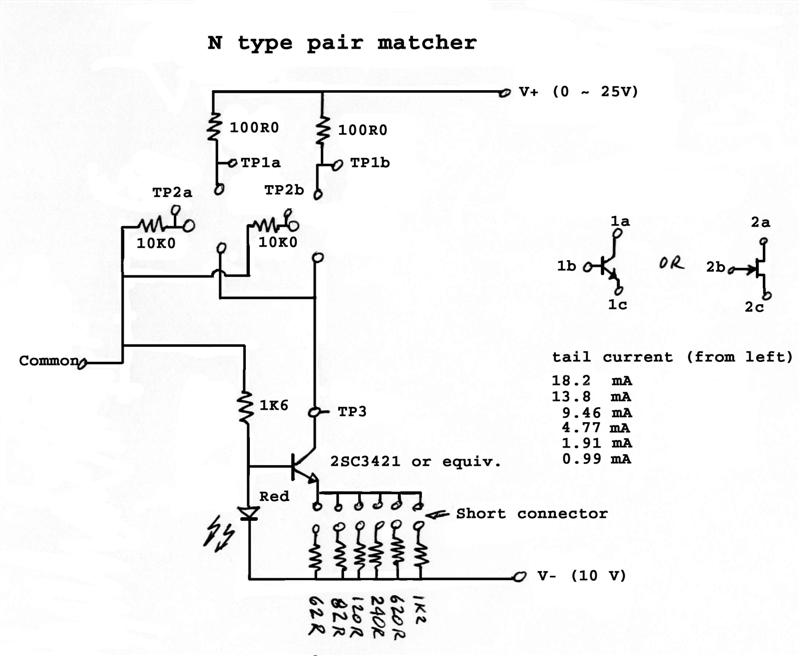

I built a jig especially for testing matched pairs for transistors and fets. It is reproduced below and is pretty easy to build and use. What you want to do with it is take your transistors with the measured beta and stick the closest ones together. Rotate some others through and use the ones that have the closest balance. You need to leave the parts in there for about 3 ~ 5 minutes. I have some foam that I place over the two transistors. Make the sockets so that you can place the two cases in contact with each other. I can take a picture of it to show you what I mean.
I get very, very good matches with this thing.

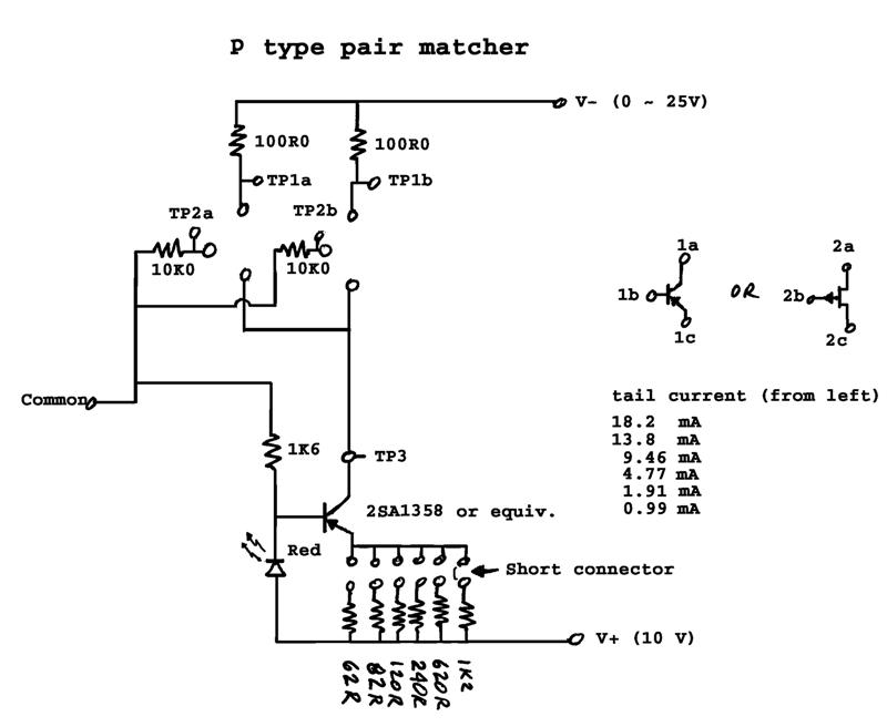

Here is the PNP matcher.
I built them both on the same perf board. One day I'll build a proper PCB for it, and a case. I use it a lot.
-Chris
Edit:
I normally use a supply voltage of 10 VDC from emitter to collector, or TP1 to TP3. I check the balance by measuring from TP1b to TP1b. I can check the base current by measuring from TP2 to common and dividing by the base resistance. Collector current is found by measuring from TP1 to V+ and dividing by the collector resistance. If you divide the collector current by the base current, you should get a number that is close to the beta at that current. To be exact, you would have to measure the divide the emitter current by the base current.
The tail current is set by shorting the pins with the resistors to negative supply. You can add them up as well by jumping more than one pair of pins. I used double row 0.1" connectors and the shorting pins from old dead computer boards.
Now, if you install only one transistor, you can measure the beta more exactly and easily for different currents. Note that you would have to measure each current setting exactly for this to be accurate.
If you build one of these, use at least 1% resistors for the collector and base resistors. Then match those as close as you can for each pair. After doing that, you now have exact values for your calculations. That is what I did. You will be rewarded by having a useful jig that will provide transistor matches that are scary close. The best part is that this jig tests the parts in the configuration they will be used in.
-Chris

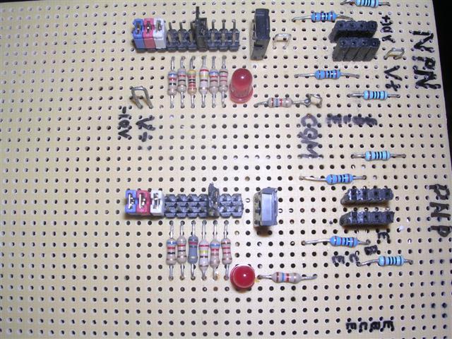

This is how it appears now.
I built this quickly as I was having trouble with simply measuring beta and sticking the transistors together. I did realize that temperature effects where one of my big problems. You have to remember that the absolute value of beta is much less important than how close they are to each other. You can also vary the tail current to check how they track each other. This jig also compensates automatically for the Vbe crowd's concerns.
One other thing I should point out. There are four lead terminals for each transistor test position. They are arranged emitter - base - collector - emitter so that you can measure Japanese parts, Pro Electron parts and the North American parts. The terminals themselves are from strips that you simply disconnect as many as you need at once. Again, they are 0.1" spacing. I make many adapters and sockets using these things.
