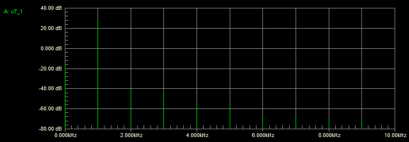

I im using simple Simulation Program, and know that is this old thread but if someone could help me if i correctly calulated THD using picture od THD taken from CircuitMaker..and also if there is possible to do in CircuitMaker macro or Math function of simulated THD diagram to be calulated automatically using Math in circuit? I see that i have Math function in CircuitMaker Fouirer Analysis but i don't know how to take THD points so that i can then calulate using above formula that Steven have provided....
Here is calulation using Steven formula from diagram attached here...input is 250mVpp and frequency is 1kHz, gain of simulated preamplifier is 14,85dB.
1k 2k 3k 4k 5k 6k 7k 8k 9k 10k
2.80 -128.10 -131.55 -133.80 -135.26 -146.84 -147.64 -137.77 -138.26 -138.65
0 -130,9 -134,35 -136,60 -138,06 -149,64 -150,44 -140,57 -141,06 -141,45
2,851e-7 1,916e-7 1,479e-7 1,250e-7 3,296e-8 3,006e-8 9,364e-8 8,851e-8 8,462e-8
THD = SQRT((2,851e-7)^2 + 1,916e-7)^2 + etc...)/1
THD = 0,00000000000008128201
0,00000000000003671056
0,00000000000002187441
0,000000000000015625
0,0000000000000010863616
0,0000000000000009036036
0,0000000000000087684496
0,0000000000000078340201
0,0000000000000071605444
SQRT(0,0000000000001812449593)/1 = 4,2572e-7 = 0,000042572%
So from diagram THD @ 250mVpp @ 1kHz is 0,000042572%? To me this is too low..i think it needs to be like 0,042572%

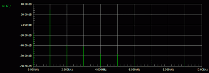

I Write vbscript that reads CircuitMaker Fourier Analysis.txt file and calculate THD using Steven formula...
I im also attaching output from simulated preamplifier from CircuitMaker so that you can read values and check if all is well calculated...and i im also including vbscript that needs to be placed in Folder and this Folder must have subfolder named Projects...put in that subfolder this Fourier Analysis.txt and click on THD.vbscript from root of folder...and you will get message about calculated THD that is for this example:
0,0000004486%
So if someone could verify if this is correct...thanks
