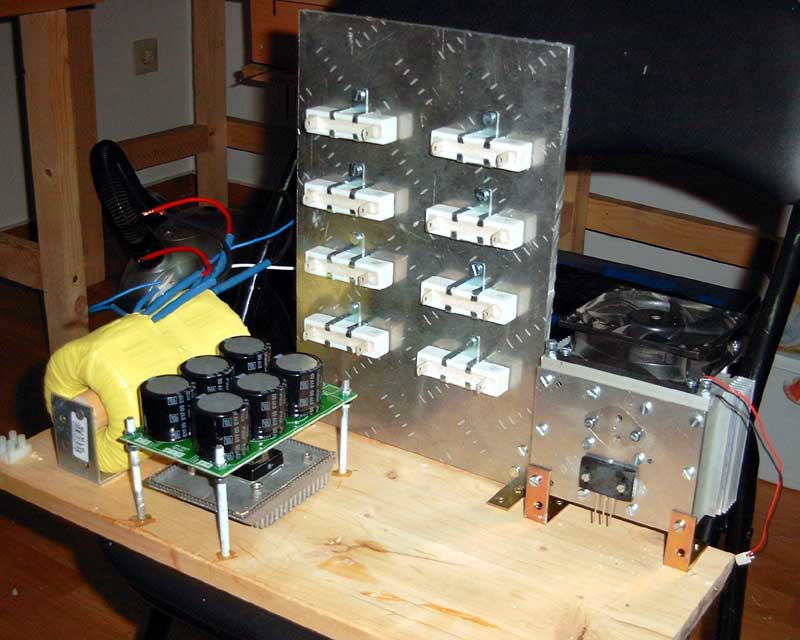

Hi guy´s,
has anyone a simple circuit with there i can test high power transistors as 2SC2922 and 2SA 1216.
For example a small circuit with LM317 or a L200 as power supply in that i can build in the 2922 or/and 1216 as current driver to bring them to there SOA (so 9 Ampere current) ?
Or a other simple Circuit with there i can test this Transistor up to the SOA border ?
greetings
Dirk
greetings
Dirk
complete DC without other Signals.
The transistor has on Emitter a resistor with 8,4 or 2 ohm with 100 to 200 watt. The transistor are passiv and activ cooled. See pic.
I have a power supply with 2*34 Volt with 9.5 Ampere and i will bring the Transistor near the SAO and will see that hold his data what stand in the datasheet.
Dirk
Dirk

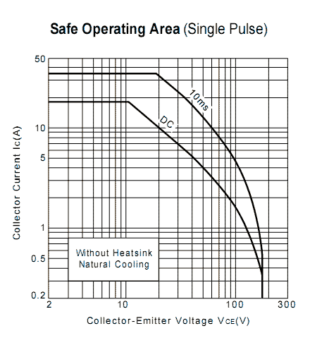

@cliff
Why is then in the datasheet from Sanken for SOA one line for DC and one for Pulse ?

Yes, I lost 30 years worth of data books and notes in a fire
Confusing isn't it, small-boy ??
That curve says "natural cooling without heatsink", but the first break-point is 20A Ic at 10v VCE.
That is 200W.
Even with a fan cooled massive heatsink that is not real!
What do you want to TEST for SOA? If it doesn't meet SOA it dies. Period. No way back.
It is a design-aid curve.

Those 200W are *real*. This transistor comes in the unusual MT-200 package and is rated for 200W continuous at Tcase=25ºC, 160W at 50ºC, 120W at 75ºC, 80W at 100ºC and 40W at 125ºC.
DC SOA may be tested as long as derating due to increased temperature is taken into account. Peltier cells may come handy to keep the case at 25ºC.
note that Eva's post shows the maximum powers, below the second breakdown voltage, for case temperatures @ or above 25degC.
For Tc=100degC the maximum continuous power is just 80W (2Adc @ 40Vce). This is the temperature de-rated SOA limit for a 200W, 150degC device.
Try running the device at this temperature and power dissipation and see if it survives. Remeasure hFE at various currents to see if there is any deterioration.
Now run the device a bit over 100degC at the same power dissipation (2A @ 40Vce) and see how long it lasts. Tc=110degC may last a few hours. Tc=120degC may last just a few minutes.
The results will be instructive to us all.

Test setup for transistors:
Current range: 0.2 .. 20 Amps
Voltage range: 10 .. 350 Volts
Pulse width: 10 microseconds .. 2 seconds
Very impressive...
