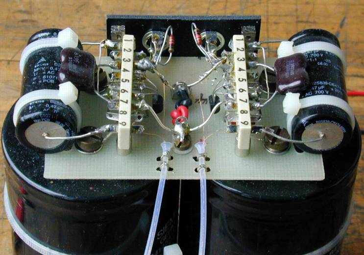

fully agreed, just, :) did you ever have a buzz or something? me not and i m glad, the tight way i do p2p does not aloww for components to be moved. Once rebuild a SE-SS MC prepre in p2p which was on a PCB before. Vast improvement. Thing on the pix is the MC prepre.
