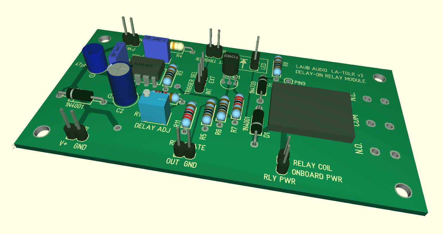

I can only speak for Target3001, but when I am creating the circuit schematic I am not using a "generic" symbol. Instead I use the built-in part database to select e.g. a particular capacitor. This includes of course the capacitance and voltage rating, but also the lead spacing and physical dimensions too. I do this over and over for each part, carefully selecting the one I want to use or one that is very similar.
Then when I do the layout, an outline of the part on the board as well as the thru-holes that are needed to accommodate the leads are automatically made available in the layout view. What is left to do it make the connections between parts.
I like Target3001 because it can generate a 3D model view of the PCB with the parts on it. This helps me to figure out if it looks right, could use some adjustment to improve part spacing, etc. I have attached an example of this for a PCB that I recently designed in Target. You can rotate the model in free space to look at both sides using the mouse, and populate and de-populate parts to reveal the PCB underneath them. It's a really cool feature.
It's possible to create a BOM right from Target and place an order for all parts in your project, but unfortunately (for me) the software links to resellers that I do not use, most of which are in Europe. But I like the software so much I don't want to change to somethign else.
I think it is also possible to do circuit simulation in Target, although I have never used that feature. It's quite a powerful and sophisticated package but even a design noob like myself was able to learn it.
When I was getting started, I found online some 'PCB design guideline' pdf files that were helpful for me to learn about track width, track spacing, and so on. At some point you have to jump in and just do it, and you will gain experience and learn as you go. If you are only going to do one PCB, I would suggest that you just ask someone to design it for you, but if you think that you will be doing audio stuff and will design lots of your own PCBs then there is no time like the present to learn the useful skill of PCB design.
