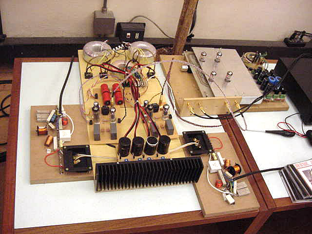

Hi guys, at least our Circlotron is running.
It is a full balanced hybrid circuit made with a single ECC99 double triode tube and a couple of BUZ900 power mosfet. The PSU is a single rail 40V for each MOS and the power output is around 70W...
The final design was demonstrated at aa italian DIY contest near Modena.
In the pic you can see the two double winding toroidal trafo for each channel and the small toroid for the tube PSU, the driver tube stage and the MOS circuit with the heatsink.
The sound is great!
The preamplifier is also an exclusive design: a Supertotem all tube circuit made wit four 12AU7.
Now wa are working around a definitive PCB before sharing all the project on our site.
ciao
Filippo
www.audiofanatic.it

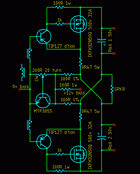

Hi everybody. This is how the project is progressing. As you can see I have made the output into a Sziklai pair on the suggestion of AKSA, (thanks heaps, mate:) ). This makes the output LOTS more linear. As an example, before I had to use ~200mA quiescent current to eliminate crossover distortion, now I can do it with 75mA. Actually I am running 100mA right now and may return to 200 and see if it sounds and better.
The fets are now tricked into thinking they are P-channel devices and so the whole circuit is upside down. It looks a bit confusing at first, but take my word for it, the things works. To me it sounds just so smooth and clean. Even through that 3C90-cored input tranny!
Next thing to do is figure out some feedback from output to input because the output impedance is 0.47 ohms courtesy of the "source" resistors (that are connected to the drains).
I have not cranked the volume way up yet because of lack of drive voltage avaliable. I gotta make a preamp for it yet. Doesn't that symmetry of the schematic make your mouth water?;)
GP.

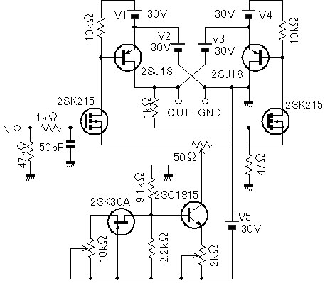

I am looking for a bias servo appropriate for CSPP/Circlotron power buffer.
For Totem pole output stages there exist a topology designed by William T Chater. By post #40 about
Only N-Channel MOSFETs (NMOS); better Audio from non complements by Audio Power?
you will find more informations.
About
Bias control for power amplifiers
is to find the circuit idea therefore.
Is it possible to perform a conversion of this topology suited for a Circlotron ?
