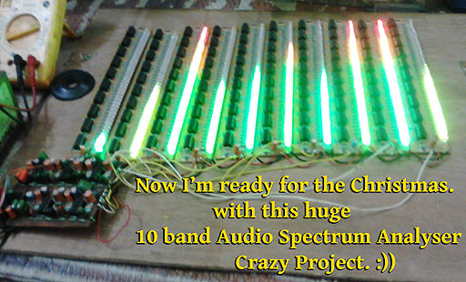

That's so unfortunate. It has a much bigger display. Some 80 Leds per channel I guess. The man has made a 10 channel display too. 10 channel is more than enough imho.
The man has provided PCB layouts in Eagle format. I opened that and was able to print the pdf. But It has some errors. So I am hesitant to follow his layout. I sent a message to the man but have not got any reply from him so far.
My plan was to use your filter and buffer board along with the display of that man for his displays are bigger ( obviously at the cost of more power, some 7.5 amp )
I will attempt to build a single VU meter display following the circuit of that man and report back to you about my success or failure.
If I fail I will just use your design completely.

Looks really good. Do you have a video ?
Regards Olaf
and final schematic.
Unfortunately I have no camera except my cell phone. I tried to shoot the video with the cell phone but the result is not satisfactory at all. The low frame rate of the cell phone recording is not reproducing the display properly.
I will request a friend who has a camera. If he can do it for me I will post the video and my mods here.
I used high brightness LEDs ( or what I got locally).
I used 820E resistors in series with the LEDs. In the original circuit 680E is used.
Also I found some un-routed sections in the filter board and fixed that.
Also I changed a biasing resistor from 8.2K to 33K. and 3.6M to 3.3M.
I will post everything soon. I'm still testing and fixing minor problems like improper soldering and broken tracks and level adjustment.
I am going to use the computer power supply with this since this circuit operates on 12 volts. So I will post the result too.
Just give me some time.

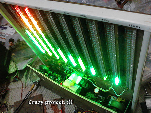

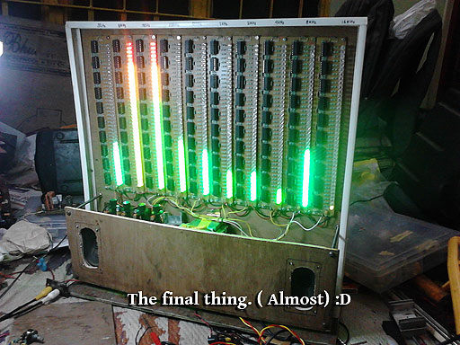

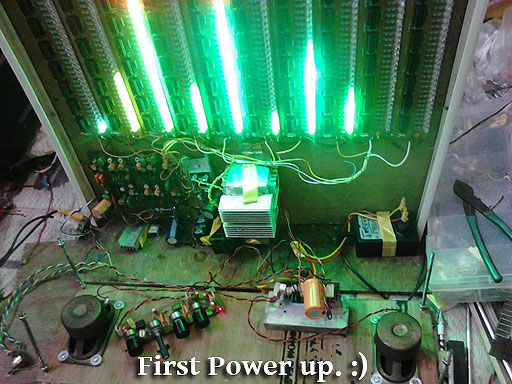

Thank you so much Olaf. Yes, the cell-phone camera messed up everything as I told you earlier.
I am also trying to integrate a Boom Box with Active 3 way Xover( my obsession, LOL) with this audio analyser.
I am in the process of making the Amps with 2 TDA2050 chips and 2 LM1875 chips and 2 TDA2030 chips.
I just finished making the PCBs at home today. Let's see how long it takes to complete the insane project.
I will post the final version of everything here in your thread. Hope you will forgive me for your thread-jacking.
Meanwhile kindly give me some advice/ ideas regarding the cabinet.

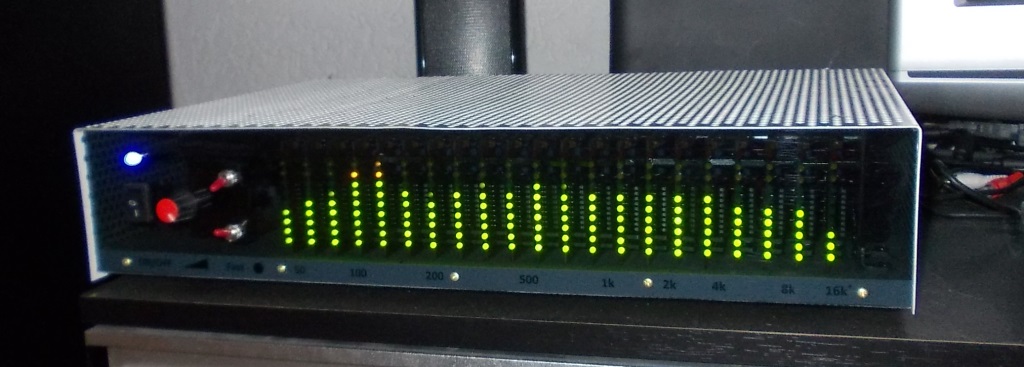

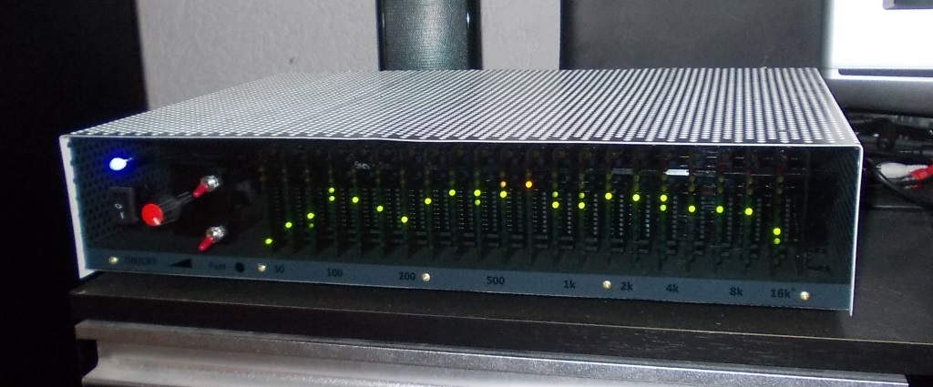

How did you make your enclosure?
Hi Som
there is no problem with the thread-jacking. One thing follows another, the theme is the same.
My enclosure has a front of gray plexiglass. In normal light it looks golden brown and opaque. The cover is made of aluminum, nothing special. The LEDs are in this way pleasantly dimmed so that it looks good in the living room. I will make photos next days.
regards Olaf
regards Olaf
Hi Som
regards Olaf

Meanwhile here are some photos of my on-going work. I added a mini boombox with this monster, lol.
http://www.diyaudio.com/forums/atta...-battery-powered-mini-boombox-final-thing.jpg
http://www.diyaudio.com/forums/atta...attery-powered-mini-boombox-crazy-project.jpg
http://www.diyaudio.com/forums/atta...attery-powered-mini-boombox-first-powerup.jpg
