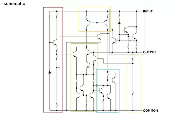

With your multimeter measuring output to ground of a LM7805 can you inform of the resistance you find please. And does that suggest anything, or raise any question to you, or is there no question you can think of.

I am just wondering how you use a multimeter to measure the 'resistance' of the output of a voltage regulator. I am also wondering what this has to do with audio.
Pretty easy I would of thought but ...
Place the Positive probe on the Out pin and the Negative probe on the Ground
pin, for a LM7805 what resistance do you measure ? Can that be answered
Yes/No
If your DMM is set to measure resistance and the regulator is powered, you will likely damage your DMM doing that. If the regulator is not powered, then you haven't measured anything meaningful.
Do you know how to measure the output impedance of an active device? (like measuring output Z of an amplifier.)

That schematic fails to show the resistance from Output to ground
Even in Texas instruments latest schematic, it is vague because one
resistor called R20 has no stated value. http://www.ti.com/lit/ds/symlink/lm340.pdf
Measuring will however find the needed value, and to help you all out
as your multimeters cannot be found ? ..it is 4.79k
However different brands of 7805 differ, even from the same manufacturer
ST, I measured over 300% difference.
So placing a 7805 in a LDR circuit with accompanying capacitance, could we say its really a constantly powered R/C shunt circuit between anode and cathode, and signal ground ?
And could we say the 7805 constantly must preference its own internal fixed resistance, as a load, over anything else.... such as a sensitive LDR ?
