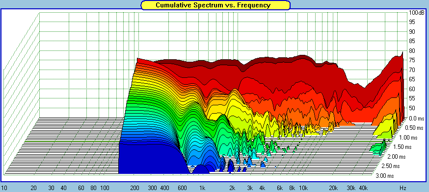

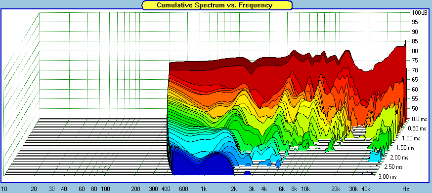

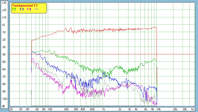

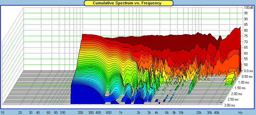

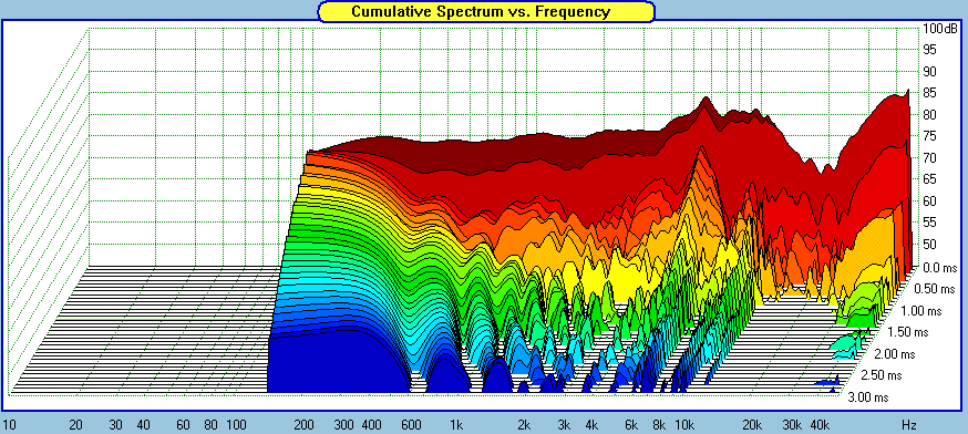

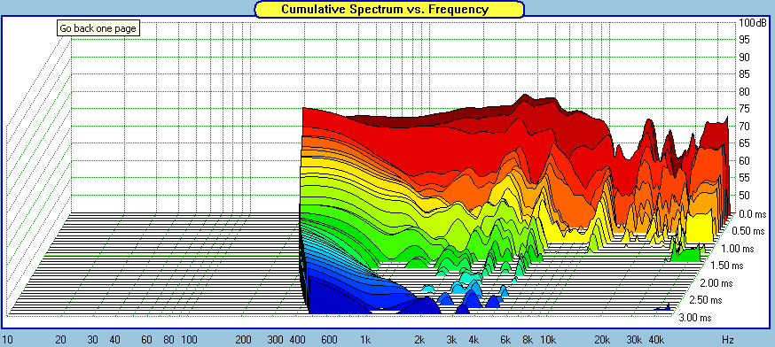

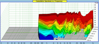

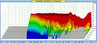

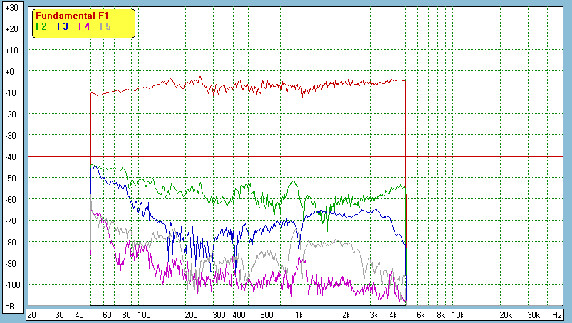

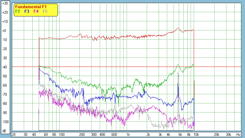

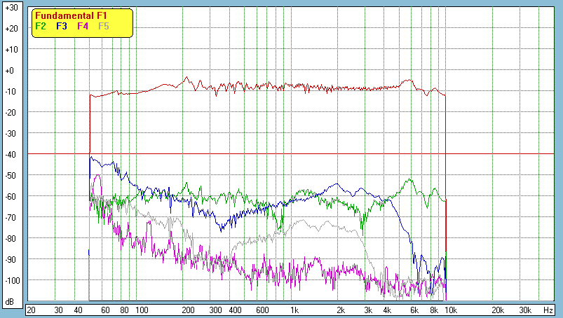

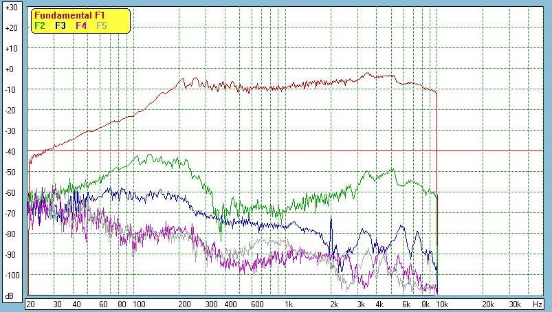

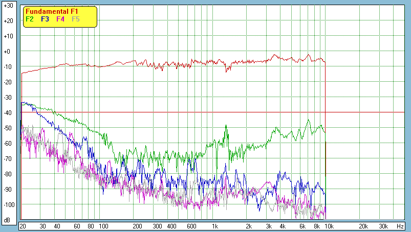

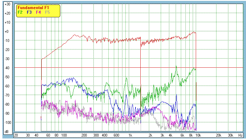

I don't know if this will be useful, but I'll give it a shot anyways. Warning - graphs to follow.
One of the things that really helped me to understand some of the measurement data was to have a standard by which to make comparisons. For that, lets look at 4 reference level drivers, the Satori MW165DC, the ScanSpeak 15W8530K00, the B&W kevlar FST midrange from their 803D and the BG Neo10 planar driver.
First up is the Satori, probably one of the lowest distortion mid/woofers currently available (well, that doesn't cost an arm and a leg). In particular, you want to look at the 3rd (and to a lesser extent, the 5th) order harmonic distortion curves since these are more dissonant and therefore more offensive than the 2nd and 4th orders. Except for a few peaks, the blue curve (3rd order) is pretty much below the -80dB line between 100Hz and 10,000Hz. The next chart is the CSD graph (Cumulative Spectral Decay) which shows how fast the cone stops ringing across the frequency range. The 'mountains' show you where there are stronger resonances and the height - or more accurately, the rate of loss of height - shows you how long they last. So you can see that the cone rings more at LF than at HF but that the rapid loss in height shows it doesn't store a lot of energy.
With the Scan 15W, 3rd order is below -70dB from about 150Hz to 1200Hz telling you that's its optimal use is as a mid in a 3-way with a somewhat low xo point to the tweeter. CSD suggests optimal usage from 300 or 400Hz anywhere up to 20,000Hz.
For the B&W, 3rd order stays below -70dB from about 300Hz and descends downward to below -80dB at about 1800Hz, so this time, an excellent midrange from 300Hz to a higher xo point to the tweeter (I think they cross at about 4,000Hz). CSD shows some small resonances at about 3,000Hz and 5,000Hz but otherwise a very non-resonant cone material.
Next is the Neo10 planar. Except for couple a of peaks, 3rd order is again below -80dB from about 550Hz up to 10,000Hz. Optimally, this one is the most limited but will give outstanding performance above the higher woofer to mid xo point. Sorry, no CSD chart.
Of course, there are other important factors besides just these 2 types of measurements, including subjective opinions. Still, if I'm looking for a high end driver, these charts tell me that, in the band of frequencies in which I want to use the driver, I want the 3rd order harmonic distortion to be a minimum of about -70dB down on these charts. Measurements btw are taken at 96dB at 1/2 m.
So, here's how the Scan 10F-4424G00 stacks up (last 2 charts). Third order is below -70dB from about 300Hz all the way up. CSD is good, showing a very non-resonant cone. The Scan 15W has better distortion below about 300Hz and the 10F has better distortion above 1000Hz. So just very slightly different in these 2 realms.
Too bad Zaph never measured the Audaxes. If you look at their CSD's though, they are known for having very non-resonant cones (be sure to adjust for the Audax's different scales though when comparing).

Just to be thorough, I think others have suggested the fiberglass Scan 15W8434G00, but it doesn't really measure quite as well as its smaller brother, the 10F.
If I was to stay in the 5" category and wanting to spend less money than the Revelators, I might go with the SB 15MFC30-8. The cone is a bit more resonant than the 8434 but its lower distortion shows that it has the better motor. You will have to pay attention to that resonance at about 6,000Hz though.
As a step up, and if I could live with a woofer/mid xo at around 400Hz - 500Hz, I'd go with the BG Neo8S which is the same as the above Neo10 but in a smaller size, but sorry, no charts available. Also don't know about European availablitity.
