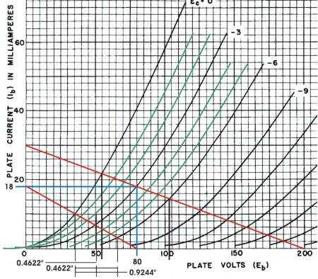

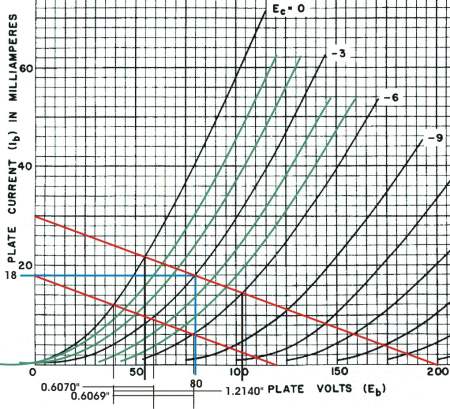

For those of you scratching your heads about Johan's posting, here are two load line curves to look over. The 6.6kz is derived from max current and voltage numbers. When brought down into the tubes operating range the halves of the AC wave form are not quite symmetrical, though quite close. The 4.4kz plot shows what Jacobs derivation produces, exactly symmetrical AC waveforms. This then will be the lowest distortion and greatest power this tube can provide. Please note where the ends of the load line stop, this is how you do one of these things, assuming you have good information, which the tube data sheet available here provides.

Mmmmm .... Rather too rudimentary; erroneous! (my reply #27).
Thanks to Bud for placing those graphs. The load I used (if I am Jacob!) was the leftmost red line, left graph. Staying with negative grid voltages only, it will be noticed that the lowest the anode swing can be, will be 36V, at 10mA (rounding). That would mean a possible anode swing of 44Vpp (80 - 36) at a current swing op 10mAp. But as an output stage uses a transformer, not resistor, as load, that voltage swing is actually 44Vp and not peak-peak. (The transformer inductance allows an anode swing to 124Vp on the negative grid excursions.)
Thus the maximum output according to these figures would be (44 x 0,01)/2 (for r.m.s) = 220mW and not a rounded (because of efficiency losses) 100mW as stated previously. Apologies.
But still rather low for any practical use.

Hi Moonbird,
Apology for my 'absence' due to personal reasons. I have drawn a good Eb/Ib graph page for the 6T4 and done rather more precise precise arithmetic.
I may not have been clear before - at 80V h.t. the scope for anode travel is rather limited as allowed by the Vg1 = 0 curve. As said, going higher on h.t. gives more latitude. I have therefore drawn a curve for the maximum plate dissipation = 3,5W and made a different plot within that limit.
I came to an operating point of h.t. of 175V at Ip = 10mA, and a plate-plate load (in p.p.) of 6 000 ohm. The grid voltage is then -15V, with a common cathode resistor for the two tubes of 750 ohm. Under these conditions one can get an ideal output of about 2,8W. Practical circumstances allowing, an output of >2W should be available.
There is not an ideal operating point; going lower with the output impedance means higher output but more distortion. This should be mostly 2nd harmonic which should cancel in p.p., but will call for spectrum analysis of the real thing in order to arrive at a near optimum.
This does indeed bring you to a useful low output, to answer your previous question. Practical usefulness of such is still a moot point, but at least answers the original question.

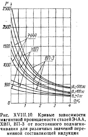

Permeability Graph and DC Current Over Winding
Hi, BudP,
Here is a puzzle for you as the most advanced transformer guru.
As we know, even in push-pull amplifier there is a small amount of DC current flowing through primary winding because, no matter what, output tubes can't be 100% matched and vise versa. Permeability of core changes depending on flux generated by BOTH DC and AC current. The graph attached shows value of permeability (mu) dependency of ~flux (B) and flux caused by DC current. However, the last is not measured in gauss, it is rather cryptic value (aw) measured (translated literally from Russian) in amper-turns per sm of mean magnetic path length.
Later this value used to calculate if DC current caused by imbalance of idle current in output stage is not causing saturation of core, as well as THD at lowest frequency and max output power.
Formula for "aw" is also attached, it basically sums products of I*(number of turns) divided by mean magnetic path length
The questions are - is this kind of graph available for M-series silicon steel, and if not, how to re-construct it? And how this "aw" is being called in English?
Thanks in advance.

This chart appears to be a means to predict the required geometrical construct for a magnetic core with a given flux loading. With the area of core and mean path length and permeability all as variables.
Commercial M core series has fixed two of these variables, core area and mag path length, within a center tongue width of unknown stack height. This is common E/I core in it's american standard or metric standard, path length vs center tongue width geometry.
With a fixed geometry you can use Johan's provided formula:
Lp = 3,2*A*µ*N²/l*10(power 8)
with the replacement of µ with 1/ (1 / µ + lg / lp) to arrive at
Lp = 3,2*A*N²*(1/1/µ+lg/lp))/l*10(power 8)
lg is total gap length
lp is magnetic path length
This factors in the total length of all of the physical gap(lg), which in E/I core is two times the actual material thickness of the gap material, divided by the magnetic path length (lp), added to the effective permeability of the core at it's flux load of interest, taken from those curves I posted earlier. This will provide an accurate picture of the core working in AC, with a DC current being offset by a gap vs path length structure, which is what I think your graph is pointing to. Except that your graph points to an unstructured core geometry, which you could tie down to E/I geometry if you chose to.
I know of no charts that tie this together for modern M core, though there must have been many back before the Allegheny Steel Co. standardized the industry. In my oddities collection I do have core and coils from various places that have all manner of geometries. Most especially some from Western Electric, with really wild construction.
There are not any actual permeability charts available for the M series alloys, other than M6, and even those are suspect due to the use of a non standard, non E/I core arrangement of ferrous material for the device under test. What I have provided, in it's deliberately distorted format, comes from 40 years of experience with occasional access to inductance bridges that can test a device while loaded with variable frequency, current and voltage. I am happy with them being a good enough reflection of real world core material, taken as an average of what you might actually have on hand on any given day, but they are by no means "accurate"
You can use the typical formulas for BDC and BAC to arrive at your flux load of interest, even for PP coil construction, with it's micro amps of DC offset current. The DC offset will tend to make the BH crash worse, which means crossover distortion will be higher, unless you can come up with a method of passive demagnetization for the polarity of the core, as B falls from the H saturation point. I know of one method for doing this for E/I core but have never deconstructed a c core, shell core type of core to find out if it is also applicable to them. I am theoretically sure it will work, assuming that my postulated event is happening as I think it is, but the physical torture of disassembling and reassembling one of those wound and cut cores is way beyond my level of practical interest.
If you want to pursue your interest, I would suggest the Allegheny Steel Co "Magnetic Core Material Practices" book from 1937. I do have a PDF of this, if you want to provide me with an email address in a PM. It is only 9.2mb of data and will give you much more accessible information for your investigations than is found in any other source I know of.
Bud
