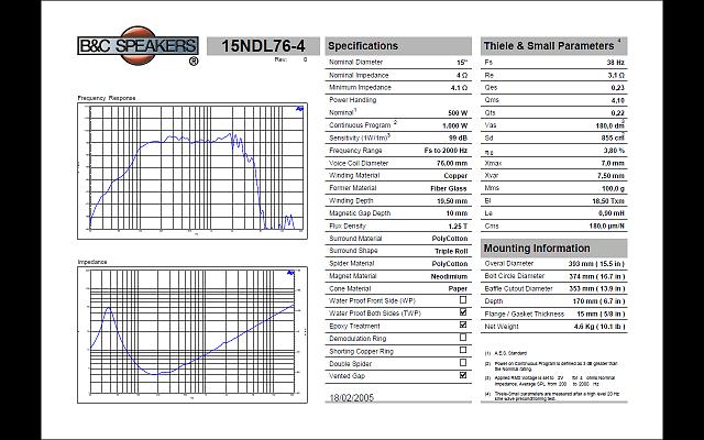

I have this woofer
In BR Box this woofer have a bad response and is not ideal for low frequencies.
Furthermore, the BR loading (64 liters 45hz) created a phase inversion that is able to reach clipping any amp I try... in free air woofer does not create problems
certainly the volume of my box is not enough, but increasing the volume excursion reached critical levels, and the peaks of impedance approaching.

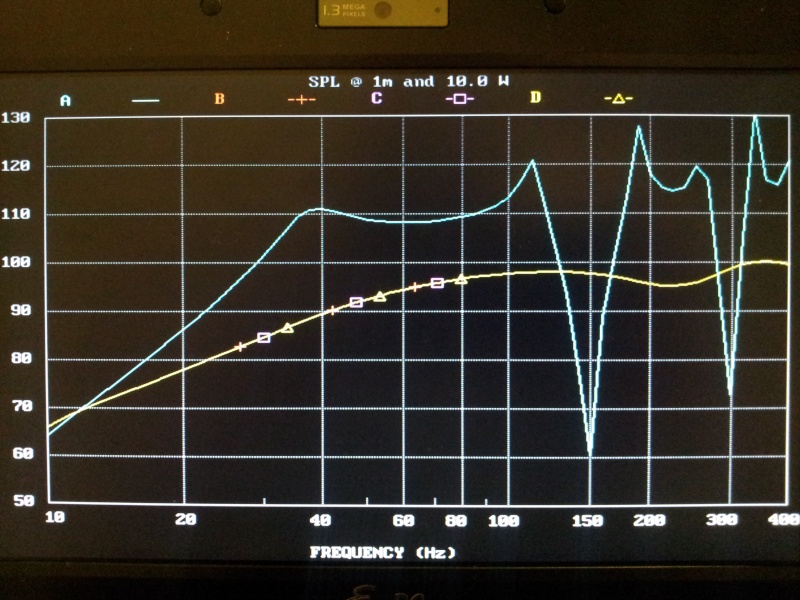

Now I found a simulator (bullock and white's) for transmission line box,
I attached a photo of the simulation.
the line lenght is 2.36 meters, with 30°celsius of air temperature.
therefore the box is tuned to 37 hertz.

thank you very much!!!!
I know the manufacter recommendation, but I can't understand how they can recommend a tuning so useless...
this woofers are for 2-way systems, and I don't understand how it is possible for them to put a box of 100 liters on a stand with a 1.4 inch big horn...
evidently the engineers at B&C are highly trained
I want to try to use them as a subwoofer.
with a 0.22 qts I can't get a good bass reflex...
for this I would like to try again the transmission line or the tapped horn

I want to try to simulate this woofer in a tapped horn,
if the simulated response is decent then it means that both box (TH and TL) are good for my woofer
but I don't know how to use hornresp...
simulation of the transmission line is too good for me...
Woofer is very braked at low frequencies, maybe it is better the transmission line because it is less compressed
can someone explain to me how to simulate it?

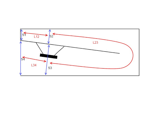

post1, pic4
How close do the speaker driver and the port need to be to meet the specification of a tapped horn?
Hi AndrewT
the photo 4 represents a Transmission Line box
I think the tapped horn must have the basket of the driver inside at the duct exit
i.e. at S3Hi AndrewT
And L34 can be 0.1mm.
But how far away from S3 can the driver be to still behave as a TH?
The question still stands:
post1, pic4

post1, pic4
Designer's decision. There is no specification for that particular distance. It is usually determined by the driver dimensions and how you can make the horn contour fit into the box.

I think that the transmission line simulator(bullock and white's) does not allow you to manage the proximity to the woofer from port
while I don't know how to use hornresp.

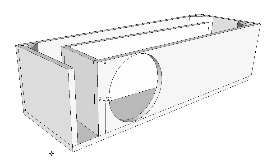

I drafted a reply a couple of days ago but could not remember the title of the thread
ask some of the guys who know how to do TH and tapped - tqwt and they likely will come up with something better than my simple example.
7.4 cubic foot inverted tapped horn/transflex-type test pipe from 1 sheet of plywood - YouTube
simple tapered 1/4 wave tapped tube made from one sheet of plywood

wow!!! thank you very much freddi
the impedance is very perfect, the first peak is bigger but at 18 hertz, therefore doesn't create problems...
the second peak is lower... appears to be a very easy load
also the excursion is more controlled...
if I don't ask too much, how are the external dimensions of the cabinet?
the value of spl is a little low but not bad...
those figures aren't real bad for half space - its 15.5" deep by 17.75" wide by 48" tall. Ask some of the guys real good with hornresp in the subwoofer forum to model some tapped horns and tapped TQWT-s for that B&C - if you already own then might put it to use - it looks like a high fidelity unit as a direct radiator.
here's an old thread at Speakerplans where I got the idea for the pipe and the aperture - look at the simulations - they should help you get an idea on how to use hornresp for this case.
