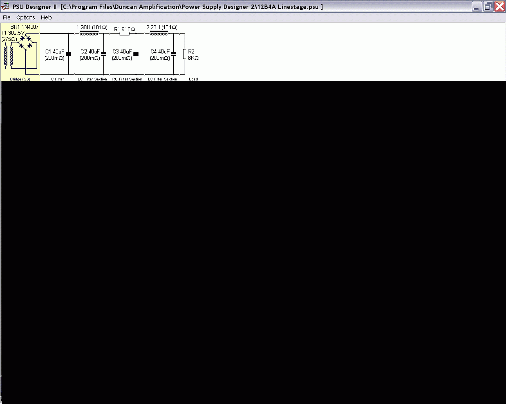

I'll even give up a example for use in the discussion.
pchw said:In MJ's book, he mentioned that it would need approximately
(RMS input voltage) / (inductance) minimal load current in the choke input filtering. Is this still applicable to CLC?
No. The choke of a choke input filter tends to act almost as a CCS. Therefore, it requires a certain minimum of inductance to work right. If you're doing a CLC, then the choke and the capacitor behind it makes a second order LPF. You'd then size it based on how much ripple you beed to get rid of, and set the turn-over frequency accordingly:
w(c)= (LC)^-0.5 (L: henries; C: farads; w: rads/sec)
Also, make sure that w(c) occurs well below whatever minimum signal frequency you're expecting so as to avoid "filter bounce" -- a resonant phenomonon that'll absolutely ruin your voltage regulation.
The operating conditions are different as well. CLC work isn't so demanding as LC work.
