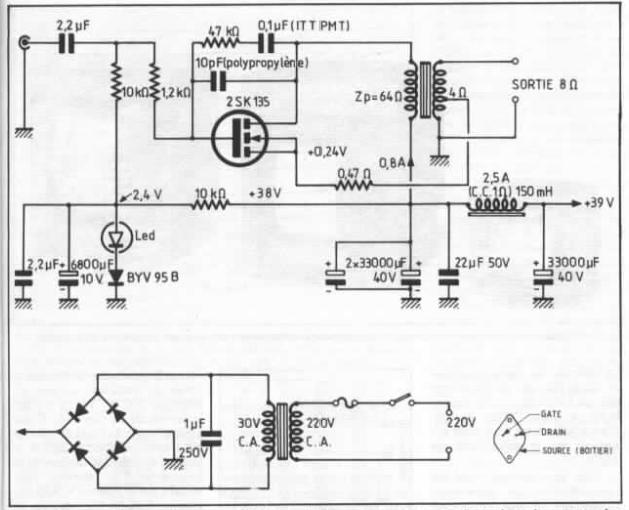

I'm just reviving this thread yet again - no doubt it's always of interest. I have some chokes which are 280mH and 2.7A. Could be used singly or in parallel. I've used them for DC filaments for DHT tubes like 300b, but not for a solid state amp. What do I have to worry about with turn-on spikes with larger value chokes like this? Can somebody explain how pure choke input, choke input with small cap in front (like 220uF) etc. works with regard to spikes? I have a multimeter but not a scope, and I don't know if a spike would show on a multimeter.
I note the original Nemesis used a similar size choke. One version has 150mH at 2.5a and another 200mH.
andy
I don't think that Andy suggested the above circuit to have a choke input power supply.
Omitting the 33mF/40V before the choke would make the power supply choke input (clear enough) and drop the final DC supply to about 25 V with the same power supply transformer.
Enough to be found on behavior of choke input supplies with regard to current spikes IMO.
Yes - Pieter is right here, I'm basically asking what to do with the 280mh chokes I have. Whether I can use them for pure choke input, or with a small cap or with a large cap depending on what the behaviour is regarding spikes. A friend of mine uses chokes in his power supply for a JLH amp and his opinion what that 280mH is unusable because of the spikes it would cause, so I was including the Nemesis to show a similar size choke being used. In this case the input cap is 33,000uf as stated, so does that mean a smaller cap or pure choke input was rejected as unsuitable?

I am using 300 mH (nominal value) chokes in a PS with 2A load and I do not get any turn on spikes at all, or turn-off spikes for that matter, even if there where spikes the heavy load would dampen them.
220uF in front of the choke is not such a good idea I would say. It somewhat defeats the purpose of the choke, can cause ringing and may not be able to manage the ripple current. Try to simulate your PS in PSU designer, I found that it is pretty accurate and should even show you the start-up behaviour.
