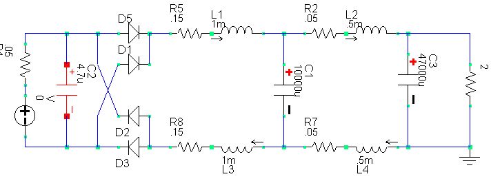

mikelm said:...I'm interested if you or others have ever tried 4.7uF directly across the secondary in a normal supply.
No one ever seems to comment when I mention this idea which I find strange becauce this is the best, easiest tweek I have ever discovered. no matter what cct I have tried it on, it has always made a big improvement.

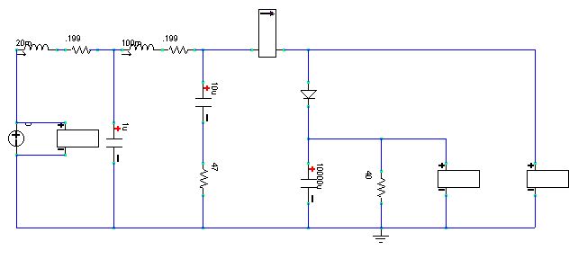

From simulations it seems that 4,7uF across the plus and minus of the bridge is more effective than across the AC inputs (= the secondary of the transformer). Smaller values (100n-1u) do work, but often require another bigger capacitor (470n-10u) with series resistor in parallel as a damper. Ratio of C's approx 5-10, resistor value depending on the inductance of the transformer secondary and the value of the C, but in the range of 5-15 Ohm.
Optimum value of the resistor in series with the biggest C is approx sqrt(L/C) with L is the secondary inductance and C the value of the smaller C. Your 4.7uF seems big enough to allow for a value of R that is close to the series resistance of the secondary, so effectively the LCR is dampened already. This is a nice advantage of such a big C: it makes everything less critical. A kind of cure for all, as you already noticed.
At least no additional C's across each diode of the bridge are required anymore, neither expensive FREDs.
Steven
Steven said:Your 4.7uF seems big enough to allow for a value of R that is close to the series resistance of the secondary, so effectively the LCR is dampened already....
I would have thought that the fact that the secondary is inductively linked to the mains via the primary would have big damping effect upon any potetial ringing in the secondary. The 4.7uF cap would enhance this by reducing frequency of ringing to a value where the inductive coupling is still strong.

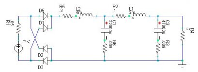

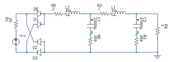

HELP !!!
I'm now in the process of building the cct below that I posted earlier.
What I am stuck on is getting my head round where to start with the chokes.
I don't really have any idea how large the cores need to be to avoid saturation and what size gap I will need.
They need to be able to deal with 6A DC.
The pairs of chokes in each leg are inductively linked therefore total inductance is doubled. i.e. 4mH & 3mH
Should I try 200VA cores as a starting point ? or do I really need to be looking at 1000VA cores to realise this design without compromise ?
Air cores I think would be too big and probably unecessary in this PSU.
God how much are these things going to weigh ?

Just for comparison, look at http://www.mundorf.com/english/bauteile/frspule.htm and from there to the transformer shape section in the menu. These coils are wound on the E-section only, without the I-section. They will not easily saturate and the size is given for different inductance versus resistance values.
If you use the additional I-section with air gap the inductance will become higher, but saturation might occur.
Steven
