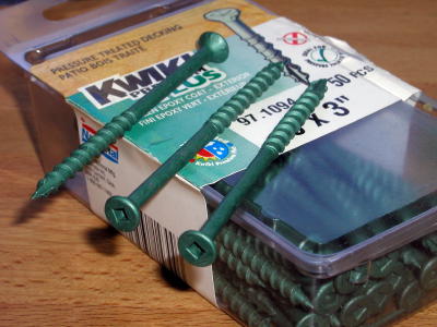

IMHO these are the best screws for woodworking. They are deck screws with square slot (Canadian invention, forgot the name;) ) instead of Philips, which makes driving them much easier. Also, the thread should not be on the whole length, but only on the part which goes throught the second piece. The length is way too big for MDF, since I was using them for framing.;)
