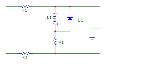

Hi to all,
Firstly, I did search the site fairly exhaustively for this issue and may well have missed it, but I did do my best. I'm new here and to it's credit, the DIY Audio site is an infinitely huge resource and a large if not a little intimidating at first...
My question is not about mains 240VAC (or 110VAC) AC inlet fuses, that has been well covered here and is not an issue for me, 240VAC 3A slo-blow always works fine on my LM3886 builds thus far.
I have a query relating to the absence of fuses on LM3886 amplifier PCBs on ChipAmp's LM 3886 kit, when compared with other SC/Jaycar type examples I have previously built.
The 1995 Silicon chip (SC), aka Altronics, aka Jaycar LM3886 amplifier boards all have clearly visible 2 X 2A fuses across rectified DC power coming from the PSU, into each of the amplifier PCBs.
The ChipAmp LM3886 version does not have these fuses.
I've built the Silicon chip version a couple of times, without issue. One has been in faithful service for 15 years and has never blown one of these 4 X 2A PCB mount fuses, but SC obviously put them there for a reason.
Has anyone added this fuse configuration to the Chipamp kit?
Does anyone feel that the ChipAmp LM3886 kit requires such fuses, or is their provision somehow already catered for within the somewhat revised ChipAmp design?
I've just purchased the ChipAmp LM3886 kit, am working on layout for my amp and wonder if anyone has discovered if they need this set of fuses and how they implemented them if so.
On another note, I've also noticed that the Chipamp kit has dropped the implementation of the enameled copper wound L 0.7 uH inductor/10 Ohm resistor (on LM3886 IC's pin 3 to Spkr output) as seen on the SC/Jaycar PCBs and on the "Typical Single Supply Audio Amplifier Application Circuit" on the TI LM3886 datasheet, as per the original SC design I am familiar with.
Are DIYers out there adding the wire wound resistor to the speaker outputs of their ChipAmp kits?
(I did read a lot on this here and note differences of opinion, but remain unclear as to whether or not this inductor/resistor should be implemented on the standard ChipAmp kit)
Any opinions or feedback on this would be greatly appreciated.
Cheers.
Apologies for the misplaced image, it is nonetheless, the Chipamp PCB set, showing no fuses.

You need to be sure that the 3 amp mains fuse will blow in the event of a single diode failure within the bridge rectifier. That depends on several factors such as reservoir cap value and transformer capability. The LM3886 would almost certainly fail 'catastrophically' simply spitting itself apart. Don't assume the chip would be the only item to fail, you have to cover all posibilities for safety.
You should always add the output inductor unless the stability of the amp is proved beyond doubt into any capacitive load that may be encountered.
If one supply rail fuse opens due to nuisance blowing, then the output will almost certainly go to the other supply rail. This nuisance blowing will then damage your speaker, unless you have a DC detect and a fast speaker isolation system implemented.
Your T3A mains fuse will pass 750W for ever when there is a major calamity in your amplifier.
It will even pass 1500W for a long time, maybe more than a few minutes before it blows.
Look up the fuse datasheet and see what they specify for a guaranteed rupture time for twice rated current and ten times rated current.
You may get a surprise.
I always recommend a close rated mains fuse. It can reduce the fault current passing time by a factor of ten or more.

Why thank you Gents, I feel welcome!
Jon, thanks for the tip, I figured as much...
I suppose chip failure will depend on almost any fault condition, which in short, says I should use a fuse. SC put them there, but I've never seen one blow yet. Still, I don't love the smell of burning ICs in the morning...
Tromperie, thank you, I shall look up that part number for the upright fuseholder, I was either unaware, or forgot they existed.
My next logical question was going to be how one implements these fuses, as I have very little real estate on the rear of chassis for 4 extra fuseholders, nor would I wish to run leads that far, so many thanks for the tip. Also I have very little PCB real estate on the chipamp Amplifier PCBs, as you would know. I'm working in one of those small extruded aluminium enclosures with heatsink as sides and I'm sure a fuseholder solution shall present itself.
Mooly! Yes, I have been reading your posts containing some stuff on Zobel and Thiele networks. This amp may encounter short or long speaker runs, or possibly run into 4 ohms if it sees something like an Event 20/20 monitor in the future (it may be re-homed), but for now, I shall build it for my old faithful 8 ohm monitors.
I used to build satellite comms & amplifiers all day, good at assembly and procedure, but an engineer that does not make me, that's for sure. This is my 3rd LM3886 amp, my first from chipamp. The first two I built were the Altronics/SC design. Those first two amps have the wound 10 ohm resistor on the spkr out, which I understand is a low pass filter (I was a Telephone Tech back in the dark ages) and may help with tweeter cooking or the possibility of minimising/negating some amp instability into differing loads or environments. These wound resistors are a feature I would like to keep, but I also don't fully understand what chipamp is doing instead, on pin 3 spkr output with the 2.7 Ohm 2W and 0.1uF (Is this an "RF shunt to ground" cap?) capacitor (Page 3). I do build carefully for end-use-environment with a view to avoiding catastrophic failure, but don't we all?
Transformer is a Powertran 160VA 25+25, which has given faithful but minimal service in my last LM3886 amp and is to be recycled. Caps are whatever chipamp included, Panasonic 10,000uF, if that's of any use to you. At this point, I'm not looking at any "gains" or tweaks, just to get it working and see how it sounds "as-is" from chipamp. I can rework/repair well, and add anything that needs tweaking later.
doors666, you raise a concern for me! Please do tell what will happen if one of these fuses blows. Does this point negate the use of a fused amplifier PCB?
I should look into building for the unlikely event of catastrophic transformer failure and employ the bridge rectifier based protection circuit that (I think) Rod Elliot mentions (unfamiliar with it) and that I've seen used here in a few amps...
Thanks chaps, I do appreciate the input, indeed.
Any thoughts, I'm open to suggestions.
Thanks again.

Then the close rated mains fuse should be <= VA/Vac = 160/230 = 695mAacTransformer is a Powertran 160VA 25+25
Use a T630mA, or T800mA mains fuse with a soft start circuit.
The limiting resistor could be ~120r
6 off 20r 5W, or 4 off 30r 5W, you might get away with 5 off 22r, or 3 off 39r

test the amp for a lost supply rail.
Measure the output voltage when only PSU Zero Volts and ONE supply rail is connected.
Attach a dummy load as well. You may find that the output voltage drops very significantly when the crippled chip is asked to deliver current to the load.
Now swap to the other supply rail.
If either gives a significant output offset during this fault condition, then you must protect your speaker. Ether no rail fuses and rely on a quick rupture of the close rated mains fuse or A DC detect and speaker isolation system. BUT !!! check the DC current rating of the mechanical relay. Many are only rated for 5Adc & 30Vdc, instead of 5Aac & 250Vac.
The relay has to open reliably while the fault current is passing to the load. That could be 10Apk @ 40Vdc while the smoothing and decoupling capacitance discharge into the speaker.

I have a sneeky suspicion that a T500mA will not reliably start a 160VA transformer. The initial current pulse can be limited by the resistor, but when the relay bypasses that resistor there will be a second current pulse and this my blow the fuse.................... I would probably require something in the order of "only" 500mA, when I saw your post show up...
I have some in my stock but I won't volunteer to test for you. You can blow your own fuses finding the suitable long term value.

Absence of positive rail is usually not an issue for these chips. Absence of negative rail will latch chip to +50% of Vcc.
A very handy solution is to run a simple output series relay, with the coil powered by the two rails after the fuse. Absence of any one rail will simply shut the relay off till the fuse is replaced. The relay coil needs a balancing diode, and a series resistor will be required to drop the voltage across the coil down to the required operating level, by a simple Ohm's Law calculation.
