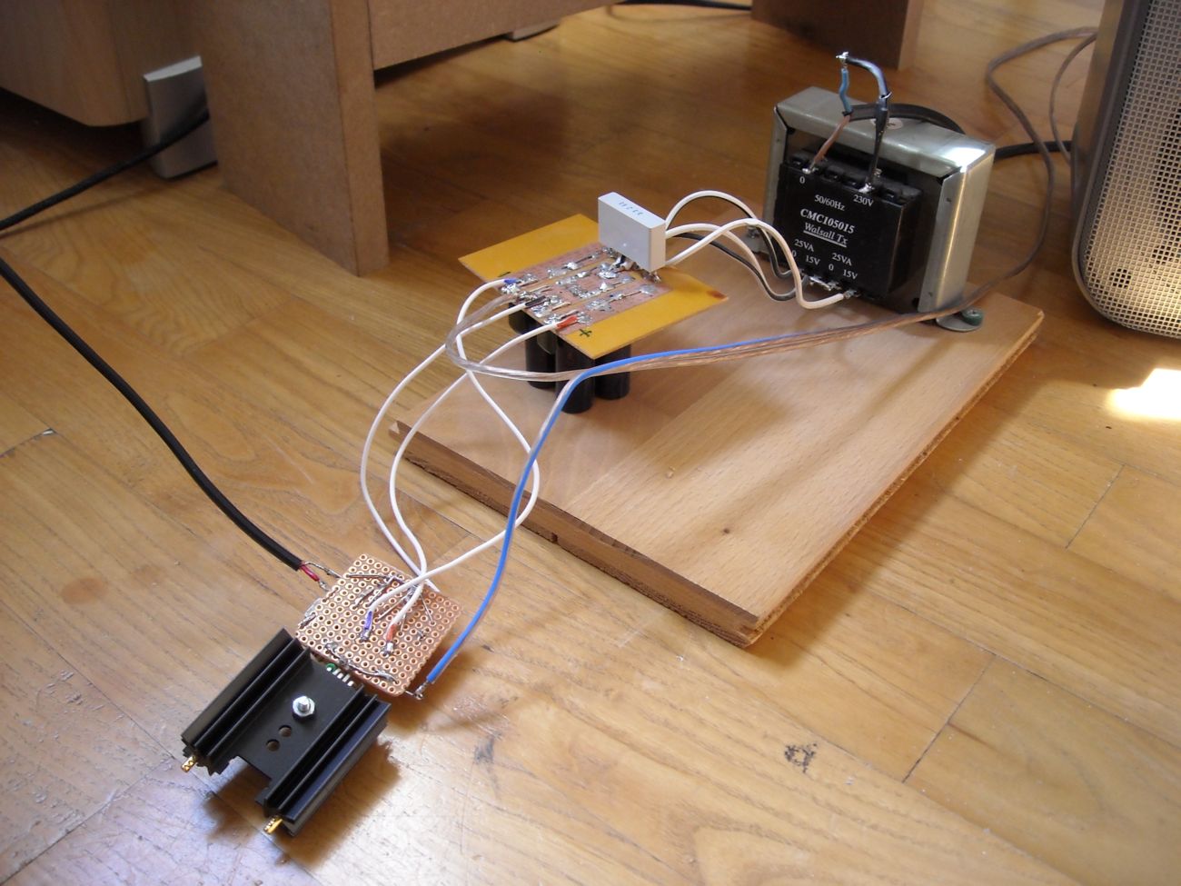

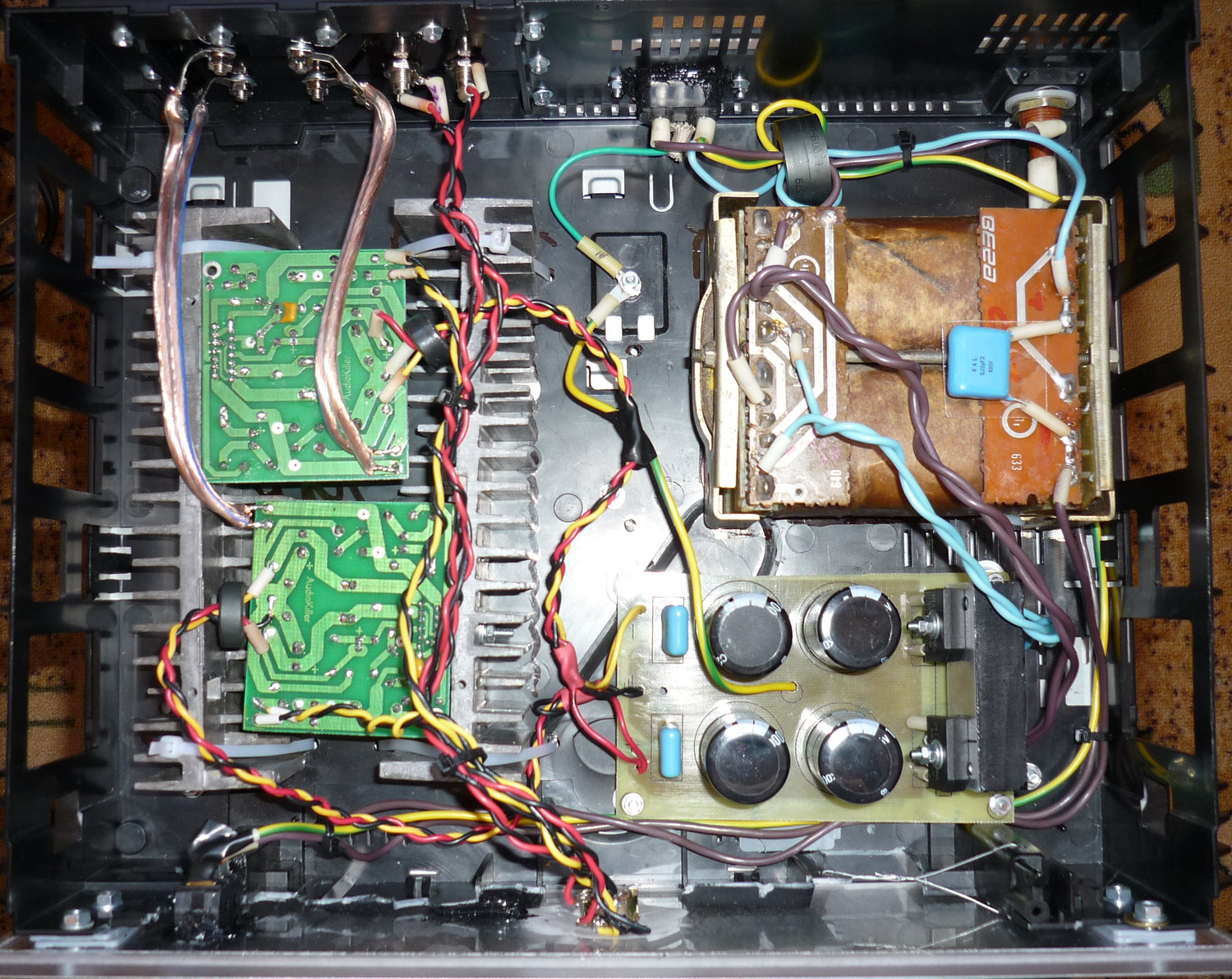

lm1875........testing the "cheap amp" . playing music. it works.

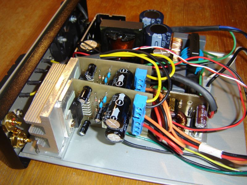

this is another GC..
A heat sink is only a sink until it reaches the temperature of the heat source. It needs to exchange that heat with cooler air to continue functioning as a heat sink.
You will be better getting rid of those heat sinks and just bolting the chips directly to the chassis walls (assuming the walls are > 4 mm aluminium). This gives a chance for the heat to get out of the box and not cook your capacitor bank.
Even venting the chassis will not help, as the heat sinks are installed horizontally instead of vertically, thereby preventing natural convection.
Agreed. Bolt to the side or put the sinks on the outside and drill some holes to mount chips on the sink. Even just mounted on the outside with no holes would help more.

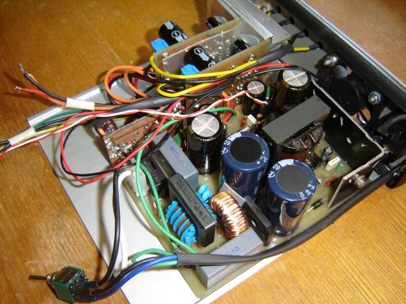

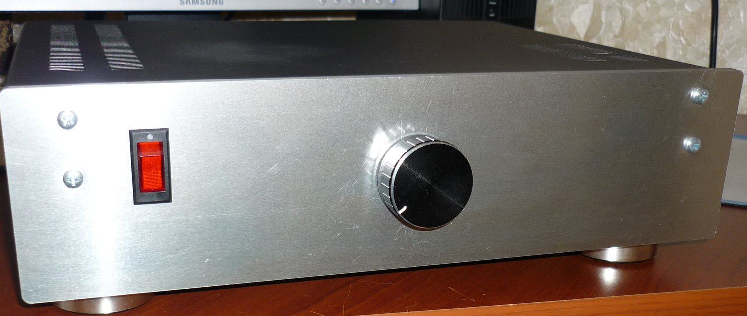

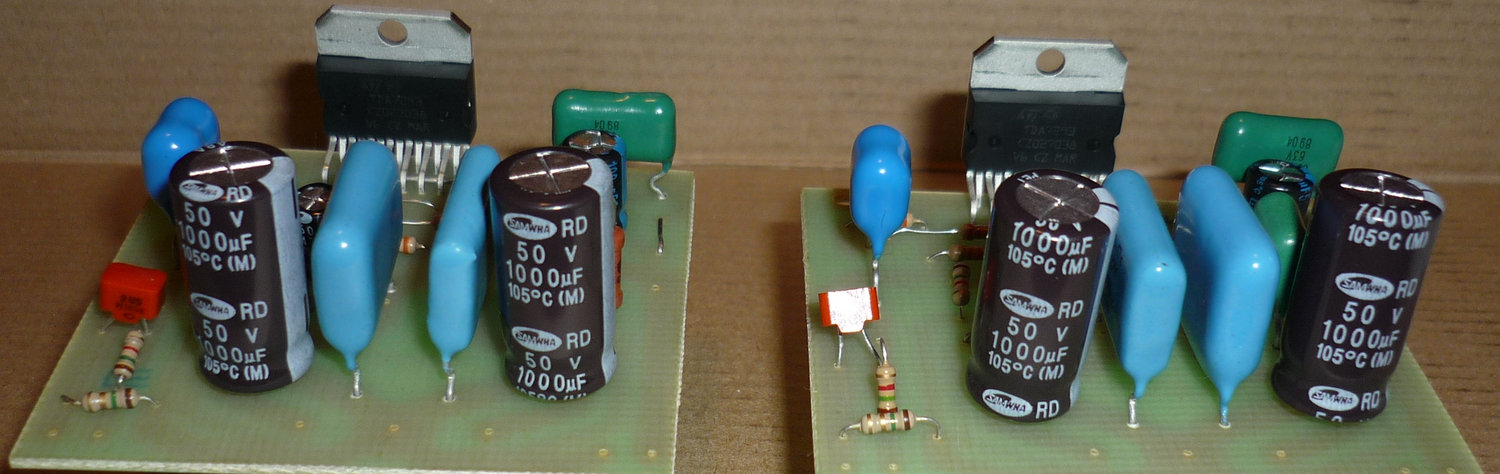

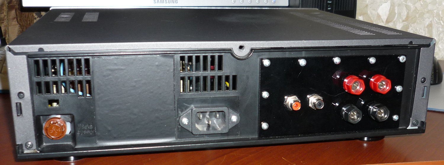

My new LM3875 chipamp
I finally finished my first amp!
It is based on the LM3875 Amplifier Kit from Audiosector.
I am using a Nuvotem 225VA 18V toroid.
The sound is amazing, and very detailed compared to my old integrated Yamaha amp!
