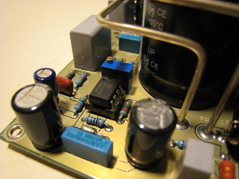

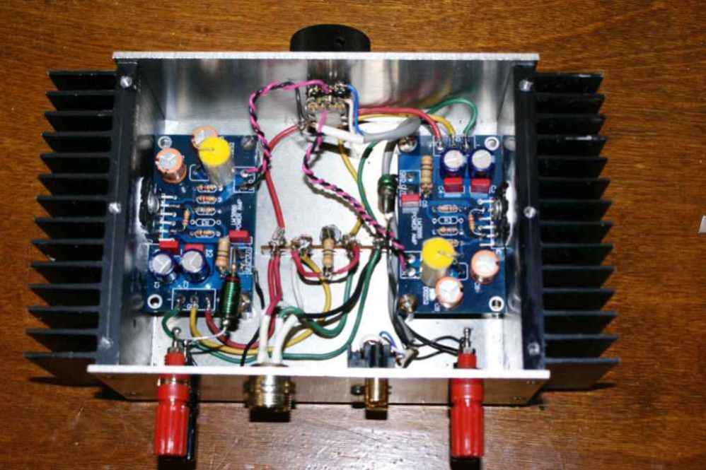

Hi guys.
The bar is an RF wire silver coated.
That's a useless feature, just cosmetic.
I get it at work.
The baby sounds good.
The only concern is that after a while of listening at half power (or more) the heatsinks are getting hot.
The supply voltage is +/- 36V, that's why the power dissipation is high.
The fan "sucks" out the air that enters from the holes under the heatsinks.

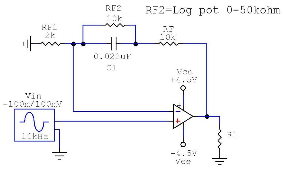

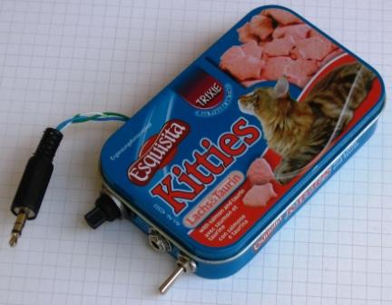

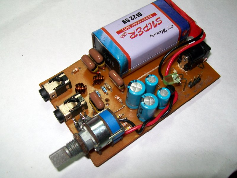

Here is my second attempt on Cmoy amp. It is still a half-prototype but way better looking then my first Cmoy. Input caps are Epcos MKT (blue color) and the red Wimas are for active bass-boost on OPA2132 fedback. The 50k pot is to adjust the amount of bass from 0 to +12dB or so. The second chip is KIA 4558F and is used as voltage splitter to get +-4.5V from 9V battery.
Well, I couldn't find Altoids around here so this tin can is the best thing I could get in a hurry to finish the project.

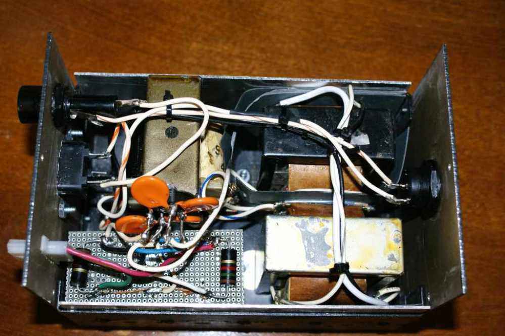

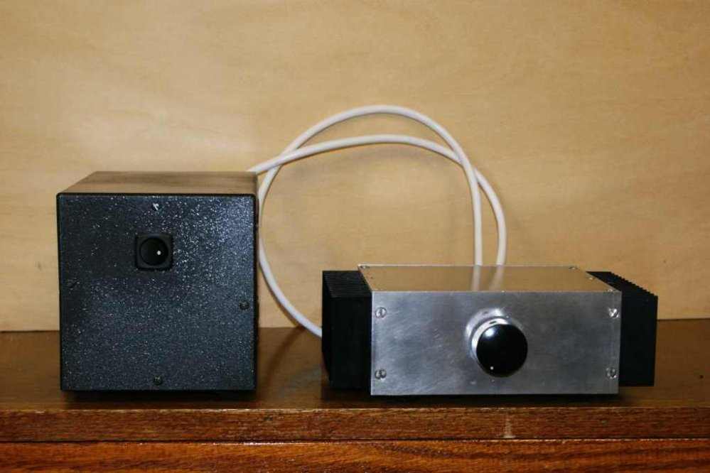

Here is mine (lm3875)
It is very small,but ý'm stisfied
its power stage contains a transformator (150w),two bridge,and four cap (10,000 uf)
PCBs is very small
