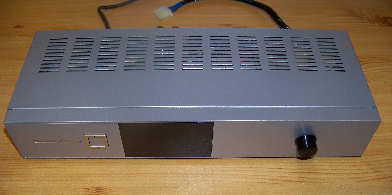

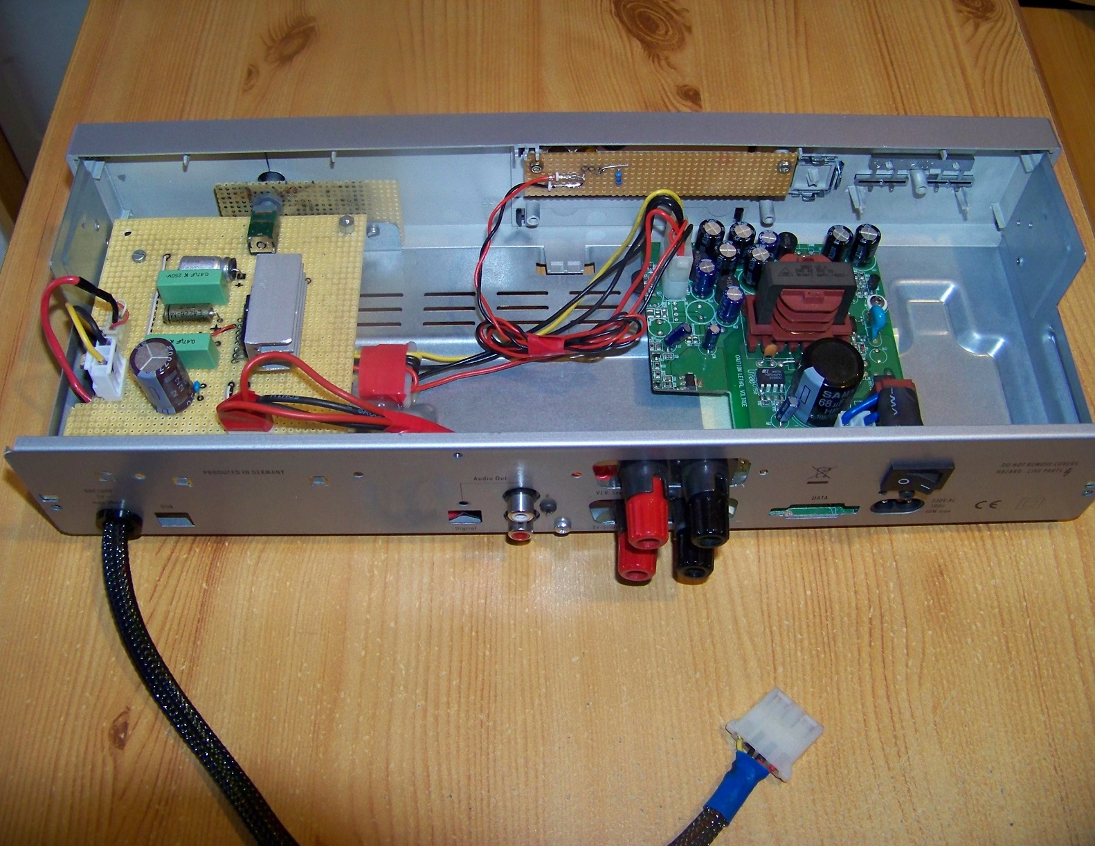

In the summer the heatsink was getting kind of… hot (43 C) so I’ve modified the case.
Here you have the same bottom case and internal circuit, now with a much bigger heatsink and cover.
We’ll wait for the summer to see the difference (Hot room around 30 C).
Regards

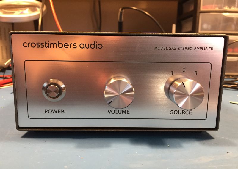

After reading positive things about the TDA7297 I decided to build an amplifier around one. The PCB is my own design. I want to clean up the internal wiring a bit but otherwise it's done, and works well.
Very nice work.
Did you do the silk screen text and layout yourself or did you have to send it off to a company to have your Chassis silk screened?
I am trying to do a similar project and want the text labeling to look professional like how you did.
The front and back panels are laser cut/engraved 1.5mm thick acrylic done at pololu.com. The artwork(s) for the panels were created in Inkscape. The panels are held in place by the controls on the front and the connectors on the back. My immediate supervisor (wife) doesn't like to see fasteners on the front of any of the equipment I place into service in the living room. I got an exemption for the screws on the sides holding the covers on.
The cabinet is from circuitspecialists.com. It's their EM-01 model.

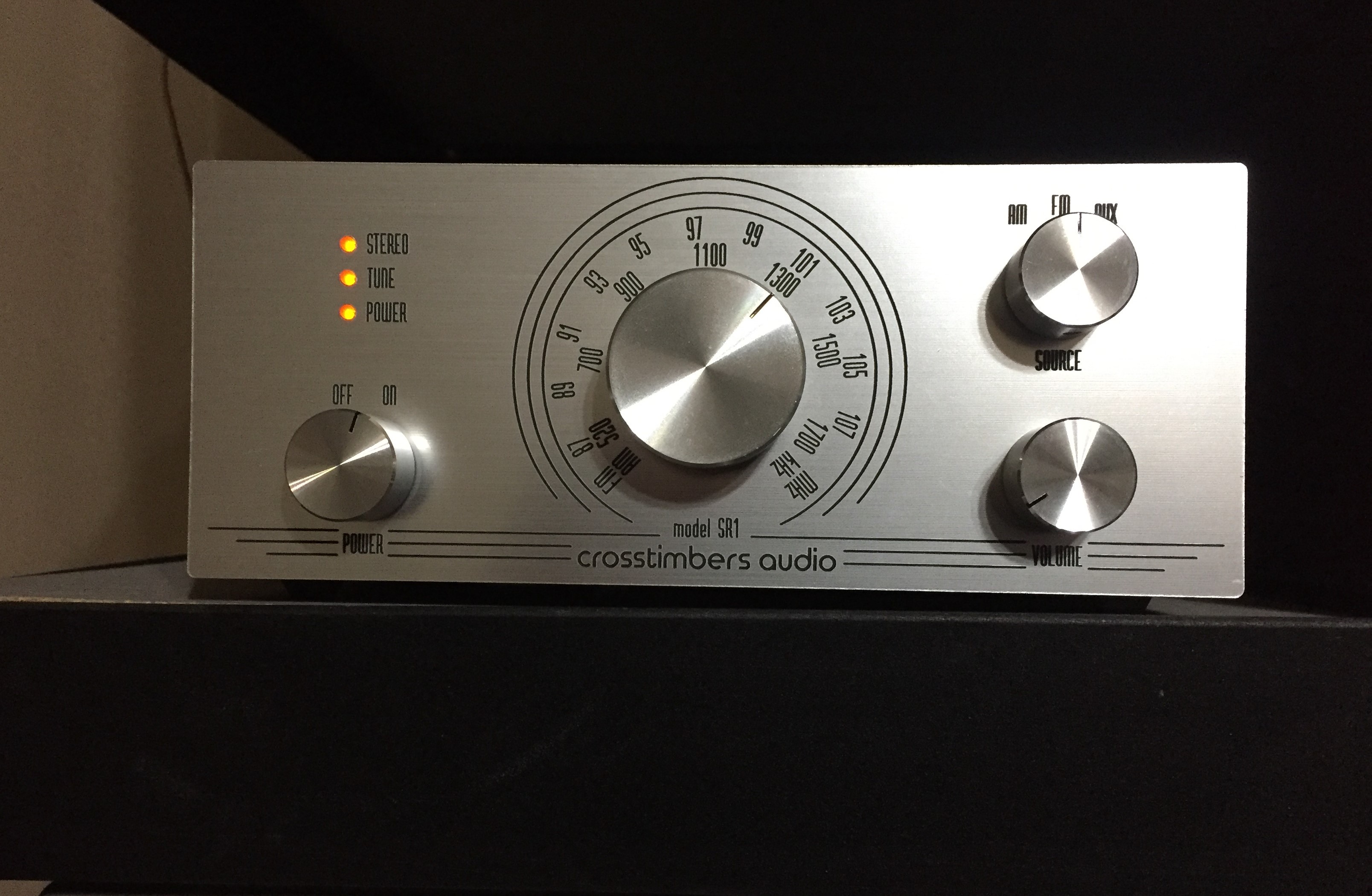

TDA7266 / Si4831 Stereo Receiver
This is a little stereo receiver I put together using a TDA7266 and a Si4831 mechanically tuned AM/FM stereo IC from Silicon Labs. Originally I wasn't happy with the way it was turning out and had set it aside. Last night I saw it languishing on a shelf so I took pity on it, put it on the bench and finished it.
I would be very happy with the way it turned out if I had built that.
Thanks John. Originally I believed that the transformer was too close to the amp PCB and that there are too many wires criss-crossing the cabinet. At one point I had put it aside thinking it needed a larger cabinet and a better internal layout. Considering that it is now my office music source, it appears I was being too critical.

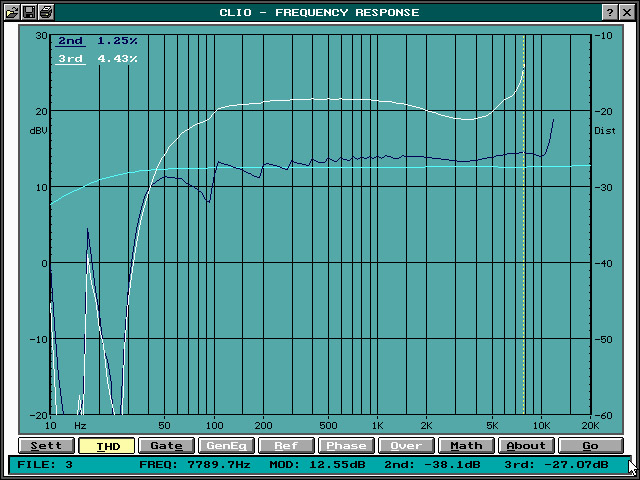

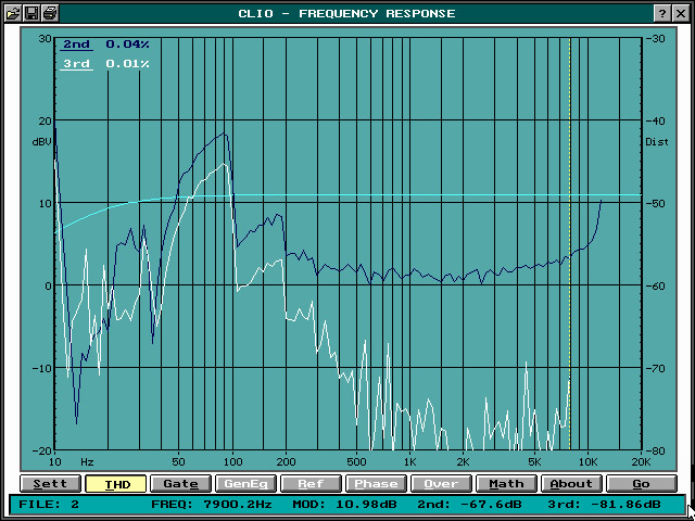

So I have desired for some time to build a chip amp for low power application and after a couple of misfortuned attemts I finally stumbled upon a chip that actually works and does that better than expected. This used to be a DVB-T receiver and a recorder, had a HDD in it, so I was lucky to have found it. The chip and Alps pot was salvaged from a Blaupunkt cassete player. The power supply is equiped with typical voltages you'd find in computers so it was that much easier.Took the wires out through a screw-on fuse holder to power the cd rom player. Yellowed plastics doesn't look appealing but I'll try to get my hands on some chemicals to clean it up. Btw, does anyone know of a product that would succesfully whiten it to original color? Tried googling but the hydrogen peroxide doesn't sound reassuring. I know professionals have got some sort of a solution for that. Next project is loudspeakers and I have some Aiwa mini component system units on a shelf, a 4" bassmid and a 2" cone tweeter. That will be finished by this summer, hopefully. Thank you in advance!

This apparatus wasn't modified in the sense that the safety earth is disconnected now. It never had that originally. The chassis is exactly as it left the factory and the chip is in double bridge mode. There is a thick plastic sticker on the inside below power supply that manufacturer thought was a necessary precaution.
