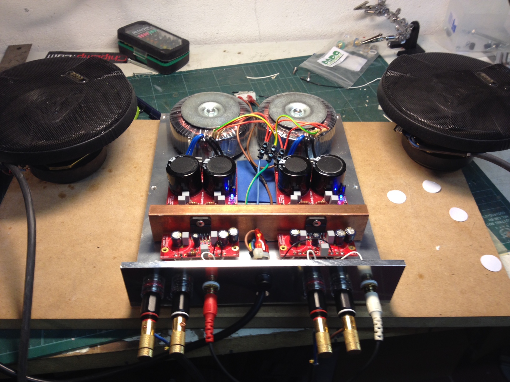

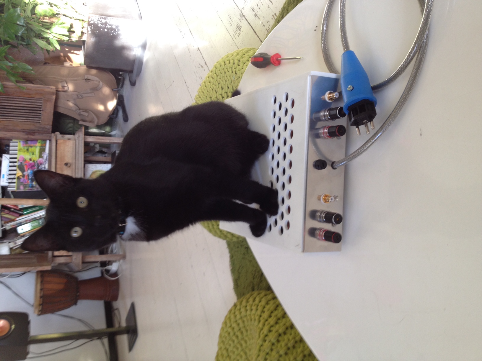

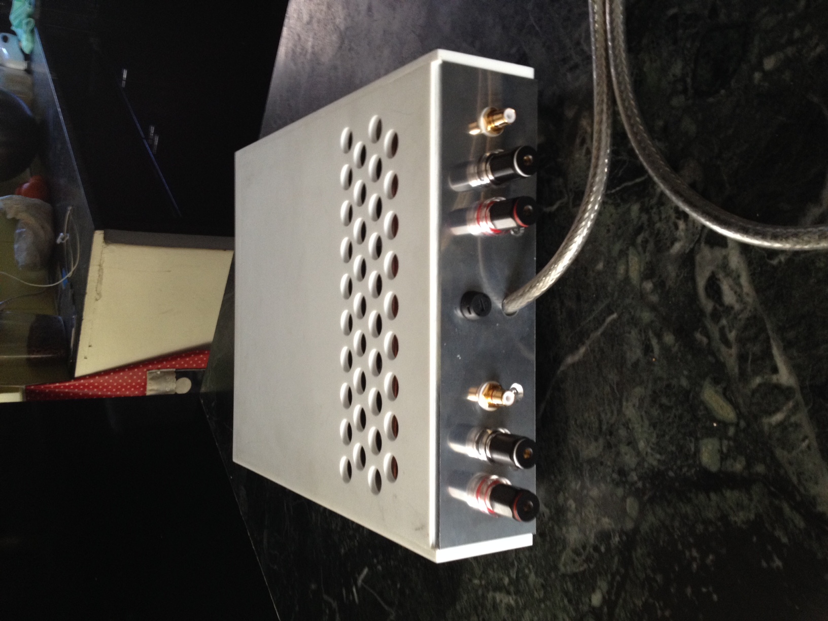

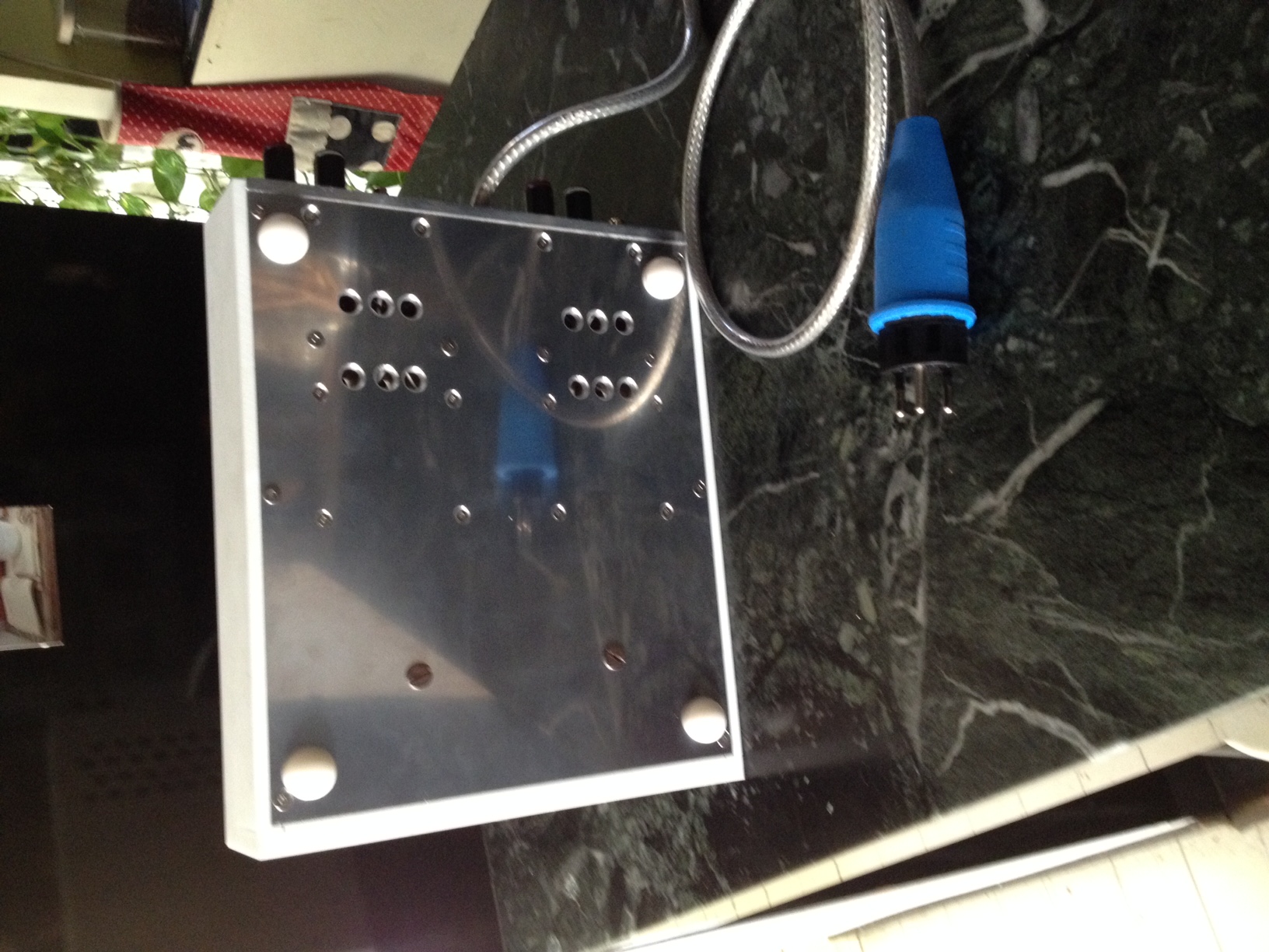

Double mono chipamp, single Corian chassis
Standard chipamp build. Trafos are 2x160vA each 2x22v audio grade from Toroidy.pl. they are very quiet.
I don't know yet if the copper heatsink will be enough but until now the chips haven't heated up much at normal listening levels.
The sound is very punchy with powerful and tight bass in to a pair of KEF LS50's
...I don't know yet if the copper heatsink will be enough but until now the chips haven't heated up much at normal listening levels.....
If the copper bar is bolted / screwed to the bottom of the chassis that will be PLENTY.

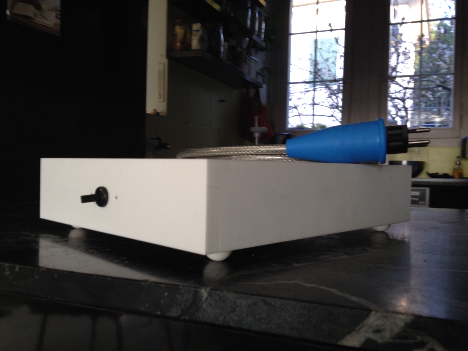

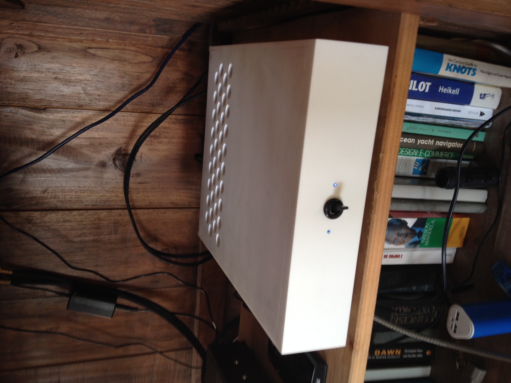

Added pics

Nice build! I agree with troystg that if that copper is thermally tied into the base material you will be fine. Even if it isn't since you have airflow holes top and bottom you will probably get good convection through the case over the heatsink. Best way to find out is to put on some of your favorite albums with good low end presence, crank it up and listen for an hour or two
Warm = OK, hot = OK, egg frying = bad. The spike protection circuitry will keep you amp safe regardless and if you hear it kick in (i've never gotten mine to even with some serious abuse) then you could always put an aluminum finned heatsink in its place without having to rework your chassis. You should be fine though, enjoy the wonderful clarity and dynamic range of your new best friend!

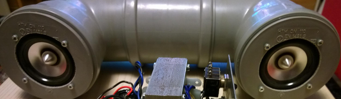

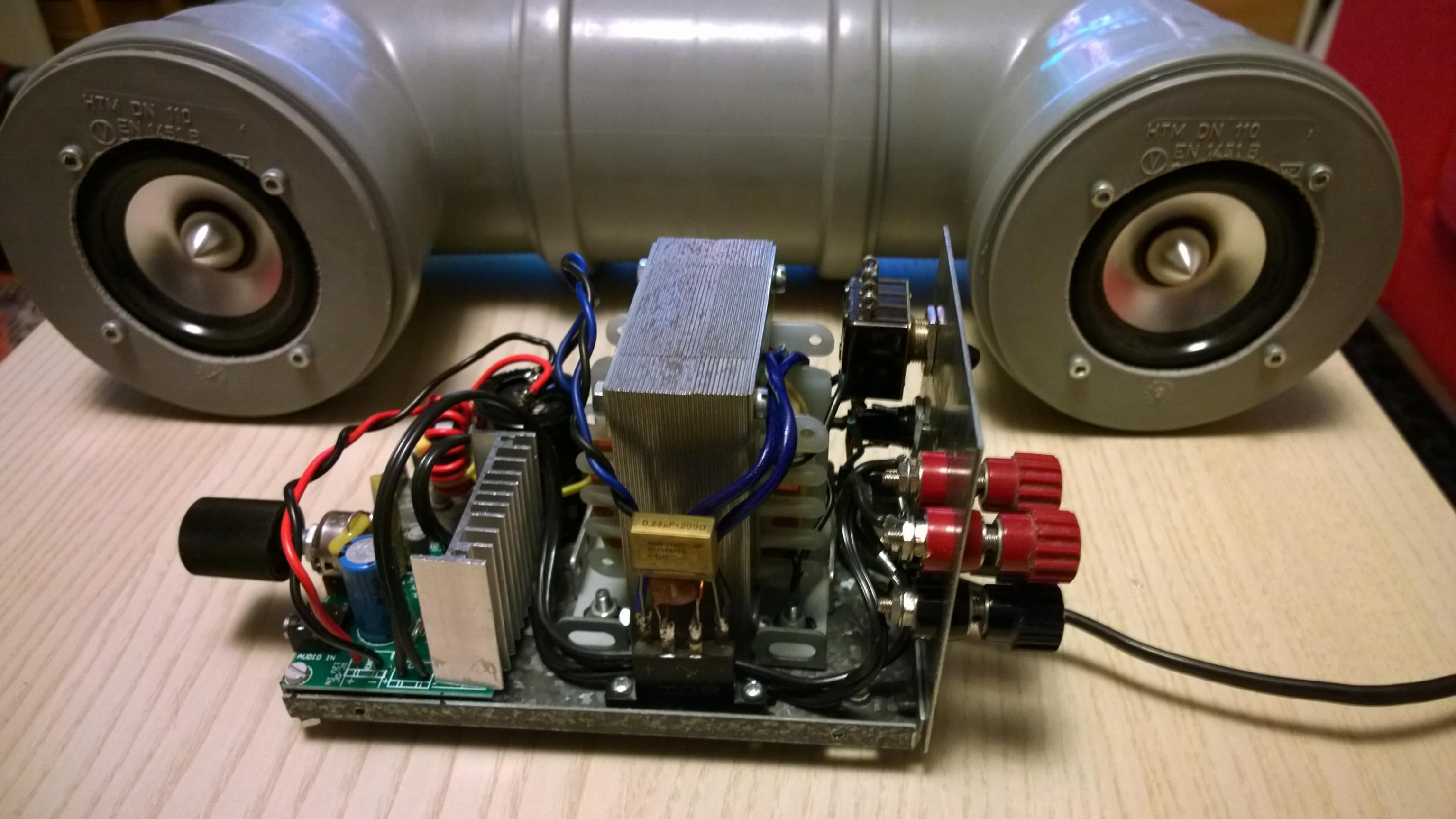

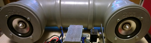

My TDA7297 amp. Modified and built with old components.
very cool mad max style [emoji106]
Sent from my phone using Tapatalk

Yep, I finished the chipamp. My build weighs a ton Next, I plan to build a Peter Daniel amp with the exact same layout and compare the two. I'll reduce the thickness of the lower "L" part of the chassis to 3mm (currently 6) to bring the weight down a little
The sound is great. I can only compare it to a modified Quad 306 which has been my reference amp. I think the chipamp compares very favorably but the soundstage is much larger / wider and also better defined.. probably because of the dual mono layout ? but that is just my 2 cts.
