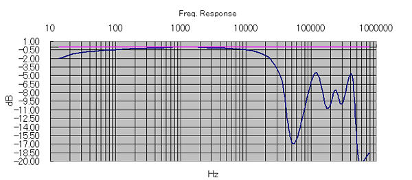

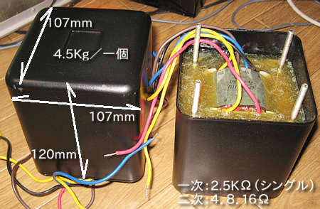

Isn't .5mm lamination too thick for and output?
i use them for power transformers and guitar amp outputs......
I though one would never build an audio trafo with at least .35 lamination (M6)
The frequency response will be limited by the core lamination, I don't think they can sound very good...
at our side of the world, 0.35mm lams are called Z11, an M6 equivalent.....i used them to build output traffos....
A dcr of 1.1 ohm on the 8 ohm tap is actually a pretty good result, I've not seen many that were better including the Tamura F-5002 (about 1 ohm) I used in some projects.
