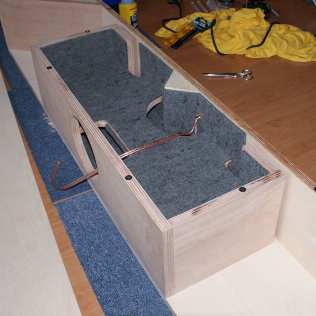

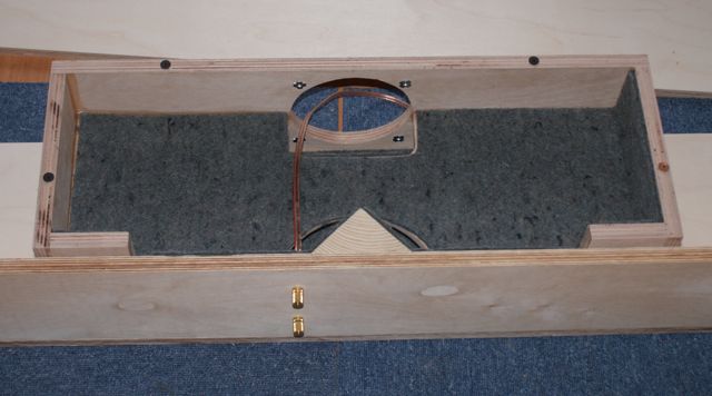

Today I glued in the damping. I did the top, back and one side of the chamber plus one side of the brace.
Sorry for the bad pics, the winter light does not help indoors...

JC951t said:
Hi Jeoreon,
Did you just tag the felt along the edges with some
tags along the center of the felt ?
I followed the hot glue gun advise. Some dots of glue in a pattern on the felt, holds like a charm.
Burnt my hand a bit in the process. :rolleyes:
I just closed on of the boxes, next one tomorrow, hope to listen to them on Sunday. Pics will follow.
Jeroen
Jim Shearer said:
Jeroen,
After burning myself, I learned to wear latex gloves when using hot melt glue. ;) If I get some on me, it does much less damage, and I can get it off me in just a moment.
Cheers, Jim
Good tip about the gloves. I have diy/gardening gloves that I will wear next time. (probably will burn my hand again before I remember...)

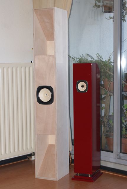

Both cabinets are now sealed and playing. First impression : they realy look cool!!! :cool:
Sound : I can only compare them to my single driver FE103s Doppenberg pipes and have no trained hifi ears.... The Chili's go a lot deeper but are a bit dull. There seems to be "more music" but it lacks some sort of presence... They miss the magic that the FE103s pipes have. I bought the drivers on marktplaats (dutch ebay) and the seller claimed they were only used for testing and as the units looked absolutely new my guess is that they still need to "burn in". I will use them for a few weeks and see if the sound changes before I do any mods. I remember the FE103s also taking some time.
Scott, thank you for the design!!
Jeroen

greenie512 said:
Jeroen, I'd suggest trying some outriggers/spikes and secondly remove a bit of internal dampening at a time - even remove the lot to see if this helps - you can always re-fix it (might be a bit fiddly)
Thanks.
I am sanding the cabinets now and depending on price have them sprayed. After that I will place them on a three spikes/cones, two in the front, one on the back, on small beams that stick out a bit. In the meantime I will EnAble and planet10-cone the drivers.
When all irreversible tasks are done and total playing time is nearing 200 hrs then I will start fiddling with the damping. I'm afraid that sound will change anyway when spraying/EnAbleing etc... Adjusting this damping is indeed fiddly so wanna do that job only once.
Jeroen
