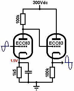

The schematic is straightforward. Very similar to that:
The signal from conversion resistor is tied to the grid.
I'm using 6DJ8 valves, 180V mosfet regulated supply, 8k2/2W anode resistor, 150ohm cathode bias resistor (unbypassed by capacitor) and 15k/2W cathode resistor in the cathode follower.
The picture omits output signal capacitor (at least 0,47uF Mundorf silver in oil or better, that's essential) and resistor (100k or more) from output to ground. Hope this is clear enaugh.

I have already a tube output for CS4397 but with 1 x russian 6N6P tube and I also have a similar tube output for TDA1541A using 2 x 6N2P russian tube (a la lampizator design)...do you think that changing these values of components that you gave here might worth a try using that kind of tube only as a quick and dirty solution for the PCM1798 ?
CS4397 is voltage output DAC, if you use lampizator style gainstage you get about 20V signal level at output. It's too much for solid state amplifiers and it may lead to damage.
You can try this stage to PCM1798, maybe you will have to change IV resistors value due to different gain of the stage.
The 6N2P tube has very huge internal resistance so you will have big output resistance of the stage. It may lead to weak sound with most of solid state amps and some of tube amps.
