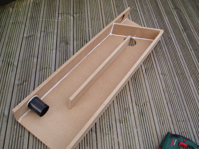

Construction began today at 11am, (forced) end at around 6pm.
Lots of drilling (screws), got one speaker nearly done (the TL took the time... all those angles), so one should be finished tomorrow morning some time. The (new) plan is to silicone the joins (aswell as screw) so it will be sealed, with no extra dimensions to take care of when making top and bottom. Too busy to take pics (sorry!), but I'll probably have some tomorrow.

Careful with squeeze-out when using silicone as adhesive - it's a bitch to clean, clogs sandpaper like crazy and can interfere with your finishing, whether painting or applying an adhesive backed sheet product.
An alternative would be something like white PVA glue (Welbond, etc) - these don't cure as hard as yellow glues or the moisture cured polyurethanes, but are much easier to scrape off when dry than silicone.

Sounds like you've been busy. So you decided to implement the TL in the end. Did you just go for an exact copy of the Tysen TL i.e 10:1 taper and same length? Good luck with the rest of the building and look forward to hearing how they turn out.
Ewan
As it happens, I used the numbers you gave me. Don't panic if they weren't spot on - this is for flattening an impedance spike an octave below XO.
Made the first one, plugged it in. Initial impressions are good, but too much bass, so I shorted the FR resistor. Much better now.

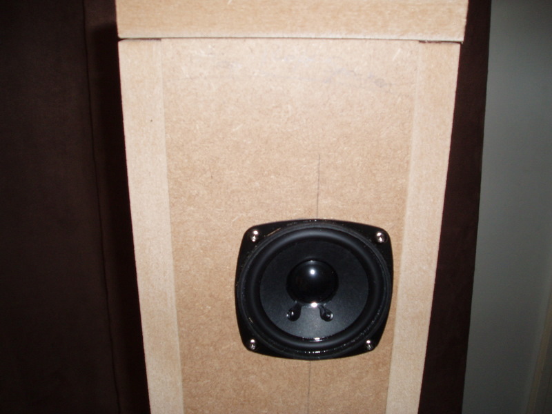

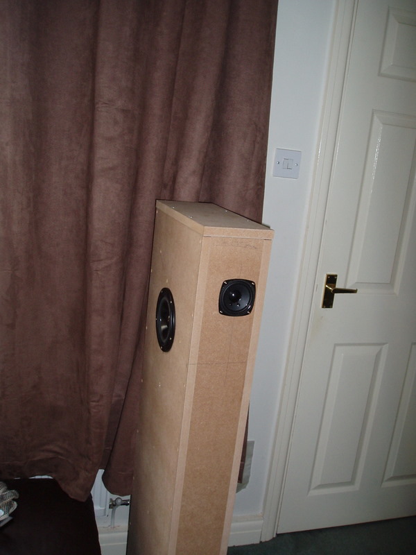

Ok, I have more time now.
Must be said, this speaker pushes out a surprising amount of bass - copes with 50W with no excursion problems, which is a good start.
As I said - no worries about the TL - it was something to have as experience, and it doesn't have to be accurate to the nearest Hz, as it's an octave below the XO point.
I'll begin with construction bits I haven't yet mentioned. I put a vertical brace in (like Dave's), with really helps with sorting cabinet resonances. At 4' of MDF, there'd bound to be something there.
I used 18mm MDF, with means it's a) pretty strong, and b) extremely heavy.
If you want to clone this, I used (per speaker, all in mm):
1220x360 x2
11x1220 x2
146x360 x1 (top)
310x410 x1 (plinth - needed for stability)
The TL piece x1
Any bracing you want to put in x1
Hard to tell on sound yet, as there's only one, but it goes plenty loud. Need to stop dad playing The Clash through it now...

Just put the notch filter in - sounds much smoother, and the treble is more in-line (volume-wise) with the mids.
Quick question - I mounted the port at the bottom, meaning is has to go around 4' before going through the port. When I listen right on top of the speaker, there's bass cancellation. Is there a rule of thumb on how far away you can put a port?

Do keep in mind that with the aspect ratio of your bass enclosure you have an ML-TL not a bass reflex, so if you developed the sim without the MJK worksheets any results you have will not be predicting what is really happening.
dave
That's strange - it seems to do exactly what the sims show. Steep bass rolloff below 40Hz, then pretty much flat for the rest of the frequency response. You've got me doubting the whole speaker, but it sounds that good that I don't think I could take it apart...
