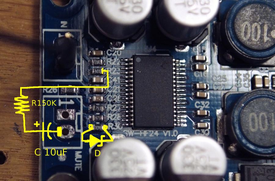

possible anti-pop (?)
Here's what I was able to deduce - please, correct me if I'm wrong (and sorry for the poor drawing, not my forte...).
In short, a "Giancarlo/Drmord" anti-pop solution, from what I was able to deduce from the board and traces, with a little help of a multimeter...
But, the soldering (if there is to be any at all, still not sure whether I'll go on with it) will be tricky: even if I forego the Schottky barrier diode on R30, I still have to solder one end of the 150K resistor on R23... very tight :)
Anyway, please let me know if I got this right... It's late and I'm not thinking straight...
Thx!
PS: I got hold of a 10K log stereo pot, and it helped - the "hiss area" on the pot moved to high volume side, it's a bit narrower, and in general leaves me a lot more "usable" volume area (if we take 6 o'clock to be max. volume, the hiss now appears between 3:30 and 5:00, approximately).
But, if I'm going to use these as pure monoblocks (separate enclosures, without potentiometer), I guess it will be a non-issue....
I wouldn't go for this "big" 10uF, better is higher resistance and lower value capacitor - in case of component size. (It's also better to have less capacitance when you deside to left the diode out.) I don't know if the "Giancarlo" mod is needing 10uF. o_O
You may go this way:
Diode is not "a must", but nice to have.
But all in all, doable. :)
The diode protects the MUTE-input from reverse voltage/current which will be there if you power-off the device. (As long as the capacitor is discharging) You can rely on the internal protection diode, 1uF isn't that much energy but to be really safe, you'll put this diode in parallel. Saying so, this is only tested with 1uF - if you go for higher capacitance you might damage the internal protection diode.

Man, I hate soldering such tiny things :(
My eyesight isn't what it used to be (to say the least), and I look positively hilarious with 2 pairs of reading glasses stacked on top of my nose :)
Seriously, this Sanwu TPA3118 is tiny... Besides, looks like the components aren't really "top notch"... Looks like they used substandard smd resistors - I've had two die on me during soldering... The contacts/pads on the ends of resistors were rather deteriorated... Had to resort to some creative microsurgery - the SMD resistors I have at hand are two sizes too big, so I had to solder them upright - and I managed to also remove one of the pads on the board :(
So, the other end (where I lost the pad) was then soldered directly to pin 2 (actually, between legs 2 and 3 - SDZ and FAULTZ)...
Talk about microsurgery.... phew!
One board/channel now behaves as expected, with antipop implemented properly, but the other one is quite strange - it starts playing only when I turn it OFF!
Strange - I used the same components, same soldering points (apart from that hack with SMD resistor mounted upright).... The left channel behaves as expected - starts playing after about 1 sec. delay. The rigt channel/board remains silent. But, when I cut off the power, I can hear about 1/2 second of sound from it - as the capacitor is draining :)
In short, these boards are turning out to be a DIY nightmare (for an amateur with a soldering iron like me)....
More investigation to follow tomorrow - I've had enough for today... :eek:

Anyway, I managed to get this in order - both boards now have properly implemented "anti-pop" with about 1 second delay after turn-on.
The problem with the other board (which played only for 1/2 sec. when turned OFF) was that the 100K resistor leading to the mute pin on the chip had a bad contact. A quick touch with the soldering iron on both ends got it functioning properly again :)
