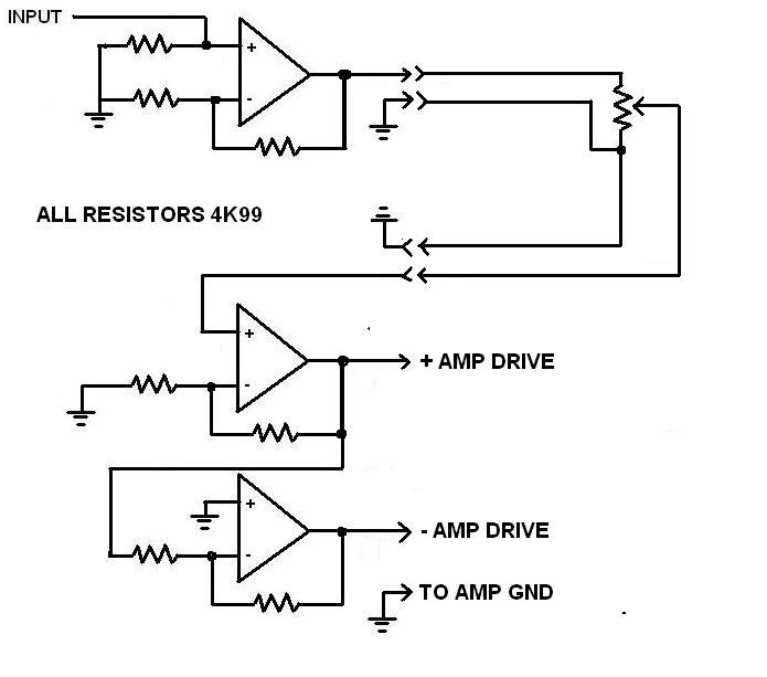

As I said...I use a low impedance source.
Usually an LME49710 (or LME49720) and drive the amplifier with a balanced (differential) source.
I have not tried any tube based preamp so I cannot comment on those.
If the preamps you are using (or are going to use) has a low output impedance then it should work fine.

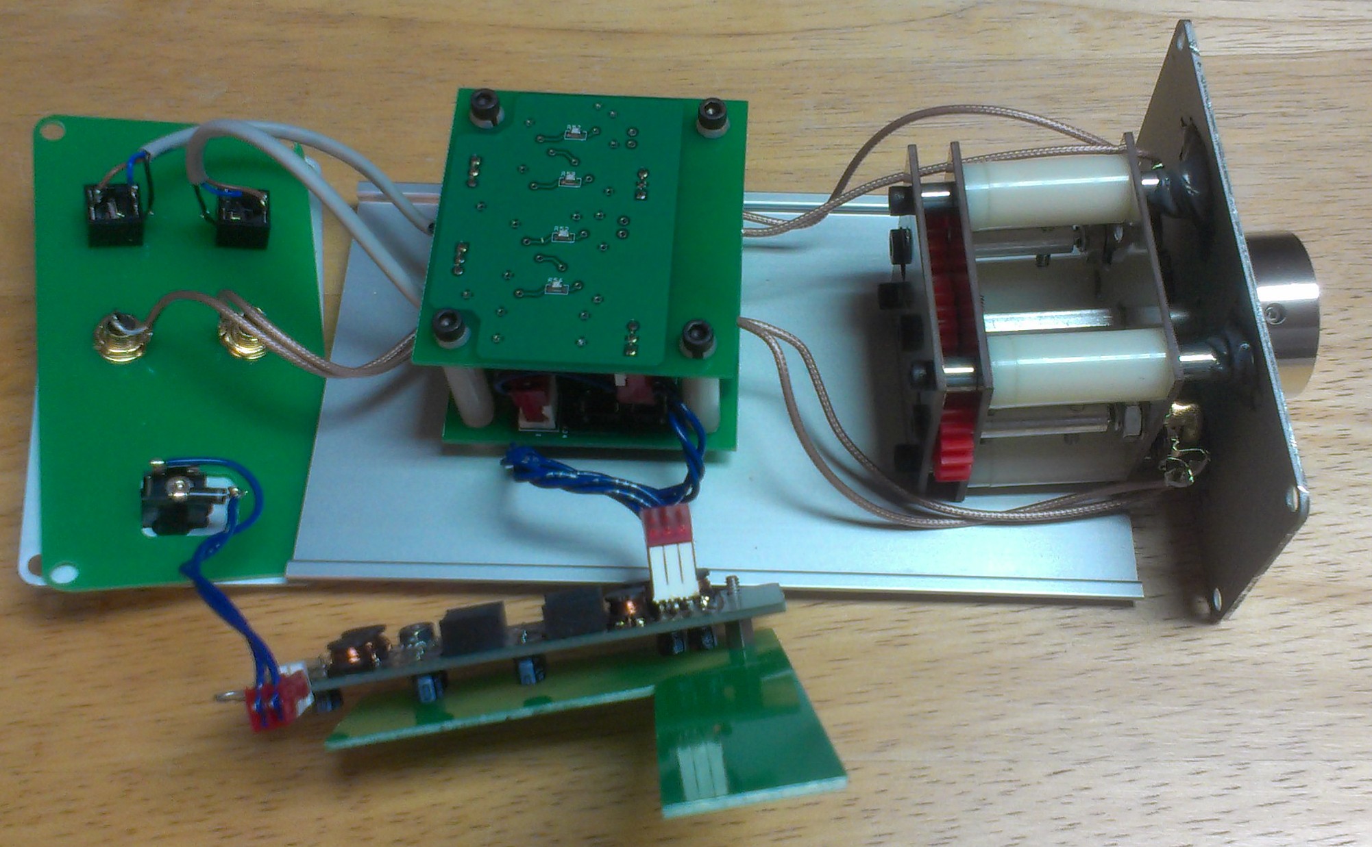

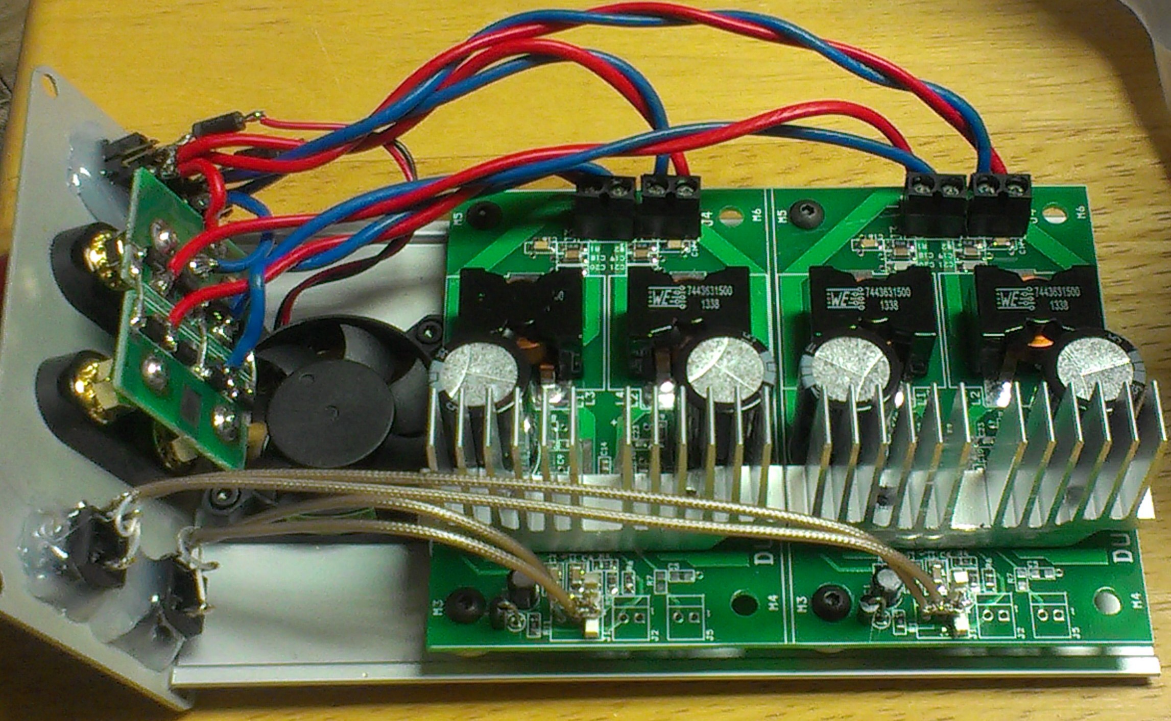

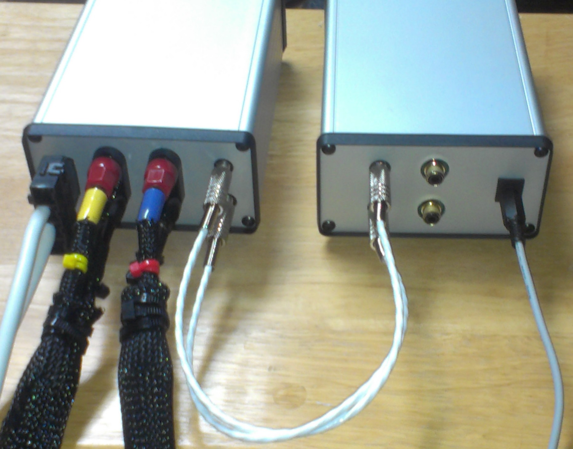

Some pix of my build.
Whoa... DUG. You built a mechanical gear drive to turn two pots with one knob?!? That is the height of cool.
Ya, pot stays at about 50% so I don't need to worry about exact tracking at the low end.
Actually use the Laptop (video player) volume control.
The clever man's 4-gang pot

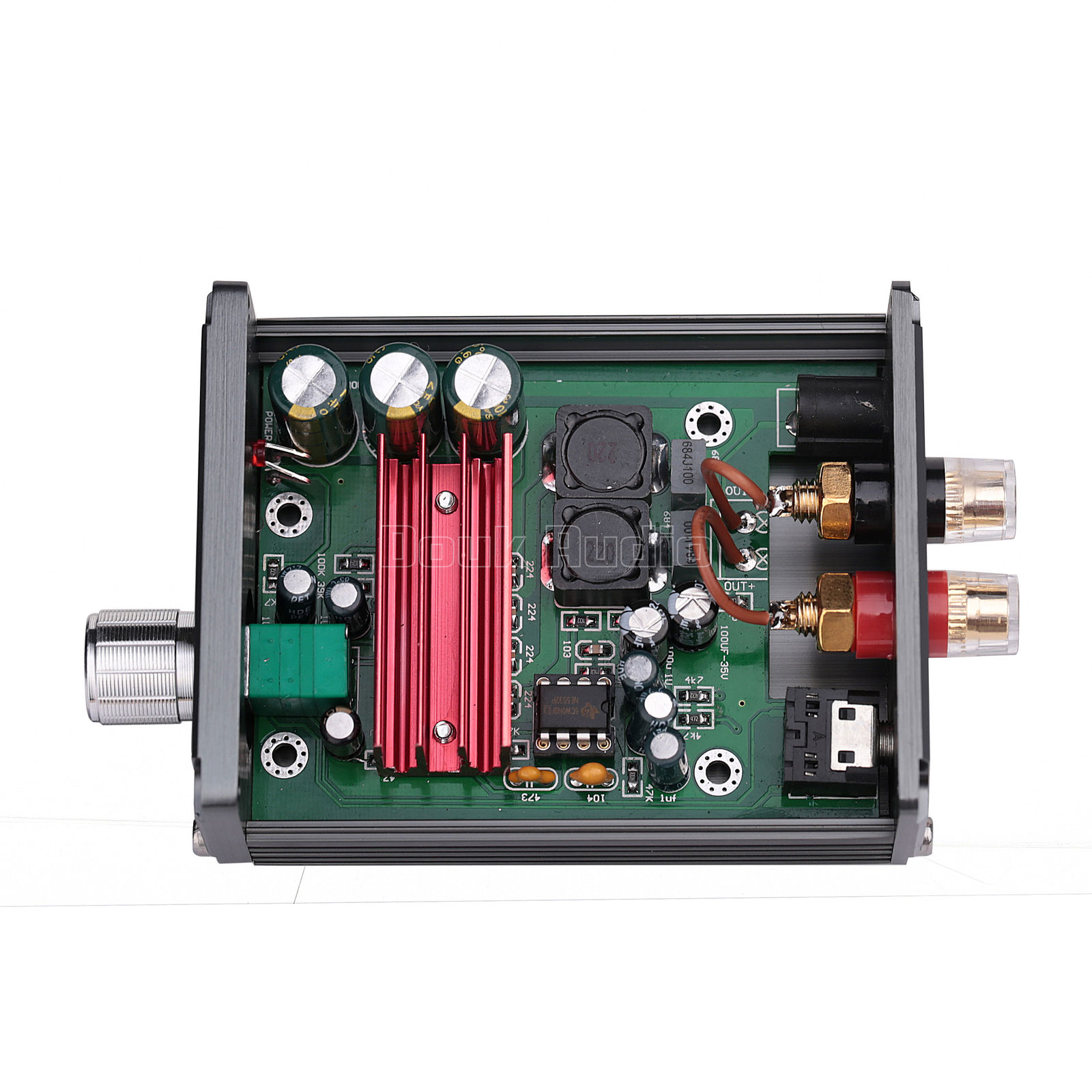

Picked up a couple of Sanwu TPA3118D2-boards, or well, copies of the boards it seems. All the components have different names even though the layout is basically the same as the original Sanwu board. On my boards you have to remove R6 in order to lower the gain to 20dB. I removed R6 (R27 for all of you with different boards) before even hooking the boards up to test them out.
I have to say that they sound pretty decent, especially since they're only about 2€/piece. One thing I noticed is that the background hiss differs greatly from different SMPSs. I assume this is the case for all of you?
My FSP-120 AAC is unfortunately the worst offender of them all, but some random no-name brand 15V 3A SMPS provides the least background hiss.
Can anyone recommend any mods to the boards? Maybe replacing the filter capacitors with low ESR caps?
