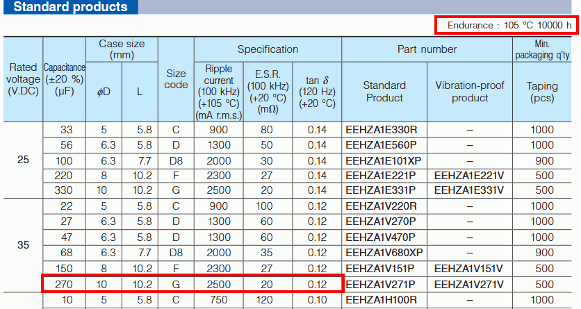

Nope, i'd choosen 2x EEHZA1V271P for the next board.
They will literally last forever.
The OS_CON SVPK do less ripple current at nearly the same price. From the measurements, bulk capacitor brand/type/capacitance isn't a show stopper if they're somewhat low ESR with 100uF per side. No need to spend extra dollars here.
The choosen EEHZA1V271P is just the best i can actually get for a reasonable price. No snakeoil whatsoever. The leak current also is much lower than for organic caps.
I.e. The 35SVPK330M 330uF 35V leaks 2.3mA after 2 minutes, while the EEHZA1V271P does only 0.01*CV = 0.01 * 270uF * 35V = 0.095mA. That's a huge difference when running from battery.

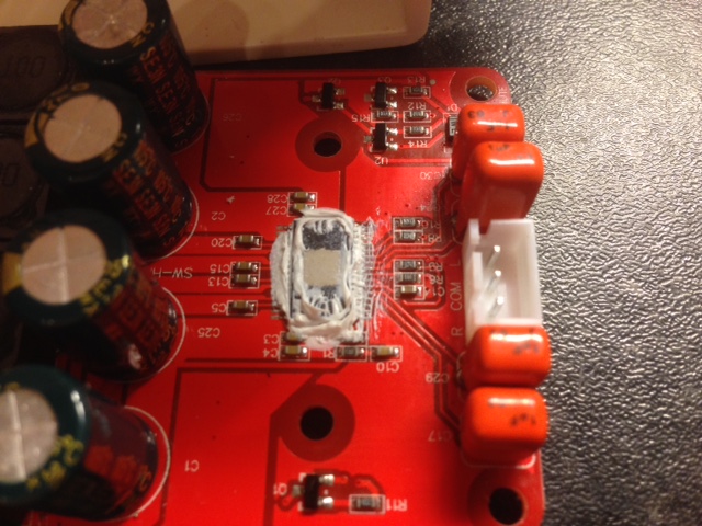

I have bough some time ago this red board from ayanhu81 shop on ebay.
DC 12V 24V TPA3116 Dual Channel Stereo 50W*2 BTL Mono 100W Audio Amplifier Board | eBay
I have seen some people in this thread using this board with satisfaction.
Well I experience quite audible hum and hiss. Hiss is audible only close to tweeters but hum is audible from the listening position.
Has anybody experienced this? Is the gain too high? Does anybody know how to change it?

Ok. Removed the heatsink and inspected resistors connected to pin 7 and 8 (39K and 100k). That is 39dB gain according to TI specs sheet. Removed both and replaced 39K with 4.7k and open (specs says 5.6k and open to get 20dB - didn't have 5.6k in smd format).
Hum is gone

This is how is looks like under the heat sink. The resistor are between the chip and the input socket. In this is group of 3 smd elements the bottom one is a capacitor, the middle one R6 is 39k and the top one R9 is 100k. As I said, the 100k goes, 39K gets replaced. And I am a happy camper.
