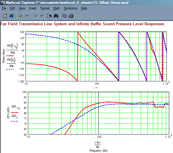

As the title says, I'm planing to build a pair of cheap fullrangers for really not-so-critical listening (background music, radio, TV, computer etc).
This cheap fullrange driver i'm interested in is a four inch driver made by "Right", and the model "FR100-8". Of course, the expected quality for this driver is propably very low, but so is the price too. I could buy these from my work (electronics repair&service shop) at price of about 5 euros a piece. So getting a couple of these just for testing and tweaking wouldn't really hurt my wallet.
I modelled the driver in MJK's "TL Offset Driver.mcd". As you can see, there are some dips and peaks in the SPL response.
Because I don't have good knowledge of transmission line design, I wonder if it could be improved? Perhaps the Qts&Qes values are too high, or TL parameters I'm using are not good?
The advertised specs:
Qts: 0,75
Qes: 1,00
Qms: 2,966
Fs: 107 Hz
Vas: 2,84 liters
TL parameters:
Line length: 35 inch
Driver position ratio: 9 inch
S0: 6 x Sd
SL: 1,75 x Sd
Density: 0,2 lb/ft
Please post comments, feedback is welcome! :D
With an Fs of 107Hz a 35" line is going to be too long. For example, the Tangband W3-871S with an advertised Fs of 110 Hz works best in ~16" line. Tuning a cabinet below the driver Fs is not beneficial unless you plan on adding heavy EQ. Also, there are some numbers missing such as port radius, length and position and it's going to be difficult getting meaningful models without the driver BL and Re measurements. Overall, I don't think this is a good candidate for a TL but as you pointed out, the price was low enough to take a chance.

What are all the specs you are using? Do you know Re, Le, Sd? The IB response (dashed line) is totally whacked for the specs you published so your sim is useless.
Longer TLs perform much worse than shorter TLs. The lower limit for pipe frequency should equal Fs.

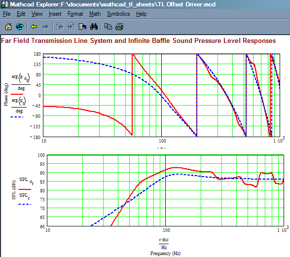

I disagree! Longer ones are inherently better damped, and with less stuffing density, a 'good thing' when it's a FR driver. That said, 35" is way too long for a reverse tapered pipe since this driver really shouldn't be tuned <~59.3Hz according to T/S. Just running the numbers using:
Sd = 45.6064 cm^2 (assumes 3" effective dia.)
Re = 8 ohms
Le = 0.6 mH
BL = 3.512 N/A
pipe Vb = ~0.71 ft^3 per T/S
I get:
L = 25.25"
eta = 9.42"
SO = 90.48"^2 (~12.8*Sd)
SL = 6.05"^2 (~0.856*Sd)
density = 0.25
I think you underestimate the low end performance of a TL that is sized according to the theoretical calculations.
Looks like I still have much to learn when it comes to designing loudspeakers! There was large peak at around ~100 Hz in my design, and I thought I couldn't make it any smoother easily. That's why I just kept increasing and increasing the line length until the response had weird shape... Hopefully I learnt a lesson here?
I certainly agree: compared to my TL attempt, the response of GM's design looks really better in a shorter line length... Thank you for your help! :) I will post the SPL response picture of your design here.

OK, these aren't required to do basic T/S box designs, but certain assumptions can be made for more elaborate programs such as MJK's WSs. 'Re' can be a common one like 7 ohms for a nominal 8 ohm driver, or for that matter you can just input 8 ohm, same for 'Le' or input zero. 'Sd' can be a typical value from another driver of the same frame size. 'BL' is another matter altogether since its a relative number based on several specs and what was ruining your plot since the number you used didn't match up with the Vas, Sd, Re, Qes you inputted, so you either need to use a program that will calc it for you (I believe the WINISD Pro freeware will, among others) or do like me and load this formula into a spreadsheet to calc it:
BL = SQRT((rho*(c*0.0001)^2*Sd^2*Re)/((2*PI*Fs)*(Vas*0.001)*Qes))
where for MJK's WSs:
rho = 1.21
c = 342
While the FR may not be the most accurate, it will be 'close enough' to decide if you want to build it or not.

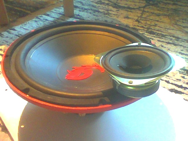

These two fullrange drivers arrived to me. First thing i did was measure Re with multimeter and Sd with a ruler. Got values of 7,6 ohm and about 55 cm2. These drivers have foam surrounds and about 5 mm of one-way cone travel.
I tried to calculate BL with WinISD, and got a value of 5,6. I changed the new measured/calculated values to "TL Offset.mcd" and it showed different results. Mainly a bit deeper bass extension, but with some lower sensitivity.
I found some ~75cm long cardboard tubes with 12 cm diameter and 2 cm wall thickness at our garage. I decided to use those as testing-T-Lines. Sound is really "honky" because there's is no any amount of stuffing inside... :D
Afterall, I think that the overall sound of these is quite bad. I'm no expert, but I think the upper midrange/lower treble sounds too loud and sounds like those "1500W PMPO" plastic computer boomboxes. My extremely bad "enclosure" setup might also have something to do with this. :whazzat:
But again considering it's 4 euros... I attached a "david/goliath" pic of it :rolleyes:
