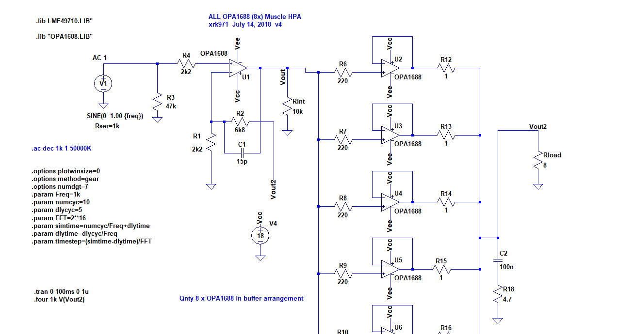

If I did this right, the 2k2 (R1) and 6k8 (R2) presents a 1660R impedance to the negative input, so we need to match this impedance on the positive input. However, when accounting for the 47k (R3) to ground, a value of 1720R for R4 is needed to present a 1660R impedance to the positive inout. The sim result was unchanged. I tried minimizing the impedance by making the feedback 680R and the ground shunt 220R, this effectively makes the 47k unimportant and a 166R R4 was used. The sim for this actually showed distortion increasing from 0.000063% to 0.000068%. Doing this also makes the output effectively driving a 166R load under full power - quite a bit of dissipation and a much larger power resistor would be needed. I think I will keep it at 6k8 and 2k2 with 1720R R4.

Just to demonstrate how detached from the reality those distortion simulations are.
I took your schematic from the first post
691428d1531366246-cheap-chips-opa1688-low-thd-muscle-amp-muscle-amp-sch-png
and optimized thevalues. Also I used only 4 opamp in parallel at the output (which should not work in my favor...)
...and I'm getting distortion plots like this for 3Vrms, which is pretty much 8.5Vpp on 45Ohm load (plot is in dBc)
instead of what you were showing there before:
691431d1531366246-cheap-chips-opa1688-low-thd-muscle-amp-muscle-amp-8vpp-50ohms-fft-png
Do you still think any of those models can give realistic THD simulations?

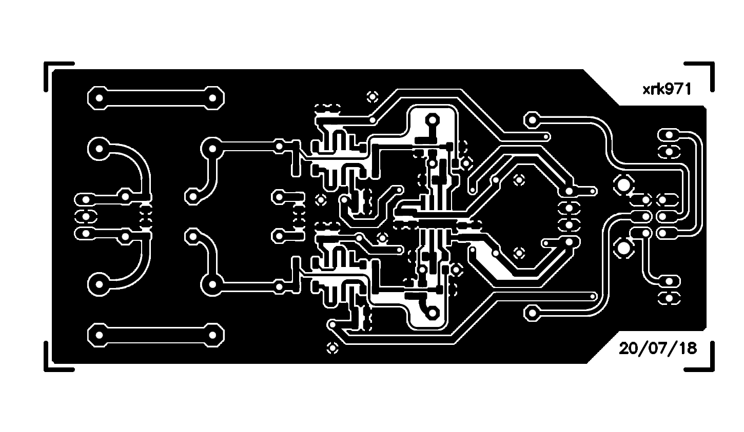

Here is a DIY'able single-layer board layout for a pair of paralleled buffers in SOIC8 that JPS64 made. It includes some nice low ESR caps (390uF 20v OSCON + 10uF X7R + 0.1uF X7R for both rails at the power supply pins) and also the option to cap-couple the input or output.

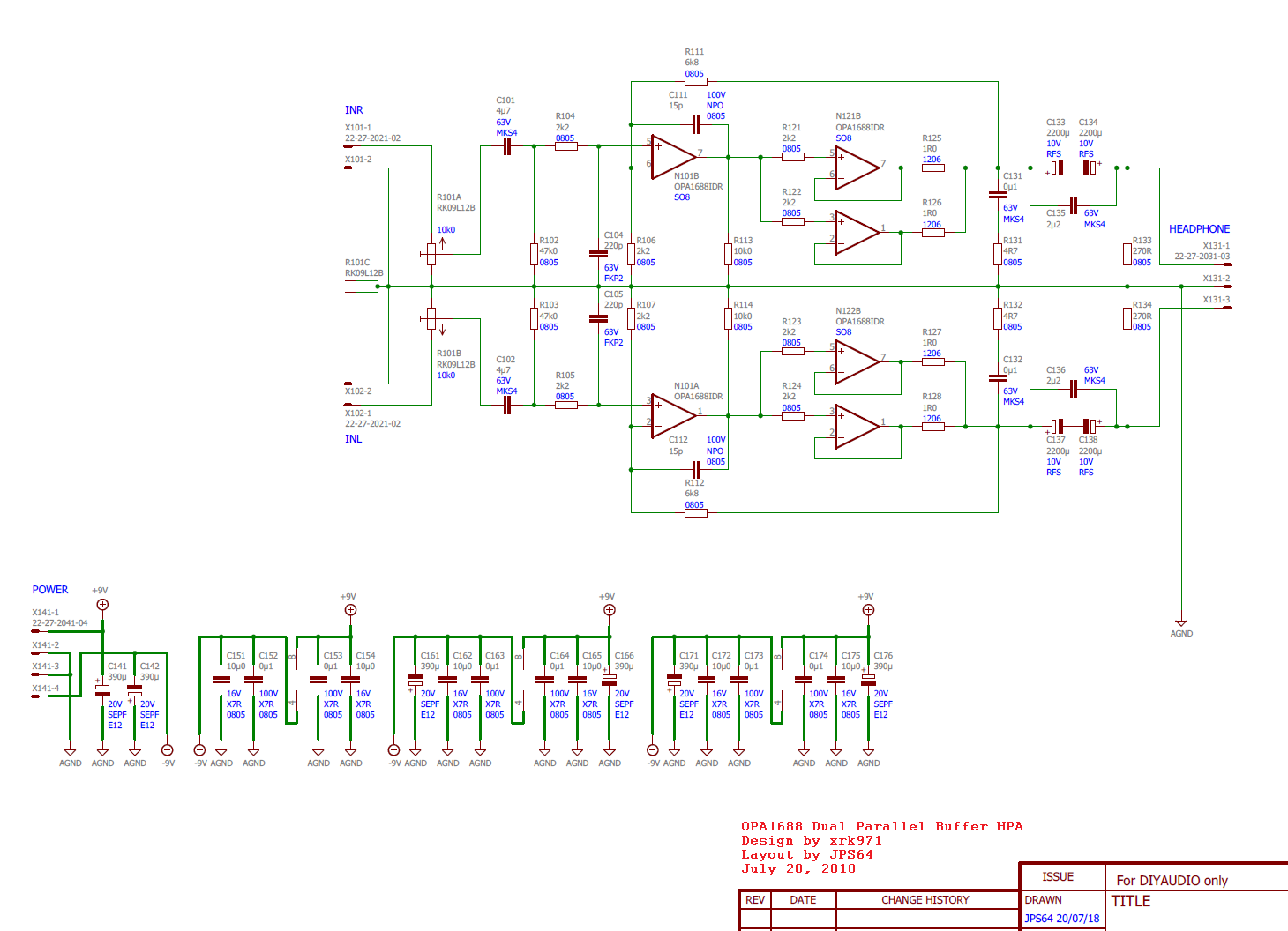

Schematic (note, for balanced opamp inputs (w/ pot at full volume) use R104 & R105 = 1.72k, and R111 & R112 should be high quality metal thin film, or carbon film, but not thick film):
attachment.php
Files below: schematic, copper etch layer, and placement guides for top and bottom.

I can see that due to limitation of a single layer layout it is a bit hard to optimize position of the "output stage" supply rail lines. Since this is essentially a class B stage, those rails will be carrying rectified load current, which will induce even harmonics in signal tracks. For circuit like that it can be easily a limiting factor if it's driving a low impedance load. Using a twisted pair of a hook up wire to bring supply to those opamps can help to avoid this problem.

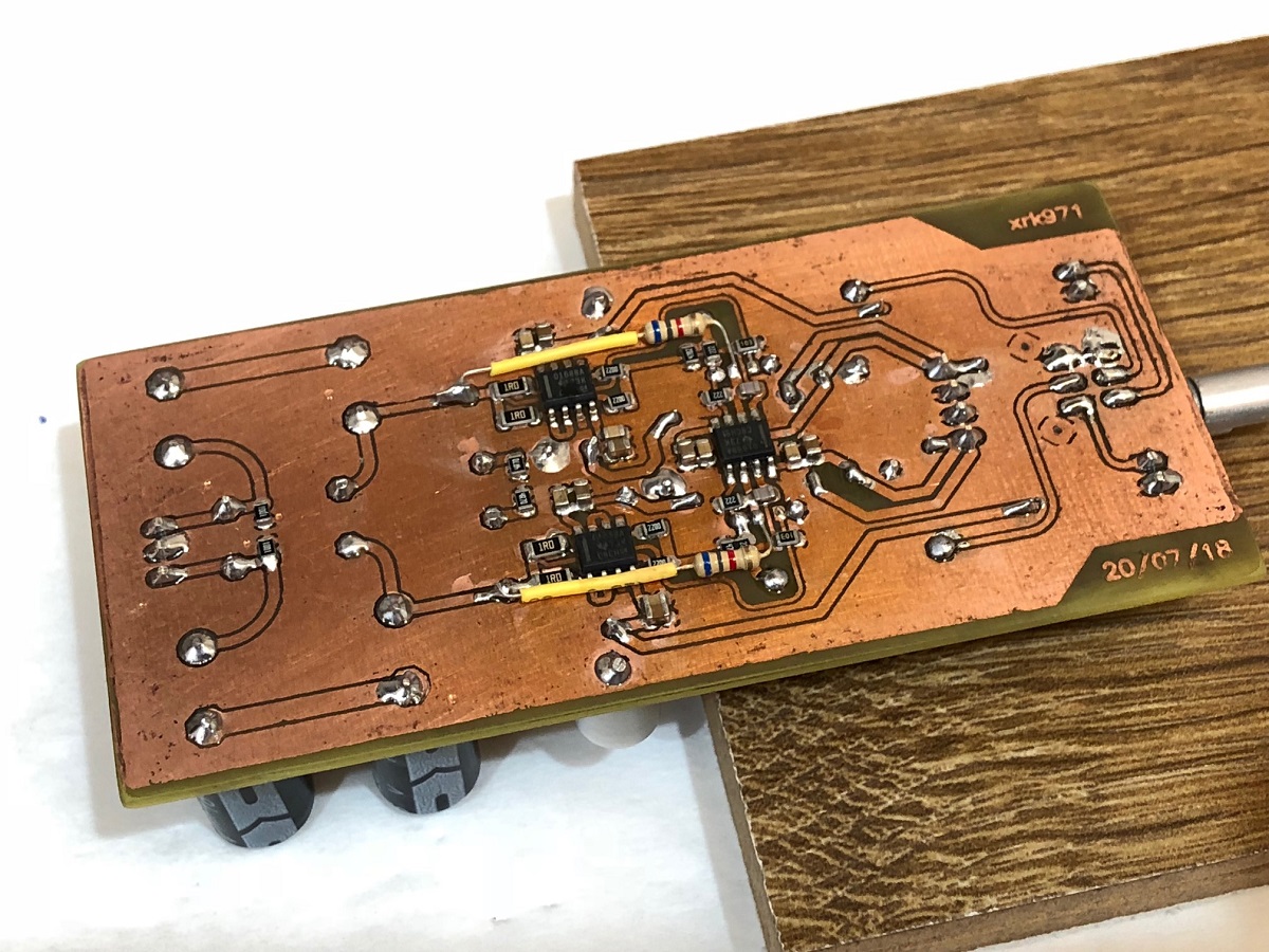

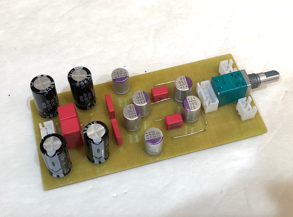

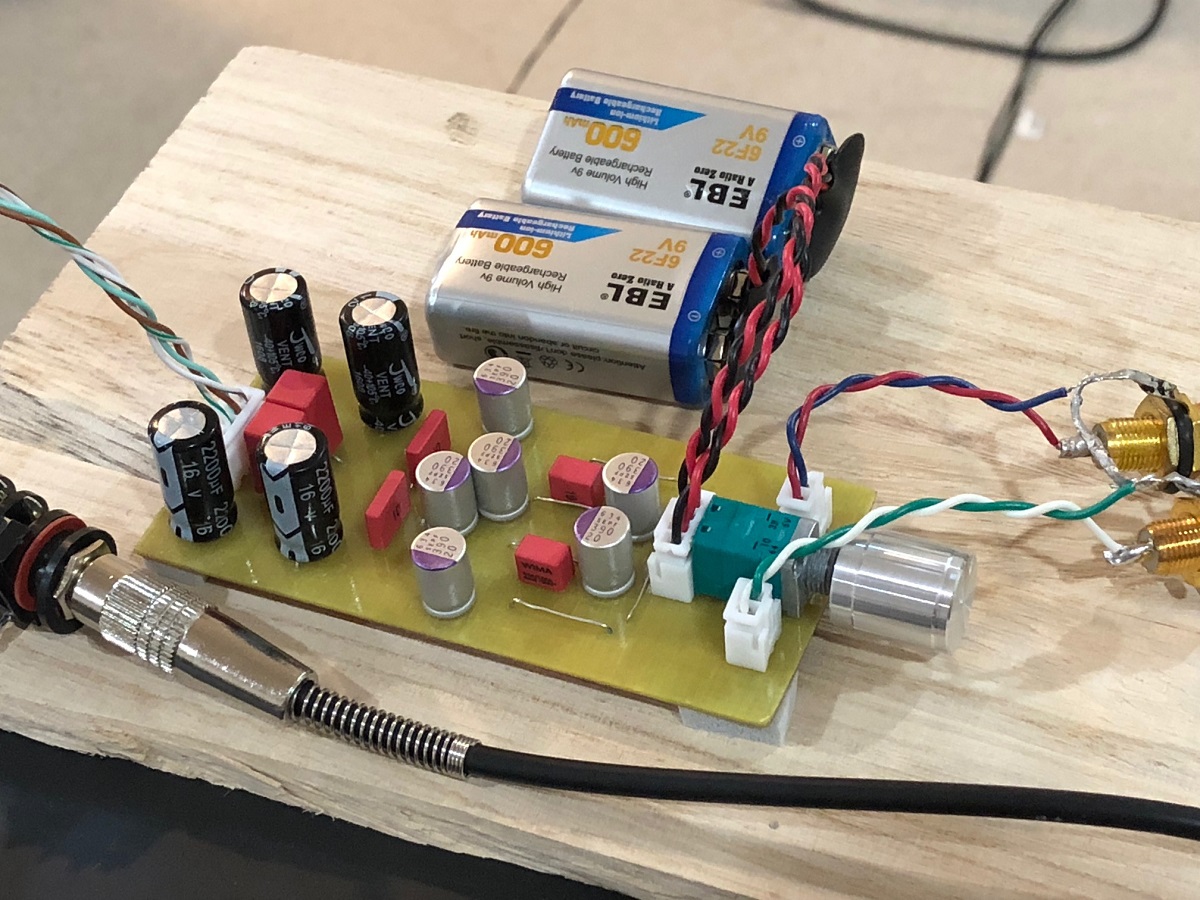

I finally built the 2x Parallel Buffer OPA1688 HPA prototype with a hand etched board. I had some solder bridges with the skinny traces that went under a resistor that took a while to debug. I finally added a strip of Kapton over the under-passes to avoid problems. Will measure later, but listening to it now and sounds very good. Listened to a few tracks on headphones and the HE400-i's have no trouble being driven hard and loud. Using as a preamp on my Alpha BB speaker amp now.
attachment.php
attachment.php
attachment.php
A big thanks to JPS64 for a super layout!
