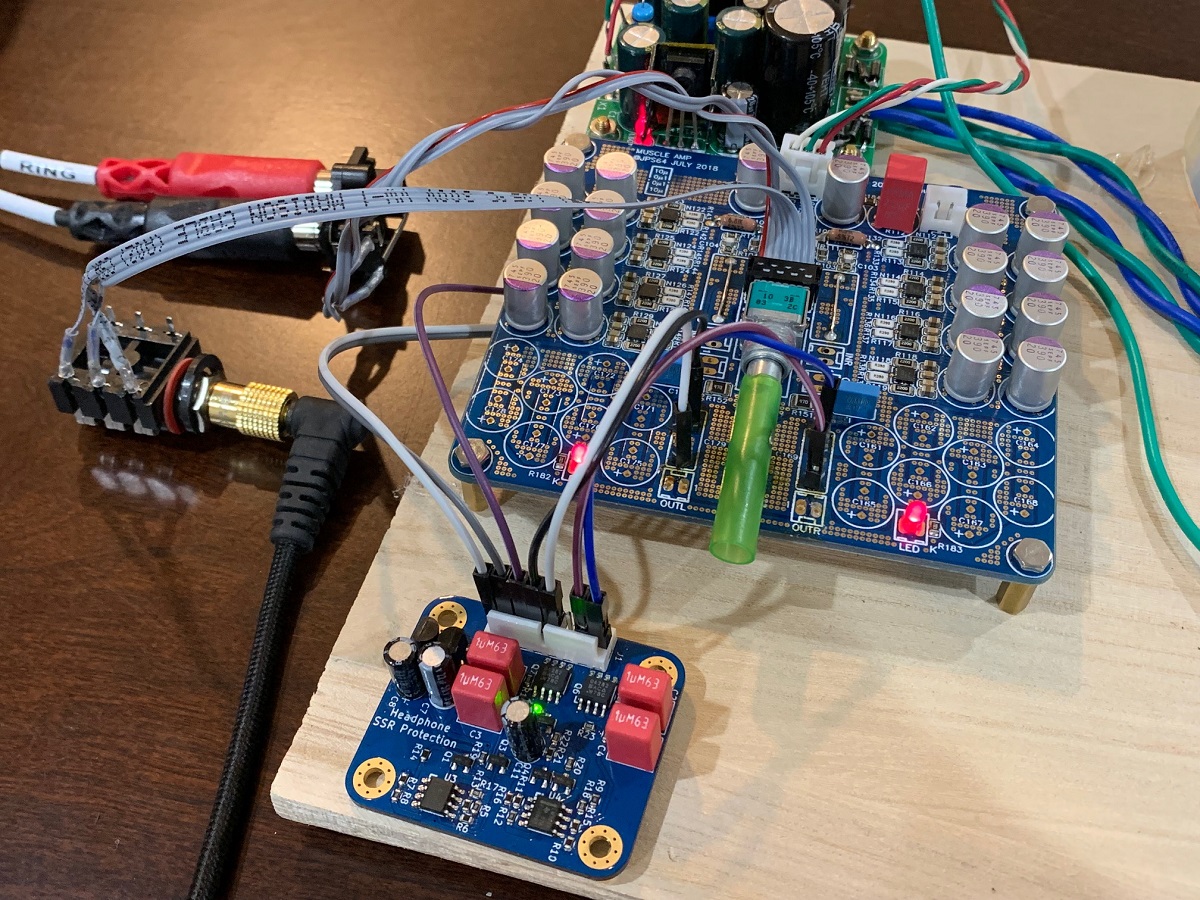

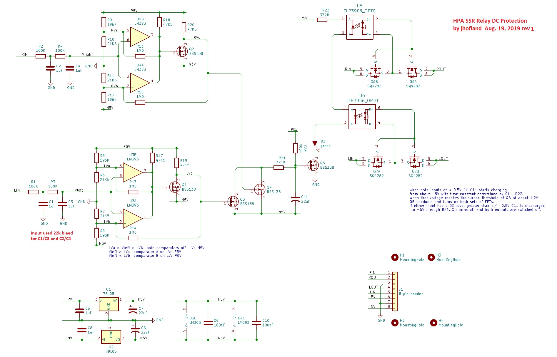

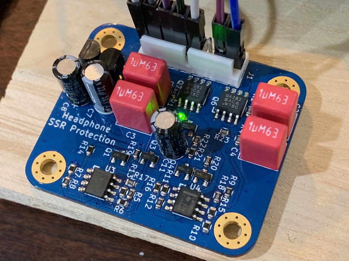

Jhofland designed this handy circuit for protection of DC-coupled headphones using MOSFET solid state relays (SSRs) driven by opto-couplers. Here, a comparator is used to check for DC offsets > +/-500mV after a CRC low-pass filter. I built a verification test circuit and it works very well. Turn on delay is about 2.5 seconds. I tested DC offset shut-down by touching the +/-5v rail from the regulators to the input pin and it shuts off quickly and recovers when the offending DC is removed.

Schematic:

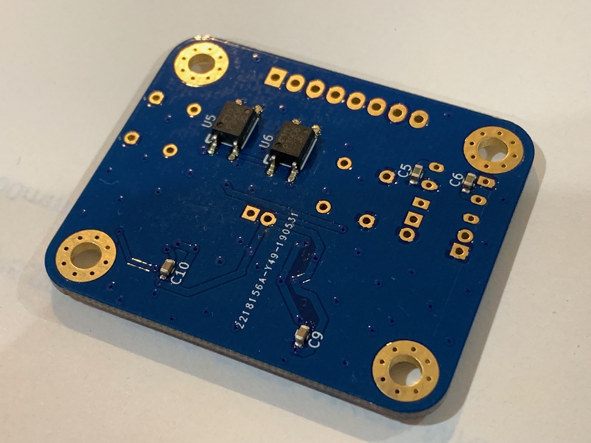

Thanks, Abraxalito. That part looks handy - Rdson is a bit higher than the one we are using at present (not sure that matters as much for a headphone). Yes, U5 and U6 are on the underside:
attachment.php

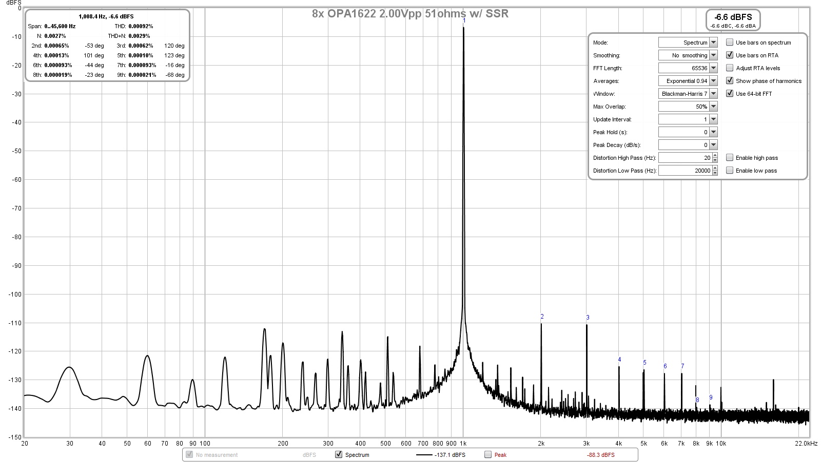

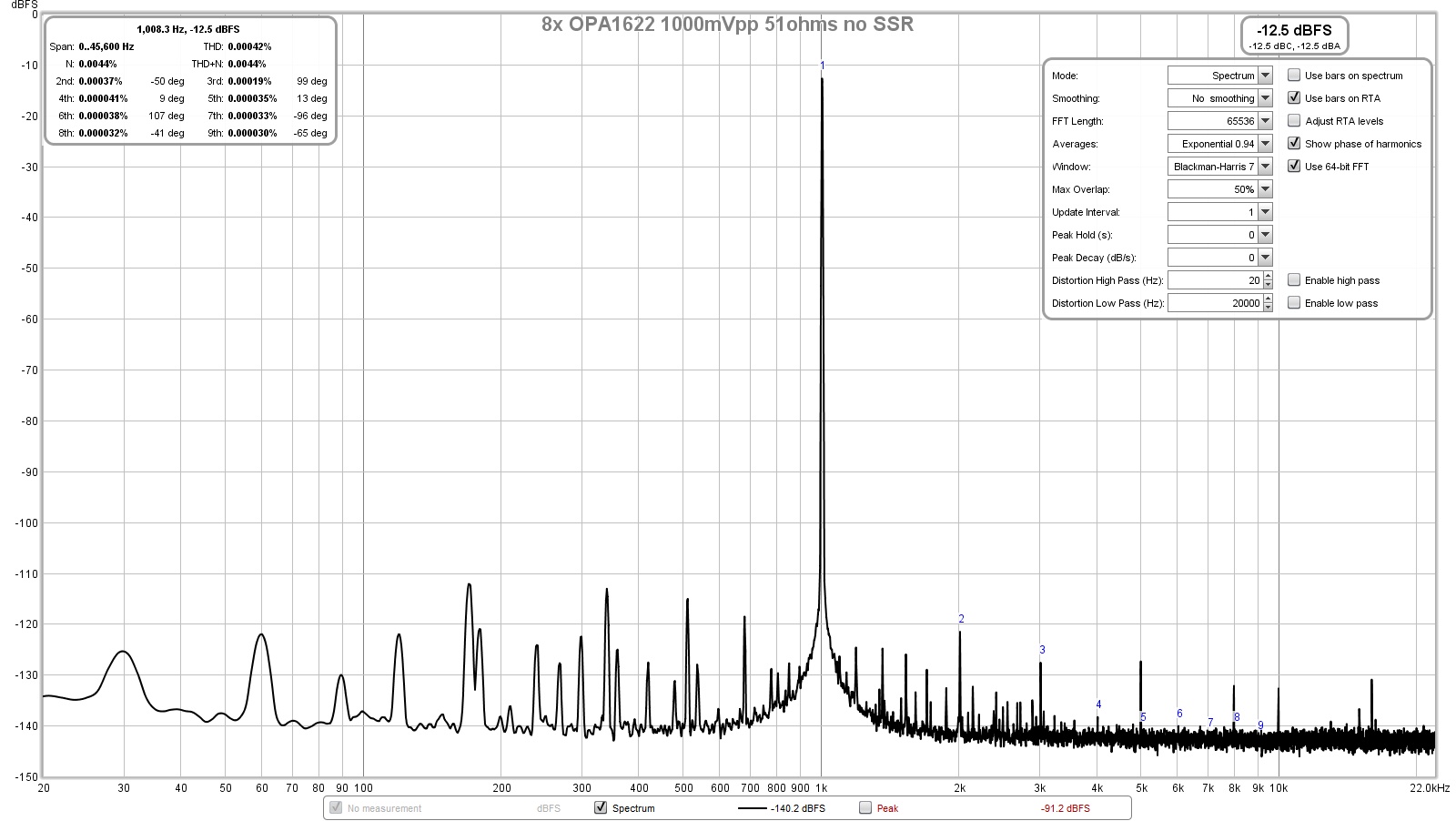

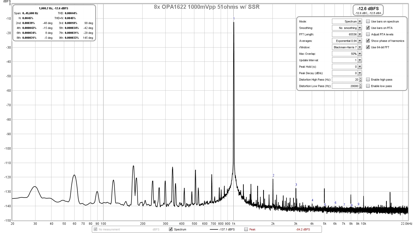

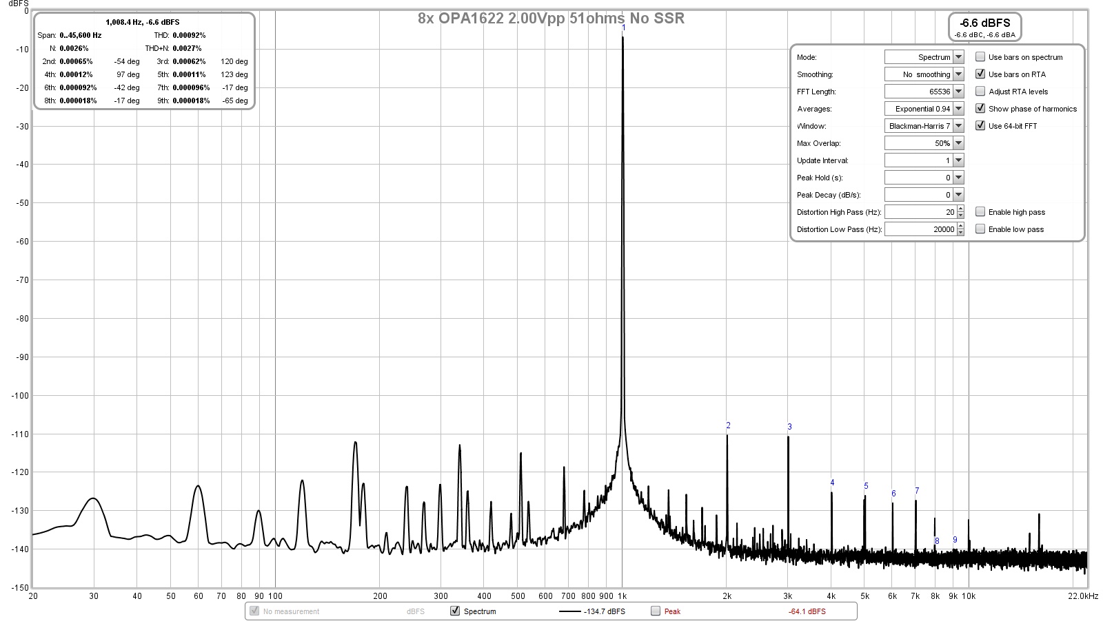

Just took some FFTs with the SSR in and out at 1.00Vpp and 2.00Vpp into 51ohms using the Akitika 2ppm 1kHz source and a Focusrite Solo Gen 2.
1.00Vpp into 51ohms, no SSR (4.2ppm THD):
attachment.php
with SSR (4.4ppm THD):
attachment.php
2.00Vpp into 51ohms, no SSR (9.2ppm THD):
attachment.php
with SSR (9.2ppm THD):
attachment.php
Yes, I noticed that too - there are one or two parts in the family with slightly lower Rdson but they're more expensive and Mouser doesn't have them in stock. The difference is 20mohm for the two Vishay FETs in series vs 30mohm for this Toshiba part (typicals). To put the numbers in context, a 30mm length of 0.5mm wide copper trace has about 30mohm resistance.
Incidentally if you were to revise the board you could save on space (and probably on cost too) if you changed the 1uF film caps to X7Rs. They seem not in a critical position, just doing low-pass filtering prior to the comparators.

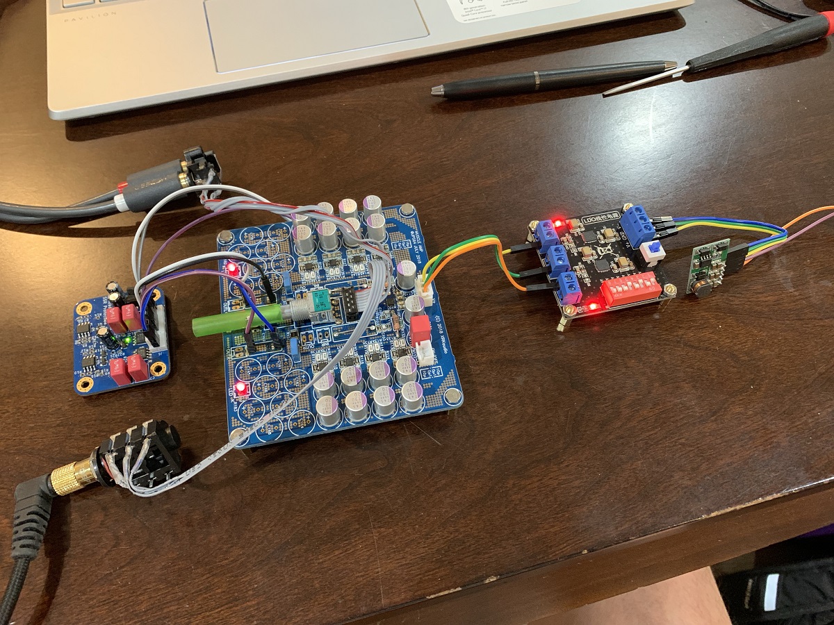

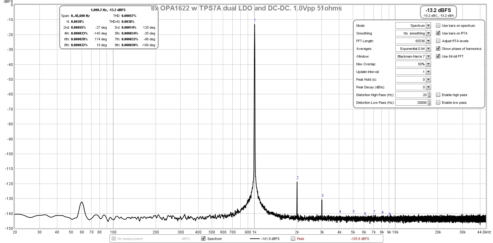

Testing out the 8x OPA1622 amp with an eBay dual TPS7A low noise regulator board set for +/-18.5v and an eBay +/-24v DC-DC step up. All powered from 12v Pb-acid gel cell. Source is 2ppm 1kHz Akitika oscillator, and sound card is Focusrite 2i4. Signal out of amp is adjusted to be 1.0Vpp into 51ohm dummy load. Setup is not the cleanest, so picking up some very low level -120dB 60Hz. But overall, the amp with this PSU shows a -130dB noise floor and 5.7ppm THD with dominatn H2 and about -12dB less H3 and nothing else.
