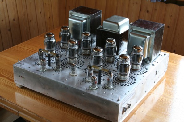

I know Ally smells orrid' and messy/black when worked on but I use ordourless white spirit (or lamp oil) for drilling and punching without any clogging problems. The sag problem ? brace it.

Aluminum is my preferred chassis material. It's easy to machine, easy to get, and reasonably priced. I have never had trouble painting it using ordinary spray paint.
I use some A-9 aluminum cutting oil when machining it. That's the key. Cutting fluid. It makes life much easier. In the past, I've used denatured ethanol alcohol (with proper ventilation). That works too. The same goes for other materials - use proper cutting fluid!!

As Rich says, use Methylated Spirit (thats what its called in the U.K.) for machining Aluminium (Denatured Alcohol in the U.S.A., Spirits in Europe). Makes a world of difference when you use the correct fluid for cutting.

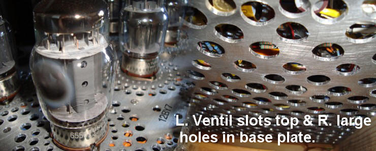

Copper tarnishes readily and one is apt to use a polish that may be vapour corrosive to tube pins especially where silver is around. Another drawback in polished state is material that re-reflects heat to the o/p tubes (if real wattage is being used). This is generally for most shiny materials unless a crop of ventilation holes is used (as I do)-
Anyone who works brass and copper on a lathe knows too well the binding properties of both non ferrous metals.
When designing physicals for the larger power amps with multiple tubes, heat dissipation is important. Generally I use the GEC 4 inch centre to centre rule with hot side of anodes at right angles to each other. A fan could have been used but encourages dust and some noise. The chassis becomes rather large and serious underneath bracing is unavoidable. In this pic, a conservatively rated high performance 100+100W amp, the iron weight is considerable, 65kg or 143 lbs. same as my spouse !

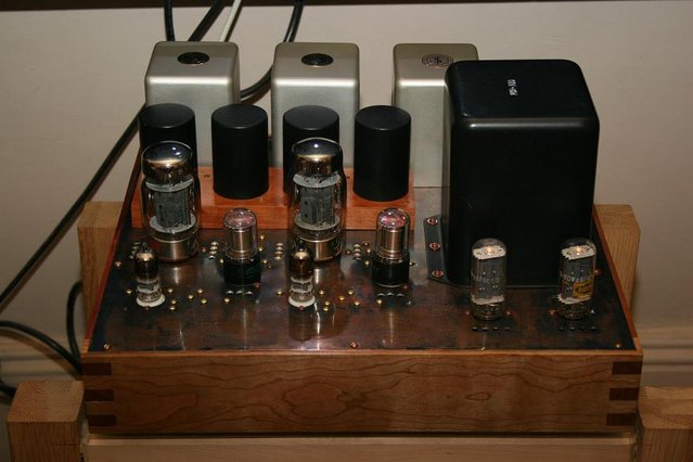

I made a copper topplate for my E-linear amp, as I've showed here once or twice before. I epoxied it to a thicker piece of aluminum (the epoxy guards against reaction between the two). I patina'd the copper and finally finished with rennaisaince wax.
I think the wax might be a somewhat better way to slow down the reaction/oxidation of the copper while not providing too much reflection. The wax doesn't completely seal the surface but it does slow it down a lot.
Experimenting with patinas was fun but did take a while.
I'd like to do a green or blue patina at some point in the future.
