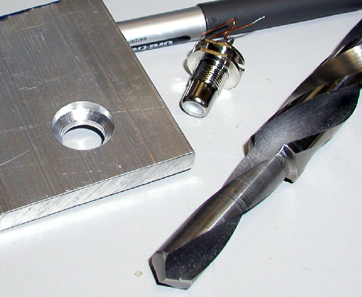

That's what I did today. I'm using 1/4" panel and using this piloted drill I bored out the recess for the nut on Cardas RCA jack.

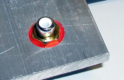

Here's how it looks after installation. The nut is slightly recessed and it actually looks better this way.
So it's up to you guys, what thickness to use for rear panel. Personally, I would go with with a thinner plate. If someone IS using short Cardas RCAs, I can make similar recess as part of my special services (free of charge of course😉

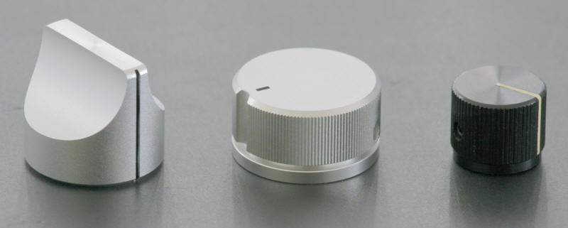

Here's a photo of some nice knobs I have. The two on the left are from a local shop, about $14 CAD apiece, they are made in Japan and beautifully machined. The middle knob is about 1.25" dia, and has two set screws (much better than only one set screw).
The knob on the right is a Kilo knob, 0.75" dia, as that was the largest size digikey carried... again, it has two set screws. Kilo also makes knobs in the same style as the one on the left and the ML knobs, though I think I prefer the actual ML knob over the one in this pic and also the Kilo version... the ML has nicer proportions.
I just measured them with a caliper. The far left one is 28mm and the middle one is 29.5mm dia., so about 1.10" and 1.16", respectively.
I bought those about three years ago, and they've been sitting in my parts bin, awaiting a worthy project. 😀 I'll have to go visit the store again and see if they still carry them, and at what price etc. Perhaps the owner would be willing to sell a bunch, though I'm not sure I'm up for another big group order any time soon... 🙄
