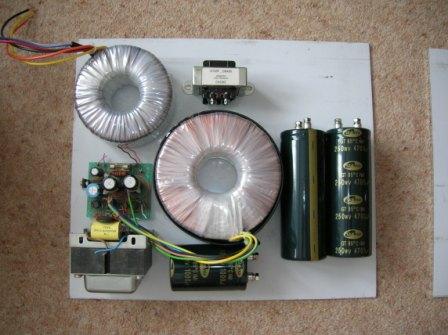

Why are you hanging your transformers upside down? I realize maybe for ease of access and lift off top plate and BINGO! it is all there without any wires restricting movement, but why not place the power transformer across a plate/bracket/square tube/angle on the bottom? Or even mounted on a plate attached to the back of the chassis?
It will relieve stress to the top plate significantly (that is at least 20 kilograms for the all the transformers shown in the picture?). You can use screw in posts or jacks to connect or disconnect the wiring to the top plate's components. Just saying again, as an option.
And the heat will be an issue. You might be better off just with a small opening louvered or open as mesh to clear out any excess heat in the chassis. And keep the cutout for the tubes.

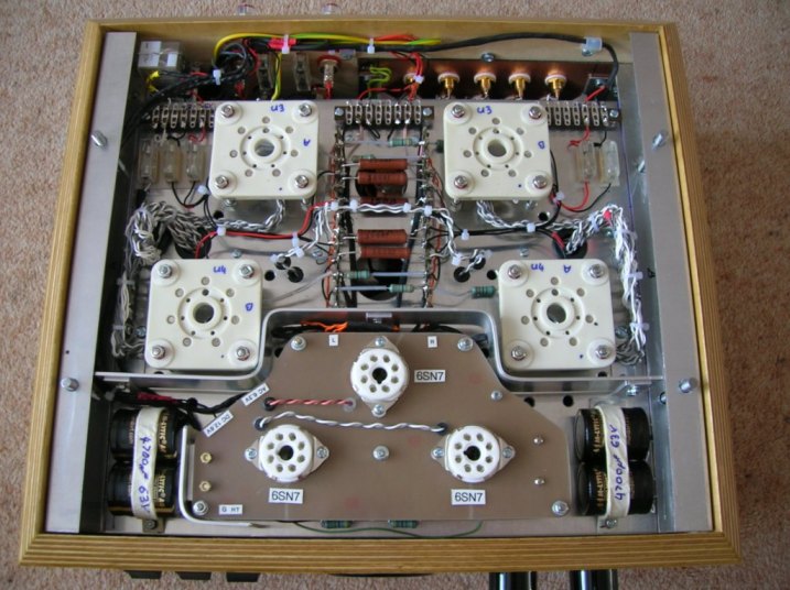

Hummmmmmmmmmmmmmm,
Power Tx by the driver tubes?
The power supply seems to be spread across the top plate..

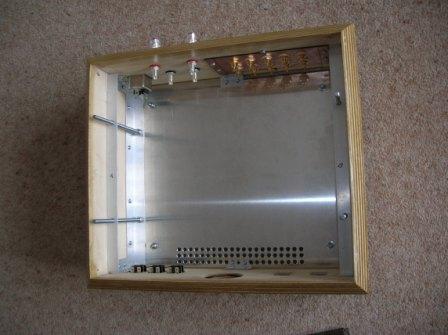

Why don't you hinge the mounting plate and fix the bottom plate and mount the transformers on the bottom?
This is what I did with my OTL..Pic (Sorry for reposting photos its only way I can show you)
the aluminium is 3mm supported with angle using wooden sides..I have 2 toroid and one standard Tx plus chokes all on the bottom plate..
Middle plate acts as a shield and also holds the wire and components.. If your only running EL34..you could build standard..the heat should not be an issue..
The Mod from the pic was to remove the aluminium all along the top plate and just use supports. (reduced heat transfer from top plate to amp support plate)
For EL34 it should be a lot easier.. I used metal self tapping screws into the wood to hold the aluminium angle they cannot be seen outside the chassis.

M Gregg, my goodness... THAT is some awesome cable management -- where did you learn it and how many hours did that take you? Makes my very simple light sabre build (lights up, has a speaker, and and makes an oscillating sound housed in brass fittings) for my son look like rat's nest.

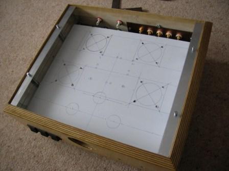

But to drag this back onto topic, did you consecutively map both the bottom plate with the top plate for the hole placement? Or did you have a top plate and measured and adjusted afterwards?
I am asking because of the large sockets (I am guessing 6C33) can be mapped easily enough to the bottom, but the gain tubes with the separate plate in your picture? Those must have been trickier.

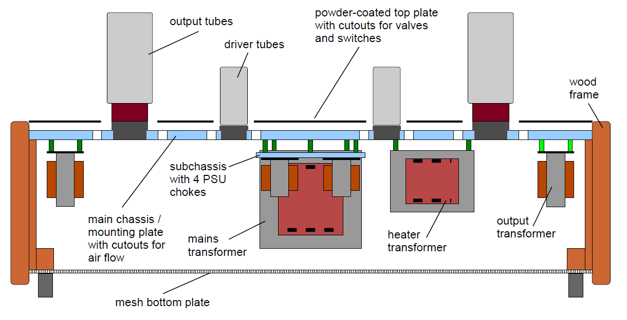

Hi Rundmaus, I wondered where the holes for the transformer wires were in your top cover (on the other thread). The view you posted here doesn't show how far back the power transformer is from your drivers - might be part of the concern expressed about the power transformer being "close" to the driver tubes.
Putting the power transformer inside will add to the internal heat of the amplifier, any idea how heavily the power transformer is loaded in your design? From what I remember of your top-plate design, you've got lots of ventilation holes and slots.

Quote did you consecutively map both the bottom plate with the top plate for the hole placement? Or did you have a top plate and measured and adjusted afterwards?
I laid the components out on cardboard to get the smallest size I could then cut the metal. I put the top plate and the amp plate on top of each other.
Then drilled the locating holes for the all thread. Then marked out and drilled a pilot hole for the centers of the pre/driver and 6C33C's..Then cut the PCB and placed it under the bottom plate and drilled the pilot holes into the PCB. Then drilled the mounting holes in the PCB and lined up the PCB pilot tube holes and drilled the chassis from the PCB mounting holes, then built the PCB.
Wiring= engineer..It took a while..

Hey there,
Ah, I understand your concerns regarding the power transformer placement. The simplified side view does not show everything. In fact, the power transformer is as far from the driver circuitry as possible.

Power Tx by the driver tubes? The power supply seems to be spread across the top plate..

is about 10mm from the tube bases on the Power tubes..The pre tube bases sit just below the top plate about 3-4mm.

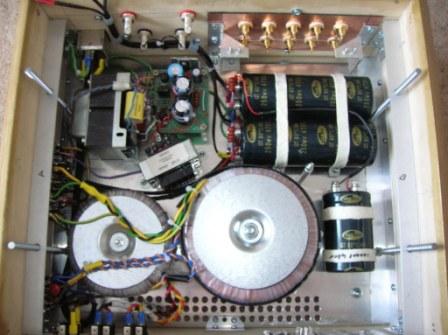

The gain with putting the TX's under the amp plate is it compacts the design. The Air is drawn from the front of the chassis through the holes as shown..then travels across the power transformers etc and is drawn up into the top plate at the back<<the amp support plate is not all the way across the chassis (front to back) so air flow takes the form of a sidways "U". the shield for the Pre-amp is supported just off the chassis and is about 2mm from the top plate.
There are two 20mm holes under the PCB to allow cool air from the vent holes in the bottom, so the preamp tubes get cool air and vents through the top plate via the tube holes.
The Power tubes draw the air through the amp...any hot components are used to help drive the flow so are placed to drive up to the power tubes.
Tube amps can be big..so I think the trick is to get it as small and functional as possible. And still keep it cool..

M. Gregg,
did the photo disperse your concerns with the power supply layout? I'm not sure if everything is visible clear enough.
Back end of chassis, in the middle, main power transformer. In front, chokes and rectifiers for one channel. Right of the chokes, 1st and 2nd C filters, supplying output stage. Right next to them, output stage with the cathode resistors and bypass caps on the right edge of the chassis.
In front of the chokes, RC filtering for negative rail, right of it CCS and driver stage. In front of the driver stage, 3rd C filter supplying driver stage. Front right corner is the output transformer.
The relay on the left side of the test board turns the B- rectifier on as soon as the B+ rail reaches approx. 80% of design value.
