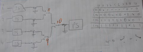

Hi, the relays are all just routing the guitar signal so any relay should do the job. I have ordered a load of goodsky 5v ones from banzai music. The idea of loading up the heater chain is a good idea so i'll try that and see how noise is affected. Most designs ive seen use transistors to drive the relays - will this keep the current draw down? I have considered an auxilary transformer but have very little space left in the chassis - if i find one small enough then that would probably be the best bet.
For channel 4 all 10 relays are on, or if its wired the other way round then channel 1 will have all 10 on. What you describe there is seeming to be the best method - I've noticed a lot of amps restify after the heaters so it can't be that bad! What do you think about driving each relay with a transister - useful or pointless?

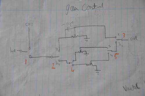

It might.. depends on your switch logic, but it won't save the total relay current, just lowers the control switch current. I can't imagine all relays on, care to share ? Maybe with the collective brainpower here, they can help simplify the switching diagram/logic...
I'll attach the photo's in two separate posts. Relays 6 and 7 just tap off from the preamp at different points. Apologies for the poor drawings - the volume and gain controls are also wrong so ignore them!
The image on this page adjusts the gain for each distorted channel or taps off to ch1. The second image is for the other end of the circuit to select which channel is going to the phase splitter.
On the right of the second image is a truth table to show which relays need to be on for which channel to be active
