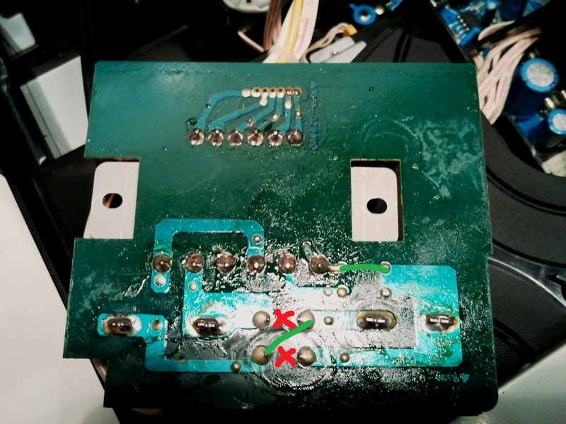

Took a picture of the insides and power supply area. It looks like it's easy to change voltatge but since I have 0, ZERO, ZIP....technical knowledge I thought I'd go the source and see if you guys can confirm it's doable, what to change/solder exactely (I have an intuition since I can read!!) and if this is the type of solder job I should take to a professional technitian.
I'd love to do it on my own but don't want to screw up my almost vintage CD Changer.
Anways, thanks for the help and advice you guys might be able to provide.
Pere,
PS: pictures of the voltage connections
Looks like there is a posibility to change those jumpers - if the transformer has two primary windings. Only looking under it can tell.
Or it can be taken to a shop that rewinds transformers to have the primary rebuild for 230V - easy since it is separated from the secondary windings and those won't be disturbed.

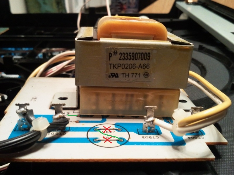

At least looks like is just one transformer, some Adcom players had two.
Hi SoNic_real_one,
Thanks for the repply.
Here are some more pics of the transfo. One from the bottom plate as requested.
Thing is, .... now it doesn´t even work as I put it back together and no power whatsoever. I thought I was carefull...but maybe I touched something.
Anyways, here are the pics. I guess I have my work cut out now to go to the local repair shop! :eek:
I'll check the wire to the power button.
So it's an easy change.....mmmm....easy change for a repair shop that is right? I mean I wouldn't be able to do it on my own right?

I almost see it like this - cut red, connect green. But measurements need to be made to be sure.
