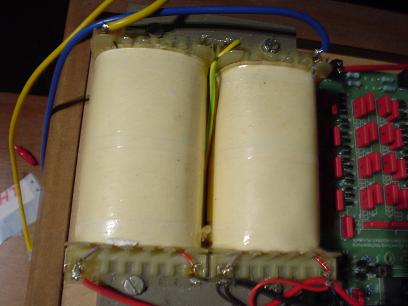

I want to change the ratio of my esl-transformers from 1:150 to 1:75,
but i'm not sure how to do. The red and black wires are the primary side,
the blue cable is +, the yellow - of the secondary.
Whats irritating me is the yellow cable in the middle of the secondary side.
Can someone tell me what i have to do?

Hi, I doubt that you can change the ratio of this transformer.
It seems to be 2 X 1:75 transformers "doubled" with the yellow wire as the center tap where the polarizing voltage ground/negative is attached.
If you want to reduce it to half ratio you will have to remove halve of the secondary windings on both coils.
or is there 3 wires on the secondary of both coils? your picture does not show the secondary very well

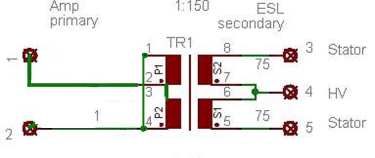

the Transformer is in parralel on primary and secondary side.
This is the sheme, black points are soldering points, some are cold ones :))

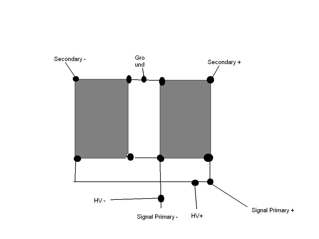

Calvin, as far i unterstood i have to connect the -pole of signal and the -pole of hv to the left side of the left primary and cut the wire going from the right side of right primary to the left side of left primary. Is that ok?

primary side is the low-voltage amplifier side, secondary the HV-ESL side. Your diagram looks faulty.
This is a correct schematic.
