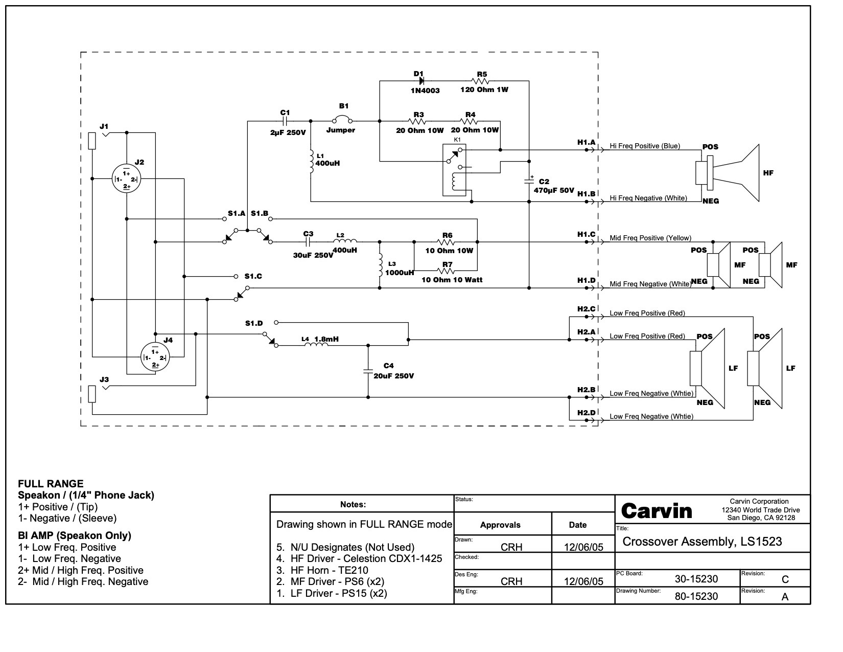

These cabinets are not really home stereo units, but instead semi industrial performance speakers from the now defunct "CARVIN" company! They sport two Eminence (I suspect) 15" woofer, two 4.5"- 5" mid range cones and a small 1 inch driver horn. Depending on the year, the horn driver could be Eminence, Celestion, or ????? That are set up to be able to used as a full range three-way box, or bi-amped with the two 15s for lows and the mid cones/horn for highs. While they actually sound pretty nice, the highest frequencies (8k-12K range) tend to be a bit over exaggerated, no matter which driver I try. I suspect something in the crossover network? I do believe their may be a crossover schematic still available and I'd love to share it and peruse it with you folks, if I can find it!

This is a complex schematic. I have some concerns around the way C4 is drawn in, but that's not important right now.
If I were in your position I'd pull B1 and jump a resistor across there. Some value of between a few ohms to maybe 10 or so. See if this hits the region you're concerned about since knowing this will be a way forward.
(Alternately, pulling the relay might tell you the same thing.)
Can I assume that the relay you speak of is the box with K1 above it? And if that is the case, what actually activates/triggers that relay and what is actually accomplished by the act of it being triggered on and/or off? My untrained supposition is that it toggles a major portion of the high pass filter network on and off, along with the protection that said network may provide!

Yes that's right. Normally the resistors are bypassed until there is too much signal.Can I assume that the relay you speak of is the box with K1 above it? And if that is the case, what actually activates/triggers that relay and what is actually accomplished by the act of it being triggered on and/or off? My untrained supposition is that it toggles a major portion of the high pass filter network on and off, along with the protection that said network may provide!
While the resistance there is probably too much to use regularly, putting a little resistance permanently in series with the tweeter may help.
From another model in the same line:what is actually accomplished
https://carvinaudio.com/pages/archive-ls1503-800w-15-inch-3-way-main-speaker
"Carvin's exclusive Speaker Guard™ HF Driver protection uses a self resetting relay circuit to dim the HF driver 10 dB protecting the voice coil from excessive power. The benefits are the driver is not turned off losing all the high frequencies, the circuit resets as soon as the high frequency content is back to normal levels."
