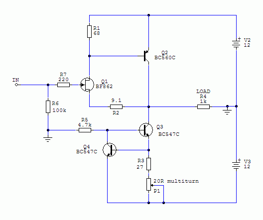

I'm looking for a line-level buffer stage to precede a volume pot. The criteria are that it a) needs to run from the PA main rails; b) capable of driving a 1k pot; b) reasonably high input impedance; c) DC coupled input and output, with very low offset to minimise any DC across the pot track ends.
I've come up with the circuit below, which is reasonably simple and meets my requirements. Any suggestions before I commit to layout and assembly?

the circuit isn´t as simple as it looks ... it requires three current sources.
If its just for buffering purposes why not stick to the diamond structure?
There´s no need to build a differential gain stage, forced down to a gain of 0dB.
Also You can get the supply down to more reasonable values with simple capacitance multiplier stages with their Vout set by base resistor dividers ... with the advantage of clean supply rails for the buffer.
In that case You could use integrated buffers again, like LME49600 or BUF634.

Hi Calvin
I had considered a diamond buffer; it certainly has the benefit of simplicity; however, good measured performance depends on close matching between the PNP and NPN devices, which is difficult in practice and hence a reason why I favour single-ended topologies. The other reason is that I find they usually sound better too.
The cap multiplier is a great suggestion and I'll have a look into those buffer ICs also.

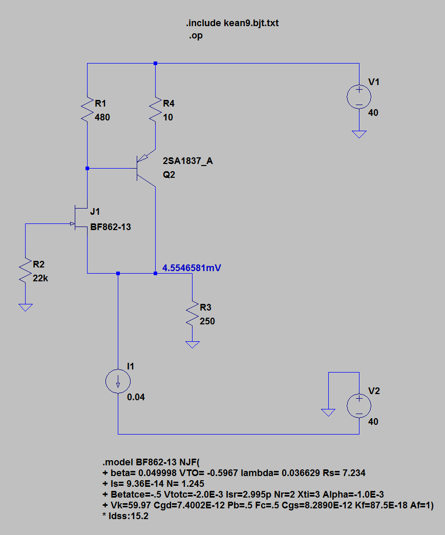

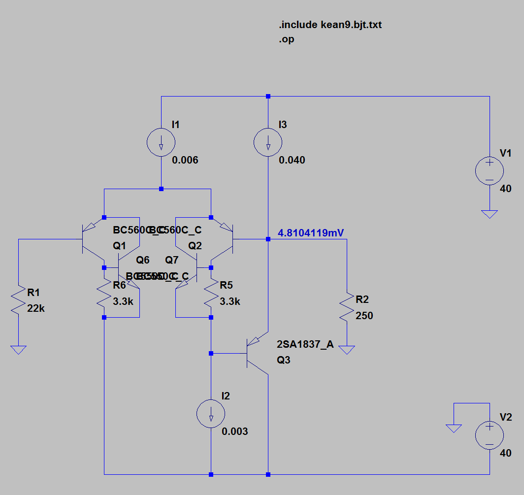

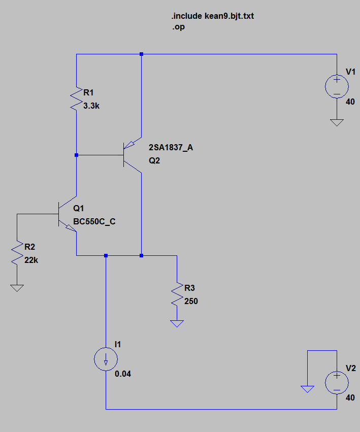

Hi Hugh
My first thought was a simple SE CFP using a pair of BJT devices, resistor loaded. The issue here is that with the input grounded, the output is at about 1VBE, which is a lot to put across the pot track - scratchy noise when rotating and all that. The obvious solution is a 220uF lytic at the output; however, its bulky and my friend insists that he can hear these in the signal path. A better alternative might be to AC couple the input with a small film cap and bias the input so the output is nulled.
NB: the model shows 40V rails, which are actually 55V PA rails regulated down to a reduced voltage.

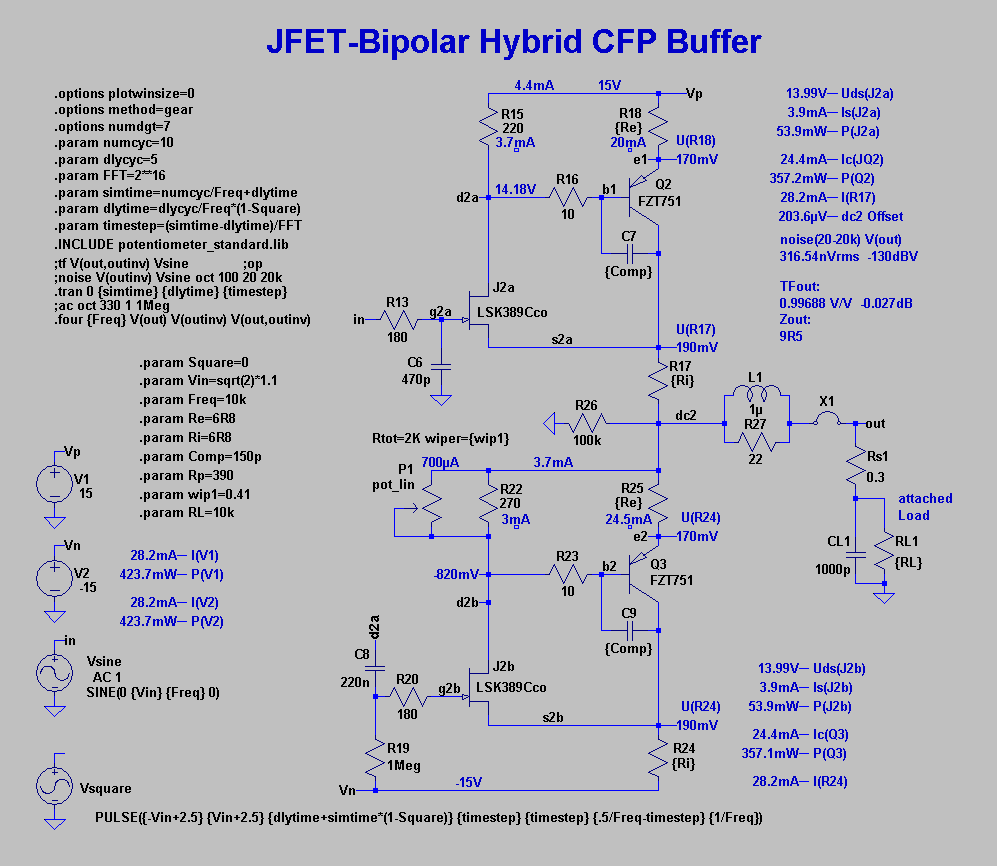

You can omit with the offset problem when using a JFET-bipolar Hybrid-CFP buffer.
See examples on my website which use easy to source N-channel JFETs only.
You can simplify the Calvin buffer by omitting with the cascoding JFETs (only 4 transistors) and the parts which modulate the ´lower´ ccs at the cost of increased THD at ower load impedances.
It´s also easy to null out the output offset.
You need of course reduce the supply rails to sufficiently lower values (2 more transistors).

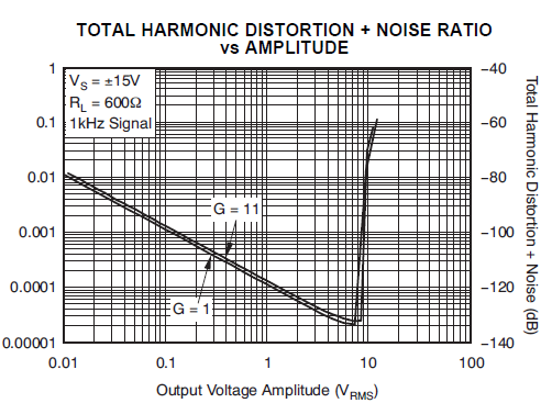

jcx, you make a fair point in relation to op amps for audio use. The way I see it the high voltage PA rails needs to be dropped as heat somewhere, and from that perspective it makes little difference whether hot regs are feeding cold op amps vs. cool regs feeding a hot discrete line buffer.
But a single, ordinary op amp section isn't going to be able to drive ~2Vrms into a 1k pot, so the solution is probably going to involve a discrete voltage follower inside the op amp's feedback loop, or several op amp sections in parallel. I built a buffer from four paralleled NE5532 sections configured as unity gain buffers driving a 1k pot and it worked extremely well, eliminating a faint hiss that was audible with my ear pressed to the tweeters. I accept that this low impedance design a la Self was in all likelihood incidental to other factors, namely improved power, ground and signal routing; nonetheless, I'm interested in pursuing this further.
But your suggested high voltage LT part has me scratching my head. Of the four suppliers that I use (RS, Farnell, Digikey & Mouser) only Digikey stock it, for the princely sum of A$10 ea. and only in a couple of decidedly non-DIY friendly packages - SOIC and TSSOP. I'm certain I could build something from discrete components at less cost and with less fiddling around.

I played around with the stripped down model attached and it does look quite promising. The only fly in the ointment is that the output offset is determined by R1, which will need to be calibrated due to variations in different fet parameters. I really hate trimmers and given the choice, I'd much rather a Big Cap at the output, in which case I might as well use a couple of BJTs to build the CFP.
I know I could get around the trimmer with a servo, but that's a lot of extra unwanted complexity, not to mention the fact that an op amp doing servo duty could just as easily serve as the actual buffer, to jcx's point, and do away with all the other mess.

Yes that's right, forr. I don't claim any originality and the basic circuit is probably an old one that Self described in his book. I think you might be right about Q2 and I noticed this to when I ran the simulation, which is one of the reasons why I posted here looking for confirmation. The situation improves when the resistors around the CFP inputs are reduced but this has the unfortunate consequence of increasing the output offset.
I did play around with a very similar circuit to the one you've posted but with a 2T current mirror. I thought the results were a little disappointing. I'll play around your circuit that has the more accurate mirror and heavy degen resistors and see where that leads.
The obvious question that really needs to be answered: how much offset is acceptable before the effects become audible when the pot is moved?

recent candidates I would consider: OPA827, OPA1642 distortion vs load plots:

Back to the task at hand
I've done more analysis on the circuit at post #1 and don't believe it is really viable for the reason forr mentioned.
If we allow ourselves a big coupling cap at the output then almost anything is possible, but if we want to eliminate it, then the SE CFP buffers (2BJT or JFET/BJT hybrid) are only viable if the input is offset to null the output. This means either a trimmer or a servo and I'm not in favour of either option for reasons already stated.
The diamond buffer is probably the simplest discrete solution that has half a chance of working, but I suspect that success will require super matched NPN/PNP parts. If anybody has experience to offer on how to build one of these from hand matched or readily available monolithic packages I'm all ears.
The only other viable discrete option I can see at this point would be a conventional three stage amplifier with a tightly matched input stage (either JFET LTP or CFP BJT LTP), accurate CM, VAS, current buffer. That's a lot of parts and that OPA1641 starts to make an awful lot of sense.
If there's nothing further on the Diamond, and barring any other breakthroughs, I'll order up some of TI's finest and break out my jewellers loupe.
jcx, I hope you don't mind if I impose on your good nature (!! ) and get you to take a quick look at my reg design and pcb routing when the time comes. I'm used to playing with more pedestrian opamps from the 70s and I'm worried these newer types oscillate until there's nothing left except a small black crater on my board. I promise to read the datasheet and application notes first. TIA.
Thanks everyone.
Thanks everyone.
... My first thought was a simple SE CFP using a pair of BJT devices...
Using a JFET instead of a BJT at the input raises Zin and gets you rid of DC offset at the input and the output. BF862 is current production, high gm, low noise JFET. The buffer in attachment will effortlessly drive 2V RMS into 1k pot.
R2 will depend on your JFET's Idss and can be in range from 4R7 to 10R (right value will set your output DC offset at few mV and with P1 you can trim it down to zero).
CCS BJT will dissipate about 200mW so if you feel uncomfortable with it, use higher power device (BD139 or similar). Power consumption is about 20mA per rail, per channel.
Power rail voltage can be lowered by using a RC cells followed by 7x12 regs (or any other 10-12V regs of your choice).
