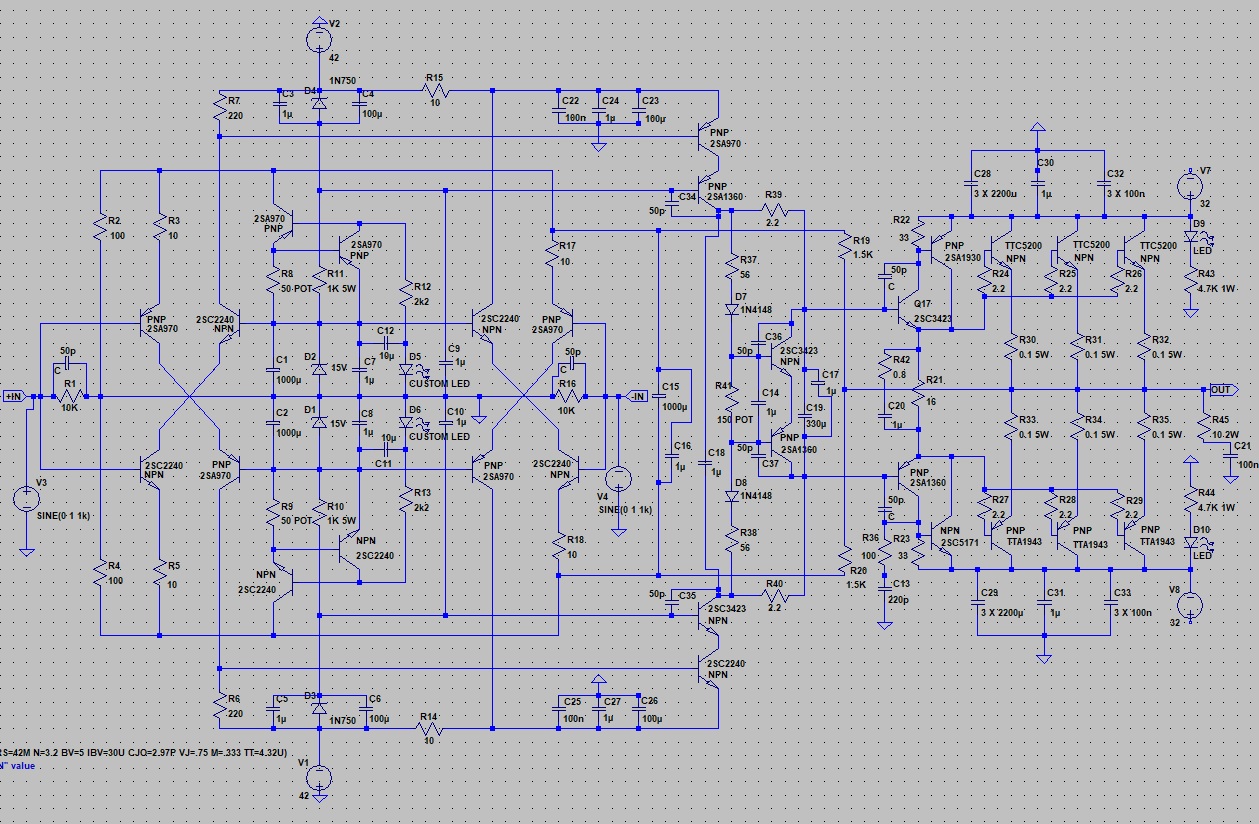

When I raise the bias current of output transistors or bias input transistors more than 3mA oscillation occurs.

Balanced or not, there are many ways to mess up your wiring
What frequency are the oscillations, roughly speaking ?
>> 1MHz - usually points to an unstable power output device (esp. FETs by the way)
few 100's kHz - usually points to a wiring issue, often the ground is contaminated with current from the speaker return or similar and it gets into the signal ground.
few 100's kHz to a few MHz - usually points to unstable feedback loop, mostly inadequate compenstion or poor layout

Thanks for your reply!
I don't know the oscillation frequency, but definitely it could be there. I will buy the scope in a month and will measure it.
OPS bias problem is oscillations related as well?
Speaker wires (GND return) is half meter long only. Could it be contaminated than?
The amp is all BJTs made.

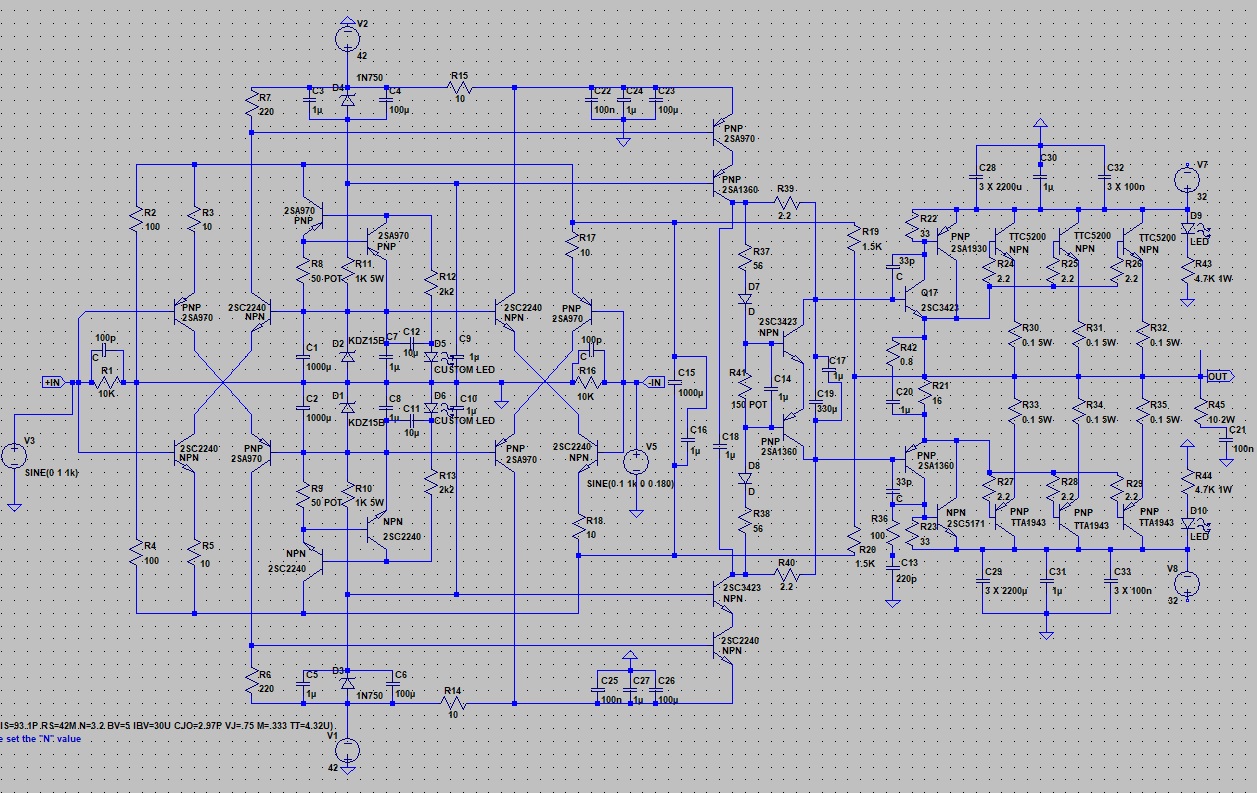

Could you please advise me how to do a proper LTspice simulation, where can i get the parts models?

For LTspice you should start with the simplest version of this topology, ideal voltage supplies, ideal current sources etc. with the goal to ensure you can get the basic circuit working in the simulator and can see how and why it works. Then work outwards in terms of complexity, replacing ideal parts with better models etc. I have spent countless hours with LTSpice, looking carefully at how things behave to understand how my circuits are operating and how the choice of currents and things are to be optimized.
There are device models on the forum published in various threads and there are models on some websites. I've collected them over the years, some of my favourite are from andyc, an old forum member, some from Ranchu32 who's still active and there are some on Bob Cordells website.

AndriyOL, You simply changed input to differential pairs, but feedback from output remains to input transistor emitor, as with single ended input..But here are two transistors now, and feedback is so undefined, for added transistors it is positive feedback... It must go to -In, not to differental pair emitors. Try it in simulation first.
This is Lazy Cat balanced input design. it was published 6 years ago. As I have been told this is Lender's circuit the way the negative input is connected. Simple Symetrical Amplifier
Could you please show in the schematic what you are offering?

So, it's not possible to collect all parts models for me I guess.
Could you please ask LC to share the simulation files with you? He might have them.
Of course I would send the models to you if I had them but I didn’t use these parts, I tend to stick with what I have.
I don’t know Lazy Cat personally, you can try messaging him yourself.

Exists properly working real amp with such input topology?
If you have asc , please post it here.
I think LC should have test it to work properly. I don't have asc
