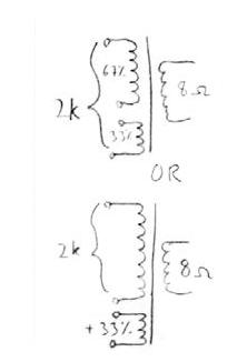

After some successful experiments with PL504 SE and CFB I feel that it´s time to take it one step further and use real triodes instead of TV tubes.
I´m thinking 6AS7, one system per channel running at 150V, 80mA and 2k with about 33% CFB.
(I´m well aware of the driver stage problems but that does not belong here)
The question is: If I want 2k plate load and 33% CFB, should I wind an 2k OPT and "cut" the winding at 33%, using 2/3 on the plate and 1/3 on the cathode or should I wind a 2k winding plus an extra cathode winding that is 33% of the primary?

> If I want 2k plate load and 33% CFB, should I wind an 2k OPT and "cut" the winding at 33%, using 2/3 on the plate and 1/3 on the cathode...
I think I might call that 50% CFB; not sure; splitting hairs here. However, the cathode sure provides some output power. The total P+K winding should be like you would use for simple plate-loading, then break-off a part of that for the cathode's use.
That gives a 3.5K load on the tube. If you think 2K is best, then this is wrong. Probably does not make a bit of real difference, since triode loading is so uncritical. Either 2K or 3.5K plot about as well as you can do with that tube working at just 150V.
If you have enough drive voltage, you might try it both ways: big winding in plate as proposed, and big winding in cathode with the small winding in the plate. The latter gets close to cathode-follower operation without going all the way, and not needing such brutal drive voltages.
Thanks, that what I wanted to know!
Gotta take a look in my tube inventory to see if I can find a more suitable piece for this job.

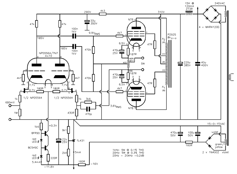

The other problem is maintaining stability once CFB has been applied. Despite that, CFB can work very well. This particular amplifier measured well and sounded great. But I built and tested twenty different circuits before I arrived at this one...
