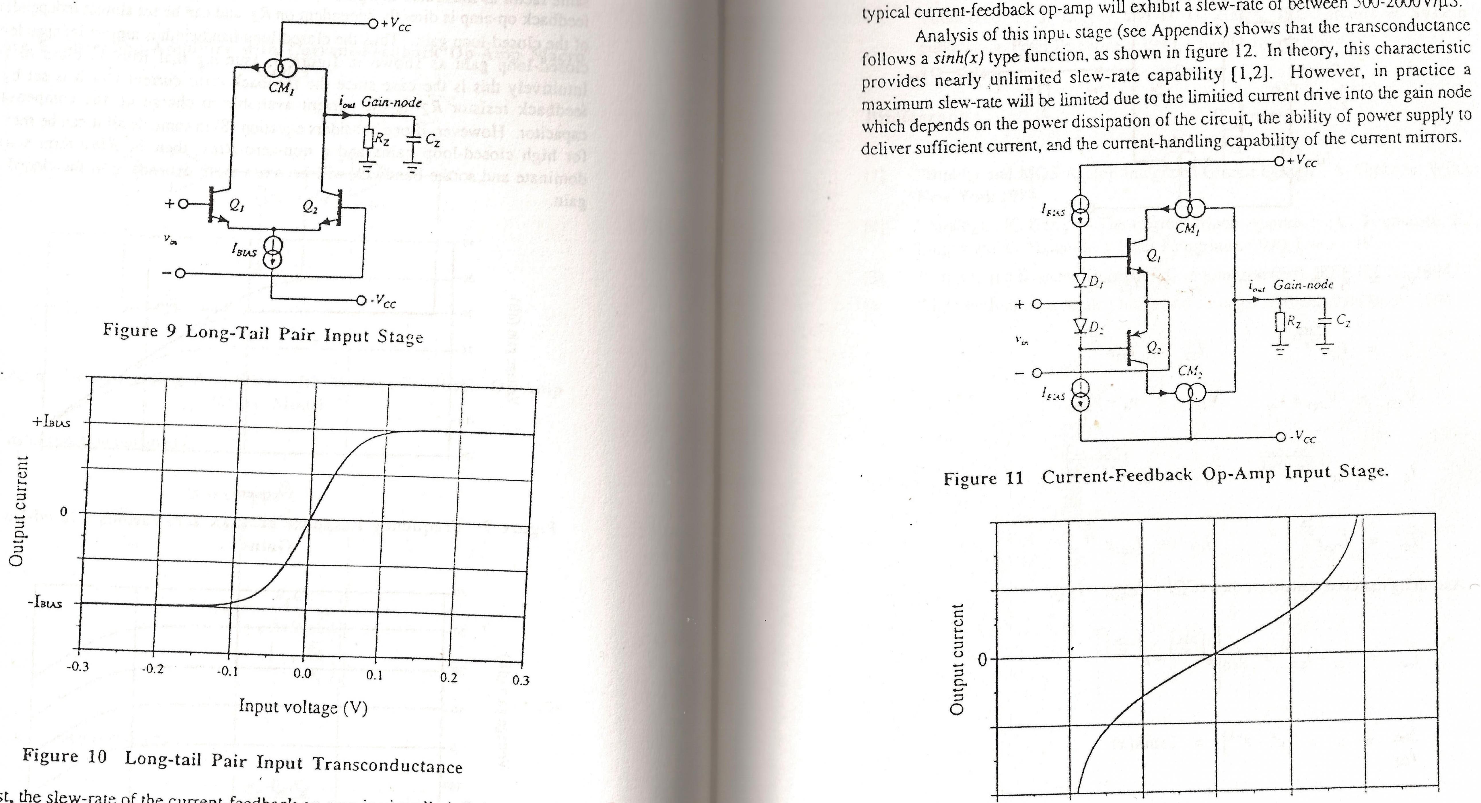

For the cfa there is (approximately) a fixed voltage across the two bases. Ignoring the error current flowing into the feedback network, as the input changes the feedback node (the negative input, where the degeneration resistors are common) will also change. Since there is a constant voltage across the bases the amount of b-e change (in opposite directions) is the same for each transistor. It is the non-linear difference between these b-e voltages than constitutes distortion.
Now if you think of these voltages superimposed on the exponential i-v curve of each transistor you will see, equal and opposite voltage movements from the bias point, the resulting changes in collector currents for each are significantly different (and non-linear). It is this current difference which flows through the high impedance gain node, supplies feedback and determination of the error or delta Vb-e (approximately equal but opposite directions for each transistor).
In contrast for an ltp, there is no voltage constraint across the bases, but rather a constraint that the sum of collector (emitter) currents remain constant.
Conversely as the input voltage changes the collector currents will change (equal and opposite amounts). If this is viewed from the same inherent exponential i-v curve there is a symmetrical linear delta on the current axis (analogous to the cfa voltage axis) resulting in two non-linear and different base emitter voltages. The difference in these two base emitter voltages is basically the distortion at the feedback point.
The net is an ltp will show much more linear collector currents as a function of vin, with the corresponding exponential appearing as distortion across the base emitters, whereas the cfa will show very linear base emitter changes as a function of vin with the corresponding exponential appearing on the collector currents.
-Antonio

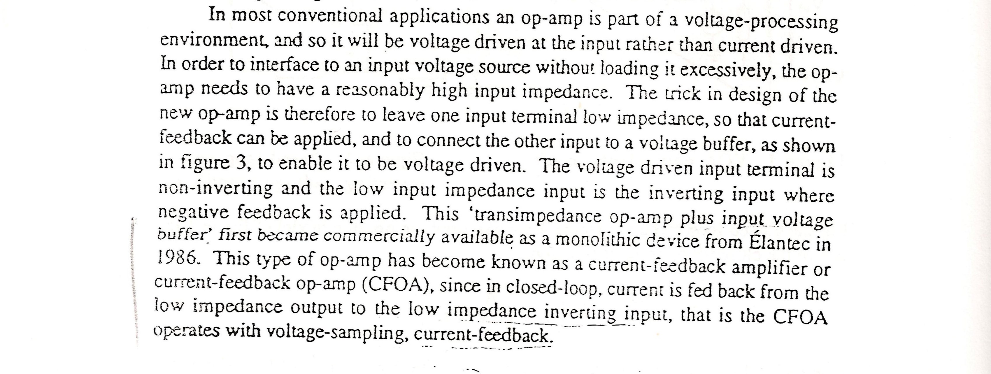

Hi Richard,
I think we need to be careful to distinguish current-mode analog signal processing from current feedback amplifiers. In a CFA the signal feedback can be considered a current, but that is all there need be in the current domain. Put another way, in a CFA the error amplifier reacts ideally to a difference (error) of currents, while in a VFA the error amplifier reacts to a difference (error) in voltages. The impedance that the feedback network sees at the error amplifier is largely what differentiates the two. The CFA feedback network sees a low impedance ideally, while the VFA feedback network sees a high impedance ideally.
It is important to realize that the voltage at the feedback node of a CFA is not necessarily zero; it is often equal to the input voltage to the amplifier, as in a non-inverting CFA. But you can also view the CFA feedback network as operating as a voltage divider that seeks to produce a voltage that is the same as the input voltage for a non-inverting CFA. If it does not produce the same open-circuit voltage, then an error current will flow. There can be many ways to look at this. Sort of like how given source and network has Thevenin and Norton equivalents. In fact, I seem to recall CFAs as being described as Norton amplifiers. I could be wrong about that, however.
I think that the classic RIAA preamp, wherein the RIAA feedback network connects to the emitter of the input transistor, is in fact a CFA.
I hope that my assertion that the CFA can be viewed in more than one way has not confused matters.
A better example of current-mode analog signal processing is the cascomp input stage, where the signal current from an input LTP is summed with an error correction current at the emitters of a cascode.
Bob
