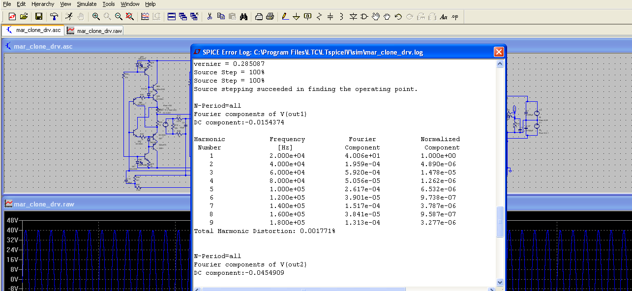

I did some simulation based on Marantz SM11-PM11 topology, but with some modification...
Sajti
What were your modifications?
Thx-RNmarsh
Thx-RNmarsh
DC coupling from input to output, like SM11S1, but with unbalanced input. I use Onsemi input and output devices.
The shown distortion is simulated at 100W/8ohm output power.
Sajti

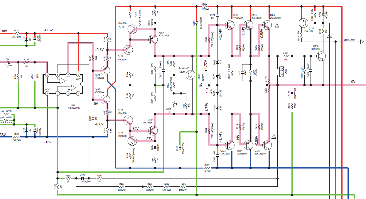

I noticed all the Reference Series line from Marantz are all CFA topology.
I ordered a MM7025 to use and test and play with. Will measure and show schematic, if possible, and listening impressions.
-Thx-RNMarsh
I'm not familiar in MM7025, and I didn't find the shematic of it. However I keep searching...
Sajti
-Thx-RNMarsh
Although CFAs were already in use by Marantz, by 2006 all their equipment featured CFAs including analog stages in their digital equipment.
The same has happened with NAD with the exception of the multi channel AV recievers.
You will not find nothing fancy inside this MM7025.
This is the very simple version of the Marantz CFA. It was derived from the multichannel home movie amplifiers...
Sajti
