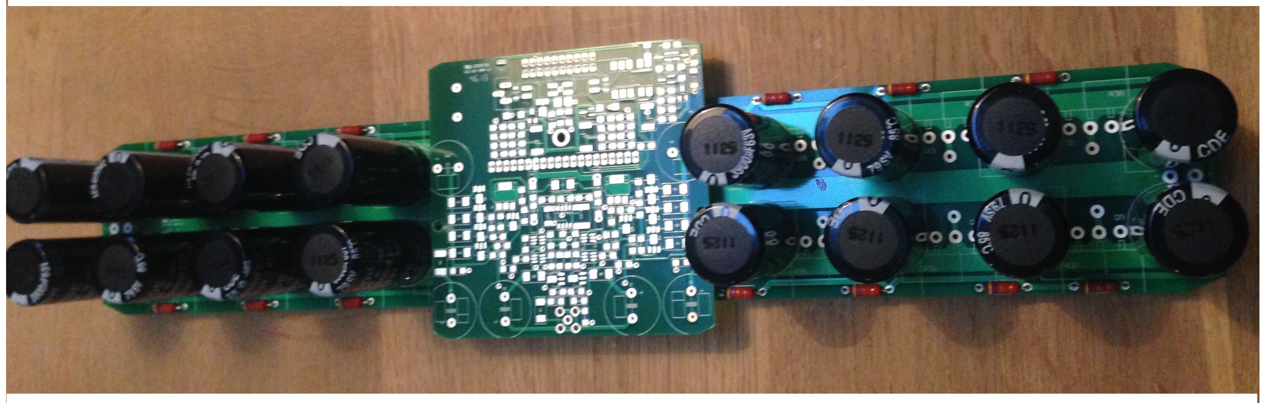

Here's the current state of things. OPS with main distributed supply and an add on smd/PCB with Frontend, Housekeeping, SOA protection, temperature sensing, offset sensing and a Cap/mult for extra + 8V supply.
The frontend has options for different compensations. I dont' know exactly what knowledge I will gain or if it will lead in the right direction.

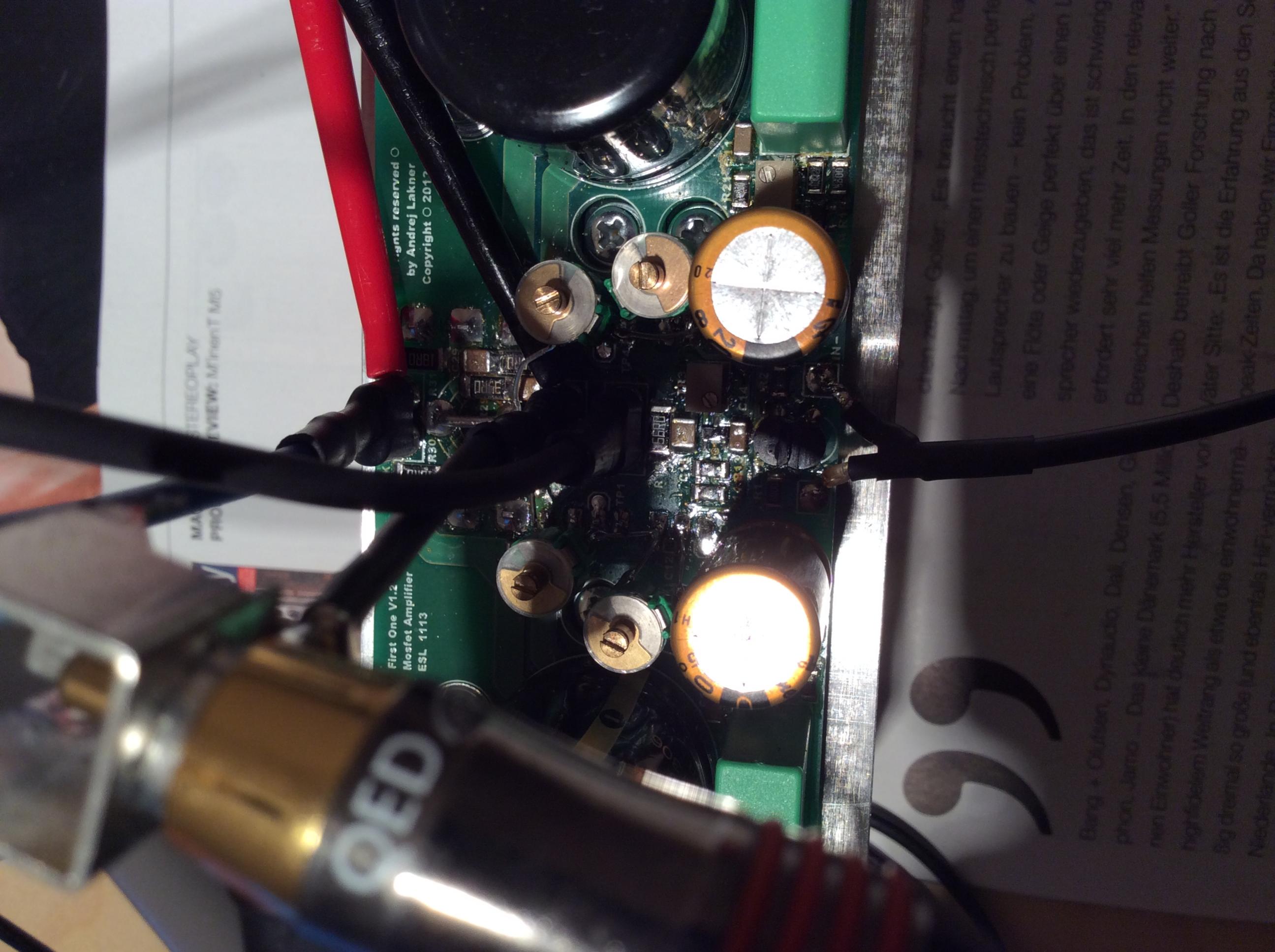

For the last two weeks have been intensively playing with Miller plus Cherry compensations on a real CFA amp, more here.
Pure Cherry only, the amp stability is on the edge, THD10 around 60 ppm at 100W/4R
Miller only, makes amp stable but elevate THD10 to 90 ppm
Both compensations in their sweet-spot, set by trimmer caps, resulting in 30 ppm. Also 3 MHz sine signal spectrum has lowest THD at this point. Replaced with fixed values caps the end result is now around 40 ppm. So Miller plus Cherry combined works best in my CFA, interestingly all four caps values are very low and very close to each other.
Else what I noticed at live 100W/4R/10kHz test is that moving high current PSU wires around the amp can change THD levels significantly, it can go from 40 ppm to 80 ppm just if they're not positioned correctly.
Hi LC,
You are moving the electromagnetic field(s) when cables are moved.
It looks like big distance between the big caps. I believe that placing the big caps and power leads together (incl. PCB terminals) would further reduce distortion.
