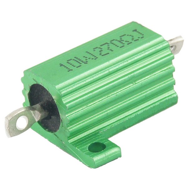

A couple of large resistors(below) "outboard" (with the cap). Lo-Z in CF
would allow this - unlike a VFA.
PS - we don't have to be cheap , like Pioneer.
OS
Wirewound and long wires at MHz ? hum...A couple of large resistors(below)
Wirewound ? hum...
Or ... (like bob suggested - below)
Non- inductive 50 watter !
OS
Lo-Z , shield them if you like.

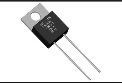

With those to-220 resistors, all can stay firmly planted on the pcb.

But, is there any thing really wrong with a single 3 w unit (thick film) ?
mouser has them for $.50 -.80 .... http://www.irctt.com/file.aspx?product_id=36&file_type=datasheet
I have option for a 3W or the to-220 already done.
OS
OS

I like the parallel resistors idea best too.
