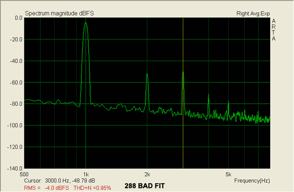

Measurements.
OK, some measurements and graphs.
The first is an FFT of a 1KHz tone after all screws are tight. Fundamental is at -6.5dB. You can see that H3 is slightly higher than H2. Without all the screws tight, H3 is 6-8dB below H2. (Unfortunately I don't have a shot of that - will redo).
I want the lowest distortion possible, but also want the harmonics to drop off at about 6dB each, relative to the next lower order harmonic. That way they are masked and can't be heard. Definitely don't won't a rise in H3 or H5.

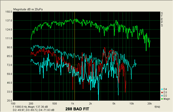

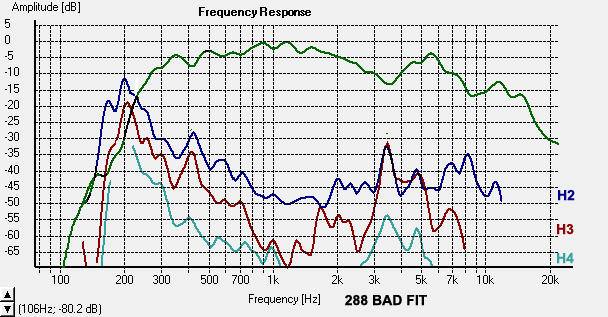

But here is the trouble. Using a stepped or swept sine, things don't look the same. HOLMImpulse and STEPS do NOT show a predominate H3 @ 1Khz. They both do show big trouble from 3-5KHz.

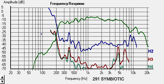

For reference, the last graph is the Altec symbiotic fram that came in the driver. Don't know if it's a factory install.

Not to Rub it in , but ;
Pano,
( for the archives )
- I expect a healthy 288 with a proper fitting diaphragm to measure something like this ( this is my best performing 288-8K on a small Emilar , radial-type horn ) ;
- Note the db spread between the various distortion products / which you've mentioned that you'd like to accomplish due to the inherent masking effects .
As opposed to this ( your bad fit ) ;
- I know these plots were obtained using different measuring conditions ( horns , levels, scales / even the type of distortions displayed ) but still, the general trend looks pretty clear ( IMO ) .

Earl - thanks. I quite agree. Your 288 looks a lot better. The only thing mine has going for it is better low end extension. But it's a bigger horn, so it would.
So I think I'll work on centering the fram with a 3KHz tone. Since that seems to be the big problem area, that's where I'll work. Wish me luck!
