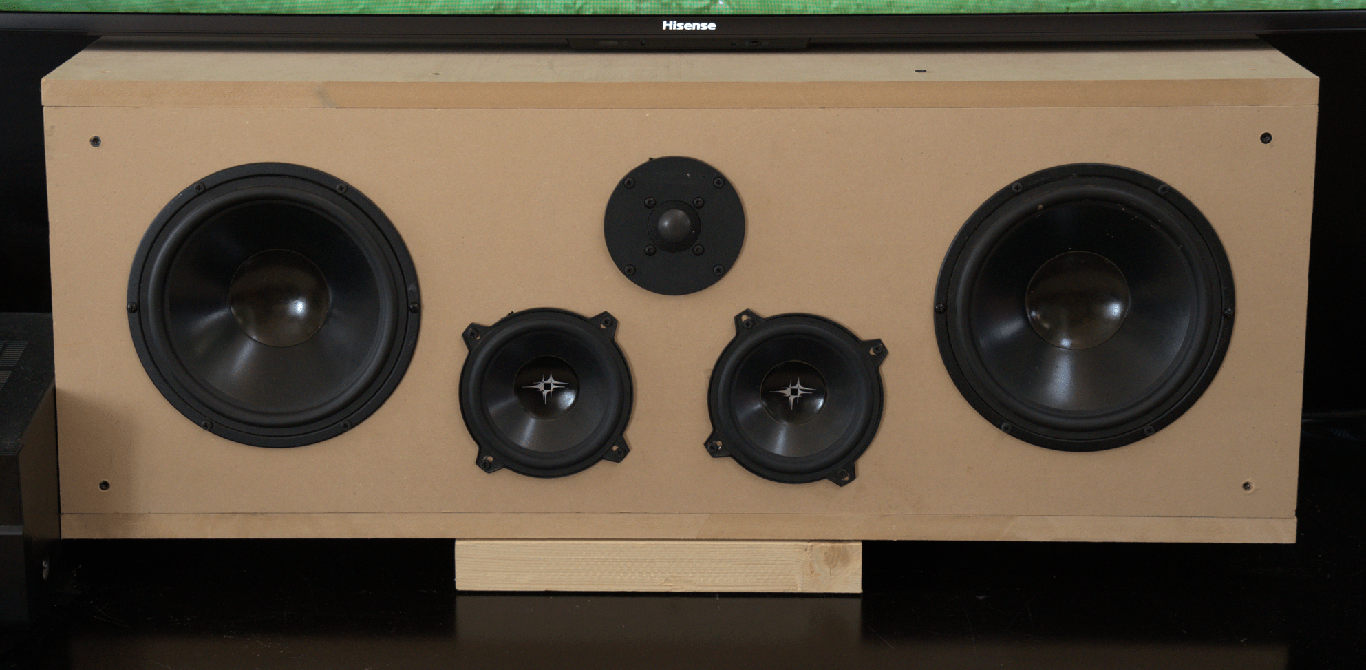

I'm going to attempt something like this using the drivers I have: two 8 inch 4ohm woofers wired in series, two 5 inch 4 ohm mids wired in series, and one 6ohm tweeter
The other option is to place the mids below the tweeter, but I can find the example that I saw.

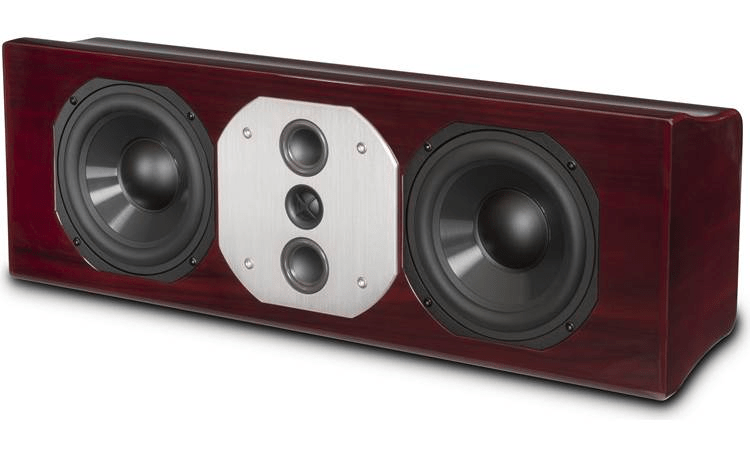

Best to use MTM if within ~1/4 WL of the XO point which puts its response overlapping on axis whereas the TMM requires some extra XO design effort to counteract its axis off center 'beam steering' unless using DSP.

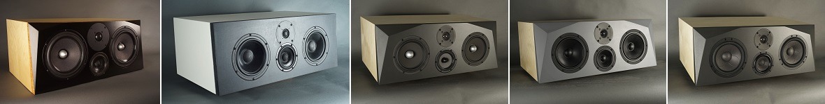

When I built my main speakers, I had an AVR and a projector, and building a center speaker was always pending. Thinking about building it in such a way as to make a good match, I went to the builder's page and according to him, the addition of a small (4") dedicated media speaker is necessary. All the models he built have it.
Finally something exploded in the projector - it wasn't the lamp - and I abandoned the HT. But maybe it would help the OP to read something from this link.
He says :
" This center speaker has been on the to-do list for a long time and started as a "classic" horizontal d'Appolito set-up. However, unless we cross over at a very low frequency between midbass drivers and tweeter, we may experience crossover lobing, that is uneven frequency response as we move from seat to seat in our home cinema. Usually we have an even horizontal dispersion from vertical aligned drivers if the chosen points of crossover have been done with respect to the diameters of the drivers and slopes of crossover. When wavelength hits a value equal to the diameter of the driver, we start having beaming (wellknown from fullrange drivers) and if the point of crossover is above this frequency we may have irregularities off-axis.
Most good center speakers are - at least - 3-way. Some manufacturers go even further and use a whole range of tweeters to overcome the problem - like McIntosh."

I completed the first version yesterday. This was also the first time I worked with MDF (I scored some discount MDF at a local hardware store), its much easier to sand than plywood, easier to drill holes, and very very dusty.
The imaging is much better than the Polk and voices are easier to hear. Surprisingly, it doesn't require that much more volume to reach listening levels. I thought that my amp wouldn't be able to handle it. The bass is okay, so porting it is still a possibility. Someday I will buy the right equipment to measure it, I have a microphone, but it's not designed for speaker measurement.
Overall this center adds a lot more to the listening experience and I'm pleasantly surprised how good it sounds. Thank to all those that helped.

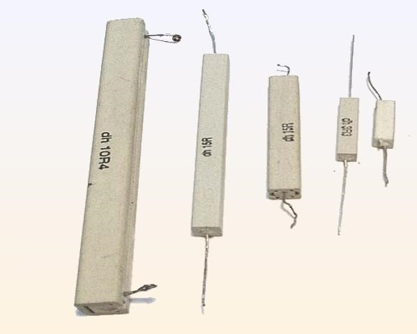

https://soundcertified.com/how-to-add-resistor-to-speaker-to-change-match-impedance/
PS: Keep in mind that a resistor in series with the (+) or (-) terminal of the speaker - it is indistinct, as a rule I do it in the (+) - it will raise the impedance that the amplifier sees, and on the contrary, the other way around. , in parallel, will lower it. You have some very nice graphics here.

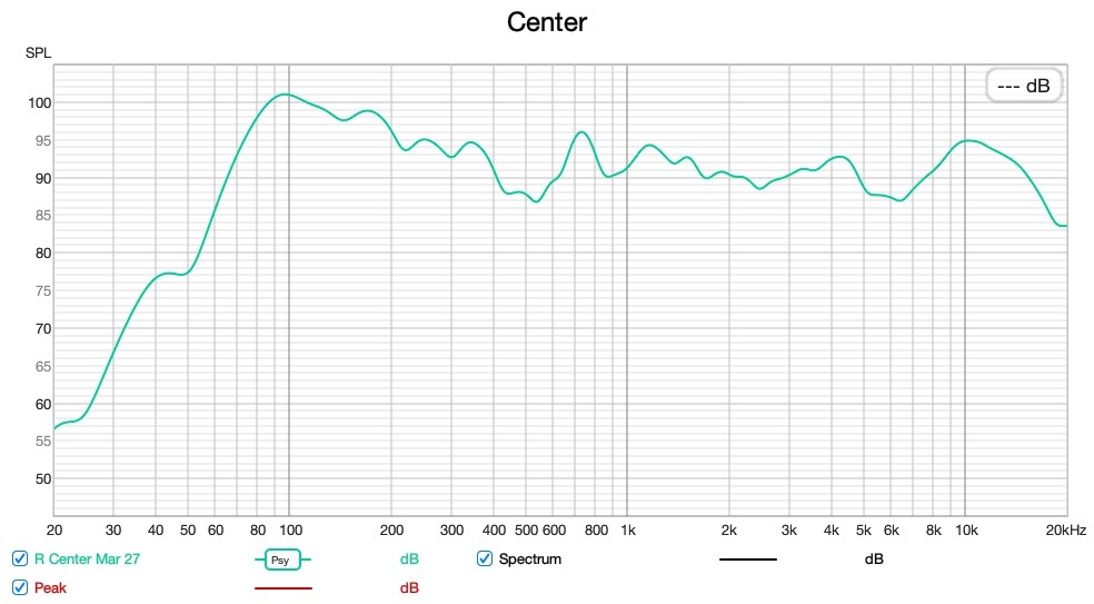

Here's a graph from REW. ** Important Note** This is from an uncalibrated soundcard and mic. The mic is a standard usb mic. So I'm not really sure you can make any conclusions with it. Eventually I will get the right equipment. Also I had know idea what volume to set the amp and computer output at when conducting the measurement. I think the AVR was around -14db.
