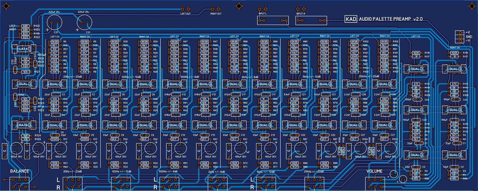

Assuming that the PCB that I receive this week works, I would have no problem making the gerbers or even fabbed PCBs available to anyone that wants them.

Unfortunately a stereo version contains lots of opamps. You would want to use quiet ones such as the LM4562. I have a stereo version using all thru hole parts in the works. The PCB is out for fab now. The PCB for both channels fits into a 1U chassis.

I wonder if four channel opamps might make it simpler? What is your opinion of components on both outer layers of an FR4, with a dedicated ground layer?
"I wonder if four channel opamps might make it simpler?"
If we were to use quad packaged opamps our choices of opamps quickly diminishes. Builders usually have a favorite dual that they can pop in.
"What is your opinion of components on both outer layers of an FR4, with a dedicated ground layer?"
That would be a more expensive board for sure. And what's worse is that we would have to go all surface mount parts. Surface mount takes the fun out it for me. I prefer good'ol thru hole parts.
Two channel EQ similar to the classic Cello
The PCBs are back from fab. Altho this is not a PIC of a PCB, this view affords more detail.
The PCB looks exactly like this. Lots of resistors!
Are enough people interested in this for me to document it?
If 'yes', do I put those details in this thread or start a new one??

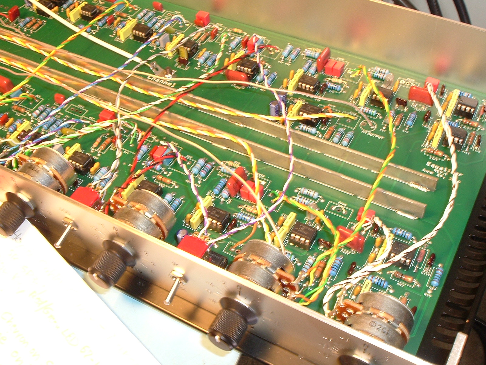

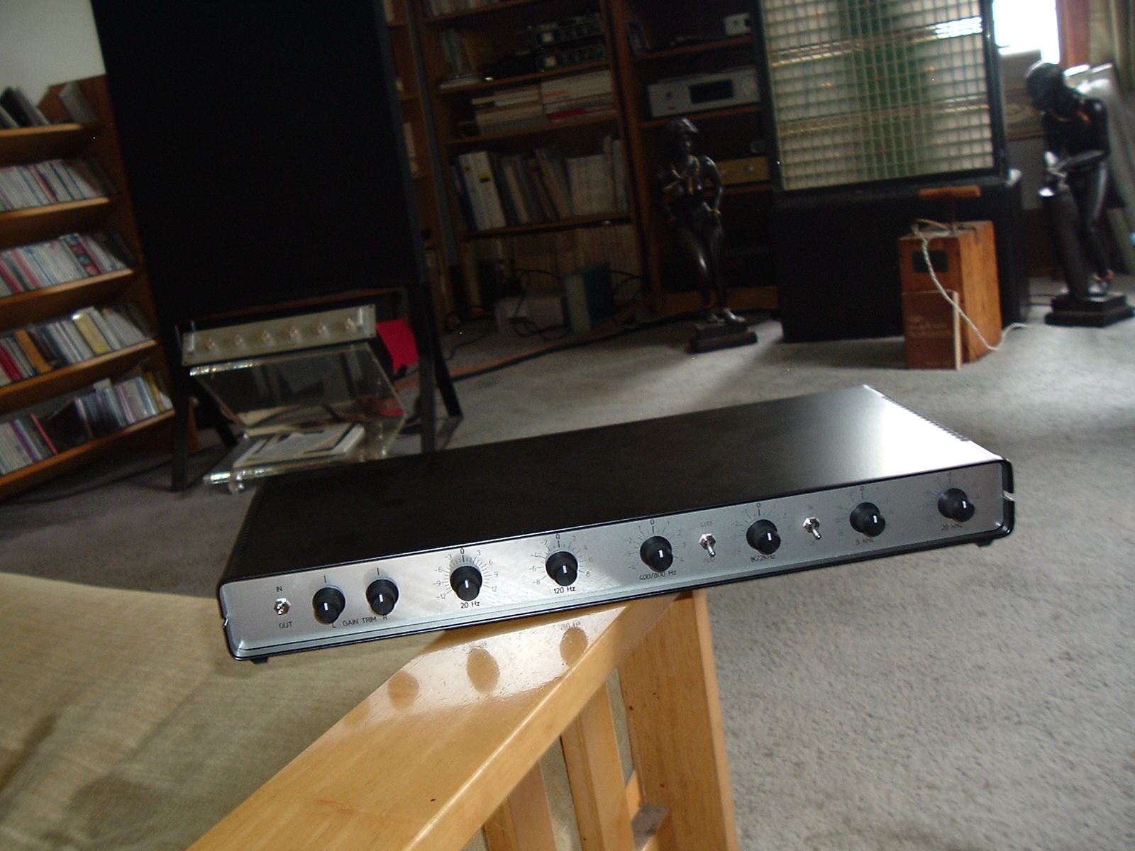

My version
Two pics of my Palette Preamplifier version.
Used the original schematic but only built-up the equalizer portion (no additonal amplification, balanced I or O) in a separate (remote) box with a 20ft interconnecting umbilical cable.
The other end of the cable is "Integrated" into my version of the Cello Encore preamp (it's actually a line stage). In addition to the 6 frequency controls on the remote (plus switches on two of the pots to vary the "base" frequency slightly), I added two (Left / Right) gain trim pots (+/- 3db or so) and an "in/out" switch so I can instantly compare the "equalized" to "un-equalized" signals - from the listening position.

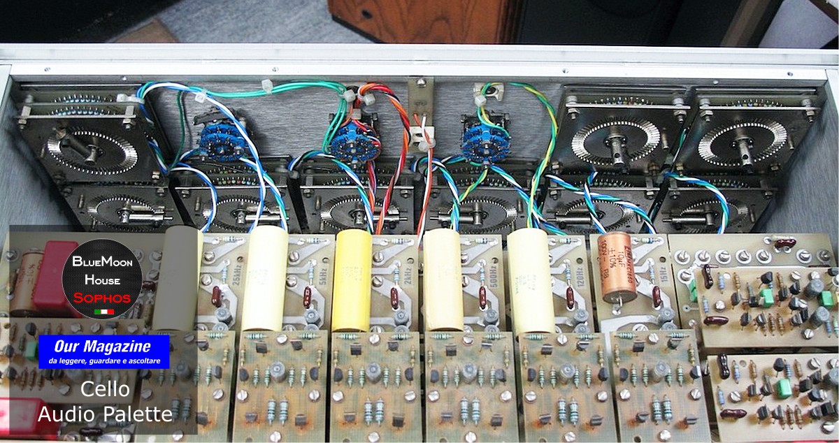

Also attached a block diagram of the original Palette - drawn by Paul Jayson in 1985. I marked it up to show some missing items and some totals for the amplifier modules.
There never was a technical/service manual for the Palette. Any product drawings Cello made/used were intended for MANUFACTURING purposes. Never worried about "aftermarket repair". This was not unsual; found that the same was true for at least Levinson and Krell.
For all of their products there were schematics/parts placement for the individual PC boards, but any interconnections between boards/modules/etc were described by "from/to" wiring lists - in addition to any necessary drawings showing where any parts/devices/PC boards placement, like on the front, bottom and rear panels.

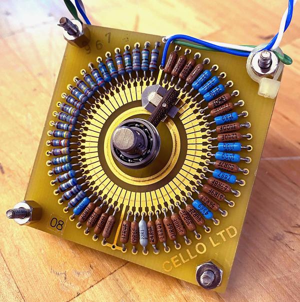

The original Palette had Levinson's "signature" 52? position, single pole devices. The mechanics of which were used in a number of his products including volume and balance controls. The base plate had "stops" on it to determine the actual number of positions for a particular application.
As has been mentioned, Colangelo took Burwens original Op Amp based design and implemented it with discrete components. The Palette Preamp used Op Amps (627's with 633 buffers) and used potentiometers without a center detent. I had a few of these boards, populated and unpopulated. The Sefernic(sp?) potentometers on the populated boards seemed to get noisy over time.
My first look inside the original Palette at a Mcintosh / Levinson dealer (late 1980's, in Hartford CT) left me totally astonished!!

And it seems my recollection was flawed, there actually appear to be switched attenuators as potmeters.
