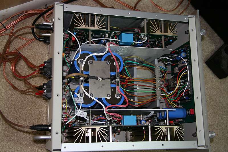

With double-plated boards throughout, having to remove two massive internal heathsinks with 6 power trans on each in order to look at the PCB traces, four main boards and at least two smaller ones, some caps without markings which would have to be unsoldered and measured to derive the values... I don't think so. I think there is enough reason here as to why nobody has drawn the schematics for this one (schematics for the Quad 405 mkI and mkII used to be a dime a dozen even back in the 80s...)
The Duet has power-on delay relays which helps to minimize surges on the speaker's end. I use old (not very good) speakers for any kind of testing with the amp, as I know how much it costs to repair the B&Ws.
You are right on the issue of "not knowing what it does" - except that I knew that the pot on the main output board was supposed to be for bias adjustement, and was measuring the voltage drop and quiescent voltage throughout my testing. It is certainly not a very good idea to turn knobs blindly - but I was monitoring the voltages very carefully with three different meters strategically placed at the same time. The voltages never got beyond 100 mV.

Trying to isolate the problem, it appears to be with the main board. The other channel measured well, and I was able to adjust the bias to the original specs (thanks, Hannes) - quiescent voltage less than 2 mV. And that is with the VAS board I repaired.
I don't want to assume anything since I don't have the schematics - but the main boards look identical. Do any of you know if in these amps it would be safe to swap left main board with right main board for testing?

Chucks... The boards have the same numbers, everything is identical... except for one of the leads that connects to the input/output board. By reversing the boards, the lead is now on the other side, of course - and farther away from the i/o board, and so it doesn't quite reach. And it is soldered and clamped on, so it will be a pain to swap.
Need to go rummage around and see if I can find anything that might work as an extension lead... How frustrating...
Well, isn't life interesting...
The main board that refused to warm up or be adjusted properly lit up like a Christmas tree once it was on the other channel. Adjusted beautifully, both voltage and bias. Obviously it is not the culprit - all the output trans also tested well, and are all very well matched indeed.
Have traced the problem either to the EPB board (unlikely) or the i/o board (more likely). Next step will be transistor and cap testing on the i/o board.

With less than $3 worth of parts and another 1/2 hour on the work bench, the Duet appears to now be sounding like it should. Bias and standing voltage are behaving normally on both channels, both channels are giving off heath, and I can't remember when this unit sounded this good.
Obviously looks like the i/o problem developed at some stage earlier on, and it wasn't till the pops and crackles that I realized something else was wrong with the unit (I remember thinking something wasn't quite right with it a while back, but I haven't used the Duet in quite a while).

After playing with those boards for a while, I realized that my VAS boards were version 1 - whereas the last boards made were version 7 design (PCB version 3). Several parts on the version 1 boards are no longer available. Paul at Viola labs had a few of the latest boards left, so we bought two of them and they appear to be working very well after installation. Hopefully this will help give this old Duet a new lease of life.
